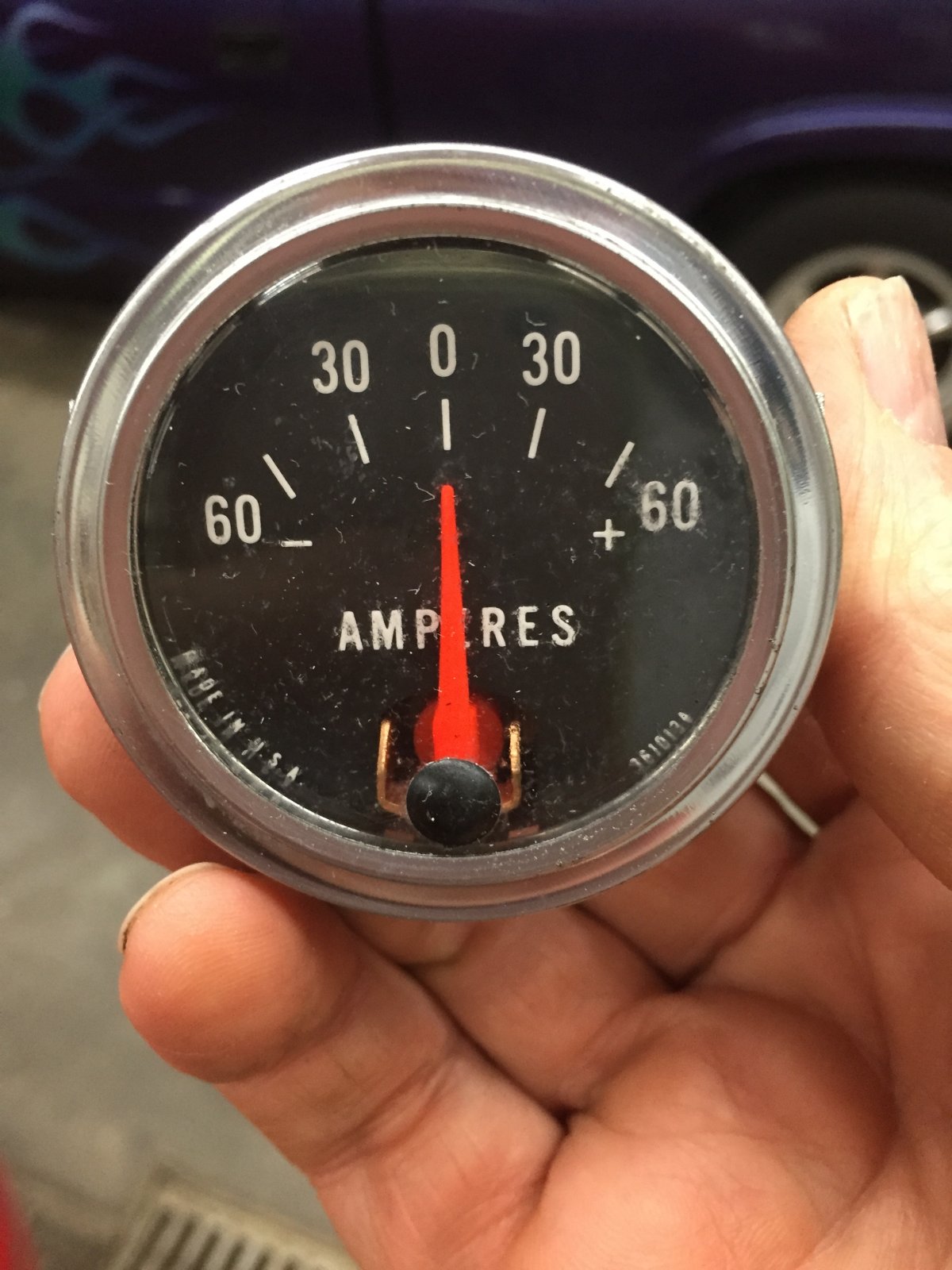

    Looks like it could be the same make. Don’t have anything currently running with points to try it out, although I’m sure there is other ways to test it. I grabbed it because it was unique, plus the Hollywood panel has a lot of gauges and I needed something else to fill one spot.

  12. A tach/dwell meter is the same instrument with different settings so seems like a small tach could be re-faced and set up for a dwell meter.
