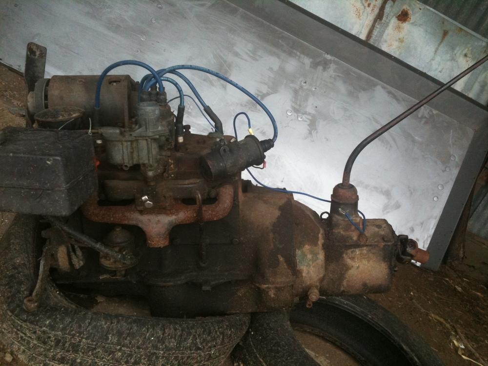

  20. I went strange as far as banger... 54 lotus/ford four cylinder... Looks cool
  21. ImageUploadedByTJJ1362234986.909304.jpg ImageUploadedByTJJ1362235025.071051.jpg ImageUploadedByTJJ1362235071.424388.jpg these are a few pictures of the motor and project early on.

    I like your thinking and before anyone says its not trad it is and the later twin cam versions even more so they were used in race cars but now parts are expensive and hard to get your hands on great little engines will look great all polished up in a light tee bet it will be fun too.
