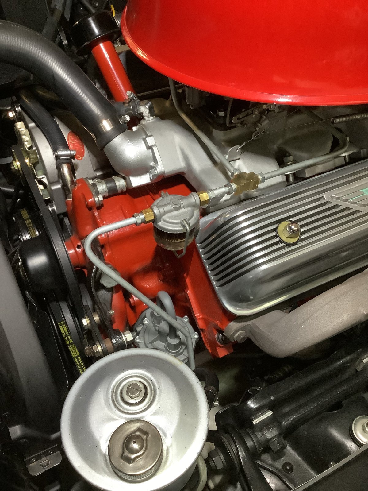

    I would get a repo AC gl*** bowl. I added one on my dual quads. The fittings are 1/8” pipe with 5/16” steel line. It hasn’t run out of fuel in 7 years and I’ve had it over 100 on early morning freeways many times. IMG_0166.jpeg

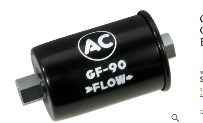

    I just switched from my A/C gl*** bowl filter like the one that Jimmy six show. It worked
    great for 6yrs. then out of nowhere, started leaking at the bowl gasket. Almost had a huge
    fire. A GM filter that was used on models of 350hp 327"s and Corvette is the GF90
    metal filter. Fits in-line very well.

  7. so thats what i need... i want a filter thats thread in but not necessarily gl***, and gf 90s are over 30 bucks now.

    I was thinking about one of these. I like how your install looks.
  9. jimmy six
    Joined: Mar 21, 2006
    Posts: 17,237
    jimmy six
    Thanks. I believe 55-57 Chevrolets used this style to feed their 2 and 4 barrel carbs. I don’t like Ecklers but bought it 10 years ago. Make sure to brace/support it. You can just see mine at the front of the manifold. It an aluminum strap.

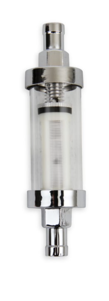

    Yeah, I'll never have a gl*** filter on a car again. I got a carb from a guy and it had one of these Mr gasket style in the fuel line. It was in good shape so I ran it. After putting about 5,000 km on the truck, we were leaving a hotel for an 8 hour drive home one morning, and I wanted to check something under the hood. The filter had come apart and was spewing fuel everywhere. Could have lost the truck, had I not caught it right then. Now I run metal filters. I don't need to see fuel that badly.
    I looked up those GF90 filters, the black ones like you show are $90 in Canada, plus shipping. Hell if I'm paying that much for a filter. I'll stick with my $12 metal Wix. Less traditional, but not $90 either.
