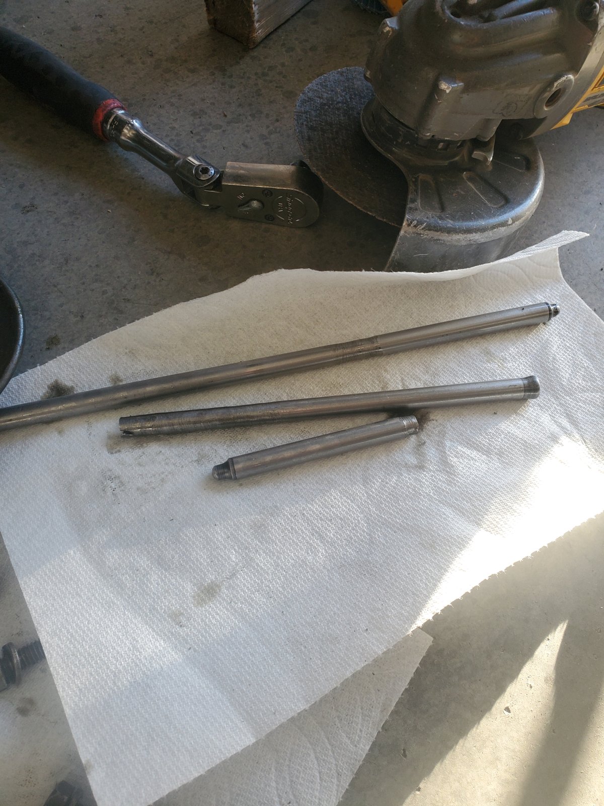

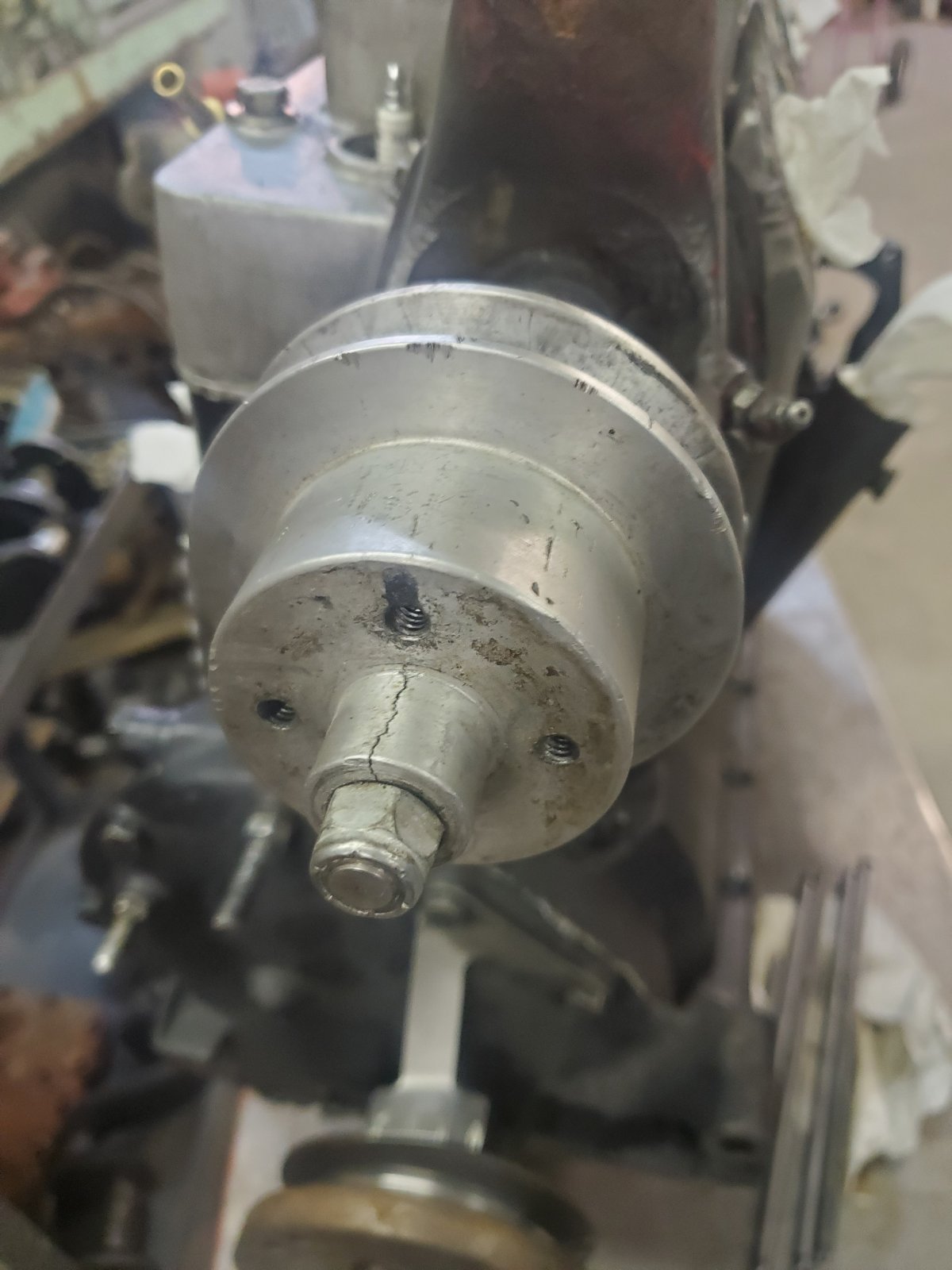

    Hello all i have a 32 b motor with a Jenkins OHV conversion. I starting noticing some issues a bit before and during the Flabob TROG. Pulled her down when i got back and found some broken and bad parts. I didnt built this motor, i got her running/driving at the time and didnt investigate further. I pulled the motor and its at my builder. So we are trying to find some parts/help
    The bad

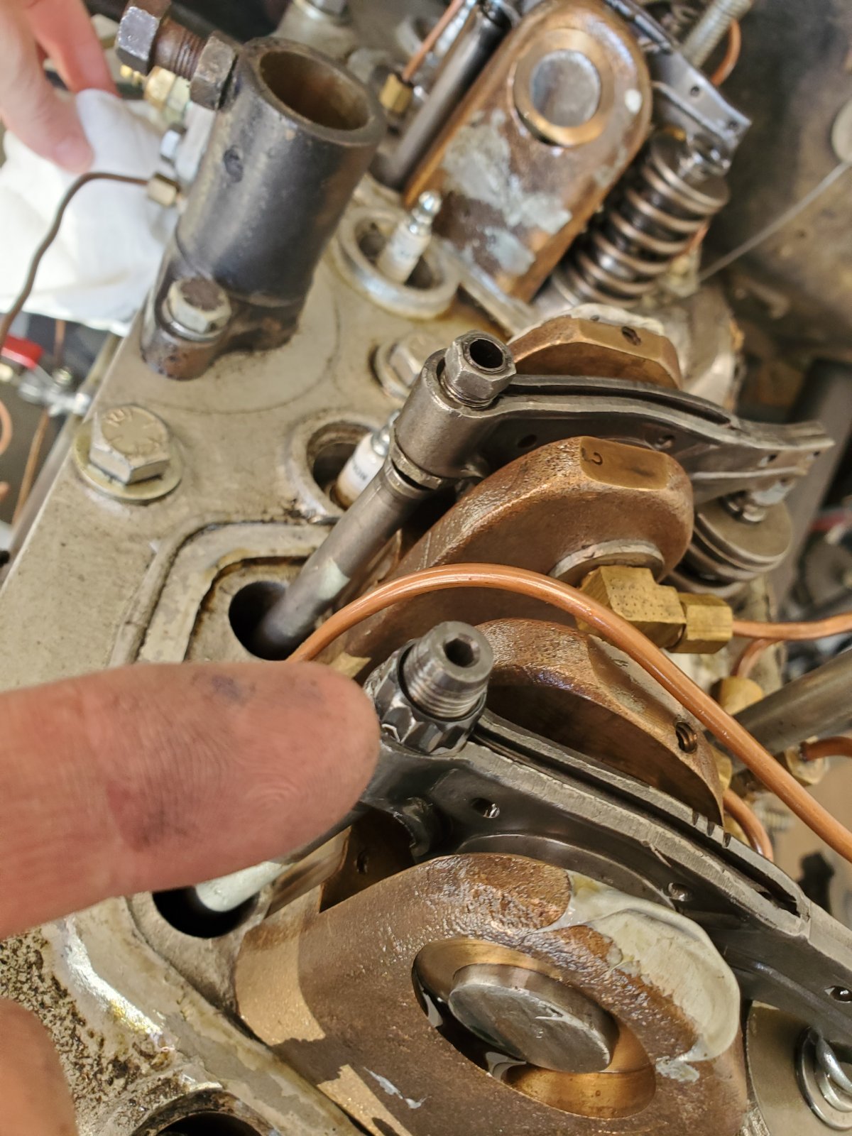

    #4 intake pushrod broken in half.
    #1-3 pushrods all rubbing and close to breaking also
    The rocker arm adjusters were hand tight and mismatched.

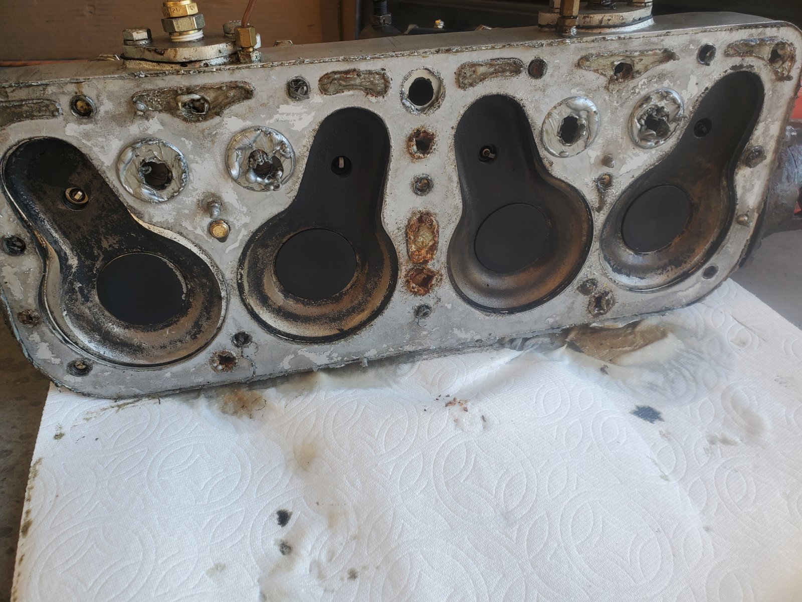

    A head gasket and spacer (for clearance)?

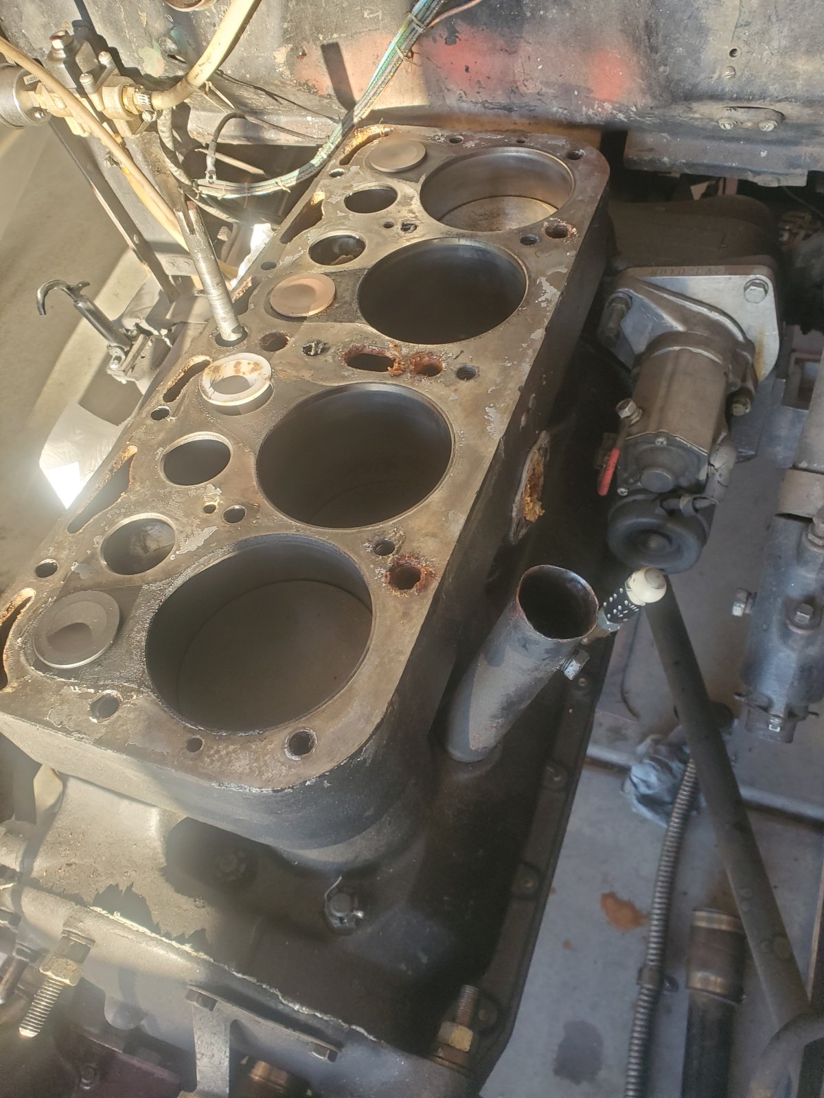

    #4 piston sits .60 thousands higher then the other 3.
    1-3 pistons sit almost flush
    Aluminum Fan pulley cracked
    If anyone has an idea on a replacement head gasket part number/brand
    Replacement pushrods or where i could get them made?
    Thanks all for any help or leads. 20230128_141916.jpg 20230128_141916.jpg 20230128_152705.jpg
    And why they mig 20230128_152705.jpg 20230128_153337.jpg 20230128_153334.jpg 20230128_155619.jpg 20230128_155622.jpg 20230128_160014.jpg 20230206_104344.jpg 20230206_104346.jpg ht of used a spacer and headgasket.

    If yur gonna scrap the Jenkins head… I’ll happily give you the $2.00 per pound scrap rate! They are strong running heads and are well worth the effort to dial in. Yours probably suffers from amateur assembly as many old motors do.
    The piston height difference is probably from a mismatched set of rods. This motor probably lost a rod bearing once upon a time, and the long rod is from a different batch. Talk with a reputable babbit pourer and order up a rod with a length to match the rest. Look up Rocker Arms Unlimited in Redding CA

    Alchemy- it looks like the roof headgasket will fit i just need to confirm bore size before i order.

    The lower end is in good shape, it still has babbit bearings, but has a c model counterbalanced crank with wilson inscribed. The b motor block has don davis inscribed on it. And a jim brierly cam shaft. The pistons/cylinders are in great shape .60 over. He found issues with the rear main and had to modify/add shims to fix the leak. Looks like the #4 cylinder blew out the original headgasket as well.
    Just trying now to source the pushrods. I not finding an off the shelf length and going to need custom ones made. It looks like the roof headgasket will work. Hoping to get it all back together foe the next Trog. Also planning to switch out the 2 stromberg 81s for 2 97s.
