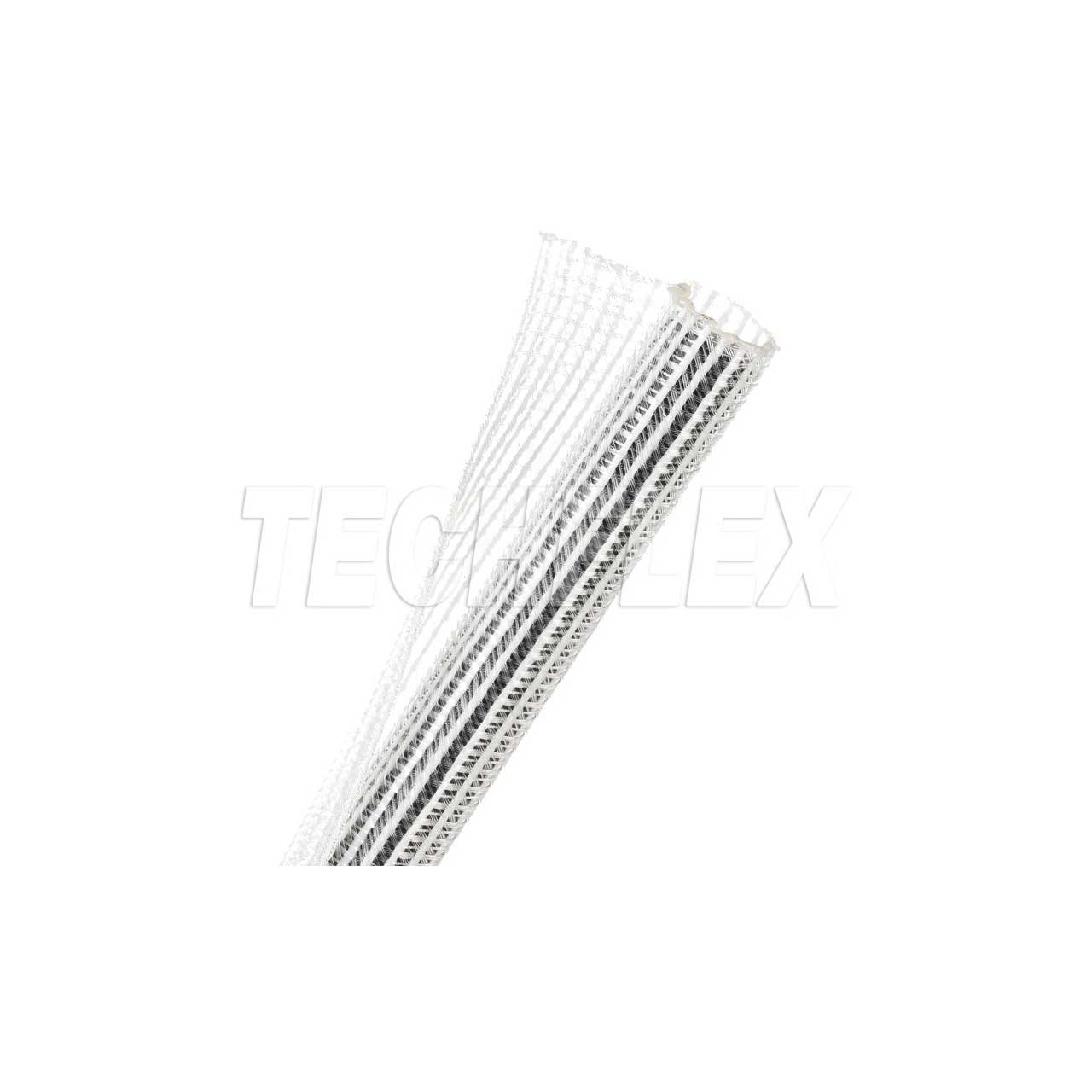

    JEGS has it. Holley part # 573-110: TechFlex F6 Braided Split Wire Loom

  17. Look up products for hydraulic lines, computer cabling, line covering. I bought some different types from Amazon and McMaster Carr (High temp covering) for the panel truck.
    Techflex has a few different types (some are plastic).
    I bought this on Amazon:
    Or a Velcro style:
    Woven
    https://www.techtoolsupply.com/Prod...MIy53My52N-QIVfh6tBh1WmQzuEAkYAyABEgLwrvD_BwE
    You can also use self sealing tape, but it's pretty permanent and only sticks to itself.
    I'm going to use either the woven or asphalt cover on the '28. The asphalt isn't split so you have to plan it right first (all wires run already with extra for future).
