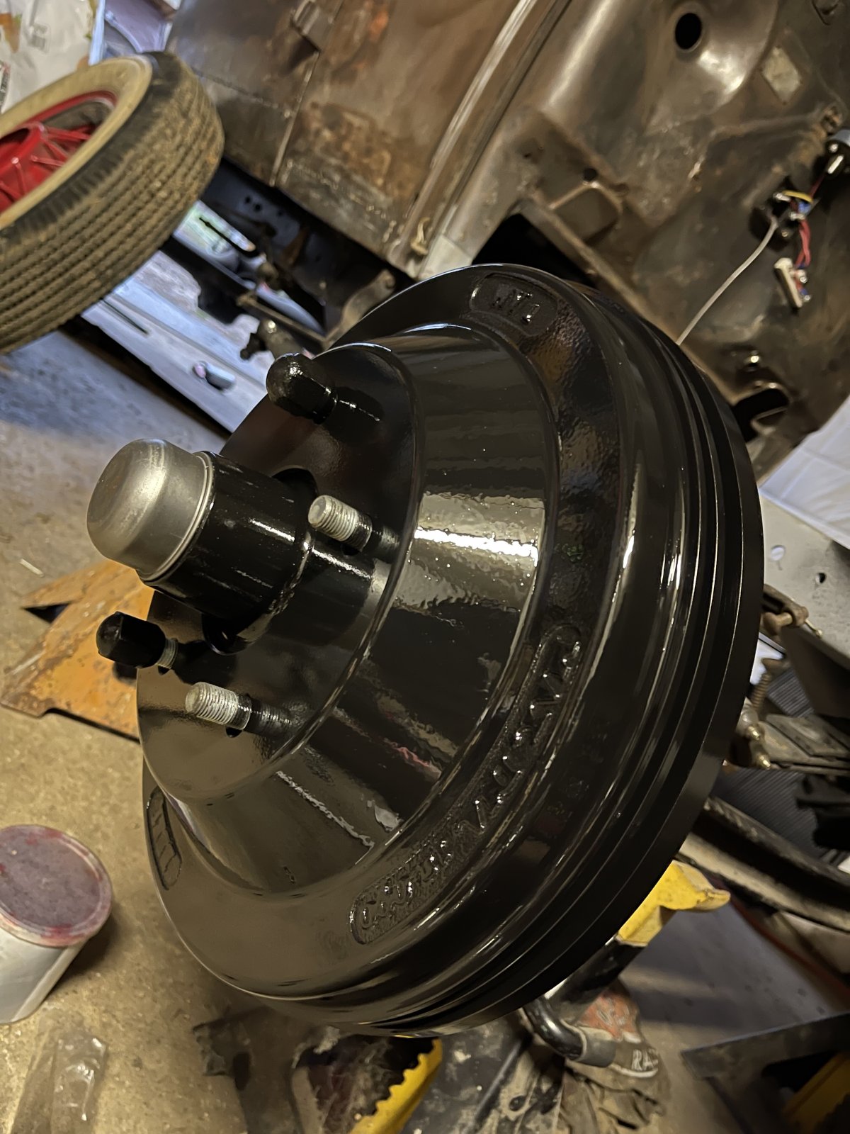

    Just got done installing a boling bro’s juice front brake kit on my 29 model A . Hubs spun nice and smooth, put the drums on and can hear a little drag when spinning. Mount the wheels on and those ****ers drag bad! Took it all apart to check the bearings, didn’t see anything noticeable, re***embled everything and still alot of drag! The brake adjusters are all the way in too. What am I missing ?

    I really doubt you have 29 spindles, but a photo would prove it. Your pic above doesn’t look like the drum is seating correctly on the hub. Maybe you have some mismatched parts.

    I think the issue has been solved. This lip on the backing plate was showing signs of grinding. I hit it with the grinder and it feels and sound soooo much better. Thanks guys

    Based on the picture you show of the drum mounted on the five studs, I believe I know the problem. Those studs are too small for the holes in the Boling Bros drums. And if the drums are mounted on stock FORD hubs, they are definitely too small. IF using original '40-'41 style hubs, you must ream the five original stud holes to 0.600", and then install Dorman #610-234 studs.
    Looking at the two lower-most studs in the picture, it's easy to see that the drum is hanging OFF CENTER. Without using the Boling Brothers required Dorman studs, the drum will never run concentric with the hub. When you tighten down on the lug nuts, you are locking the drum off-center, and allowing it to rub the backing plate on top, for instance. DD/Coop
    Tow Truck Tom likes this.
  25. DD COOPMAN, You are pointing out that the center hole in the Drum does NOT self center on the actual Hub shank. If this is correct then even using the recommended studs it sounds like a person should then have the Drums turned on the hubs locked in place on the Required Studs to get the shoe surface running true on the hub. What the Heck?
  26. I can actually see exactly what you're pointing out in post #24 on close examination.
