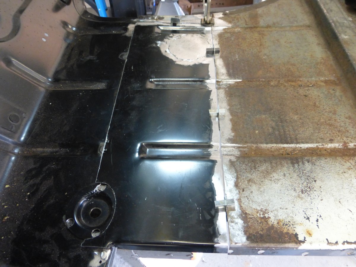

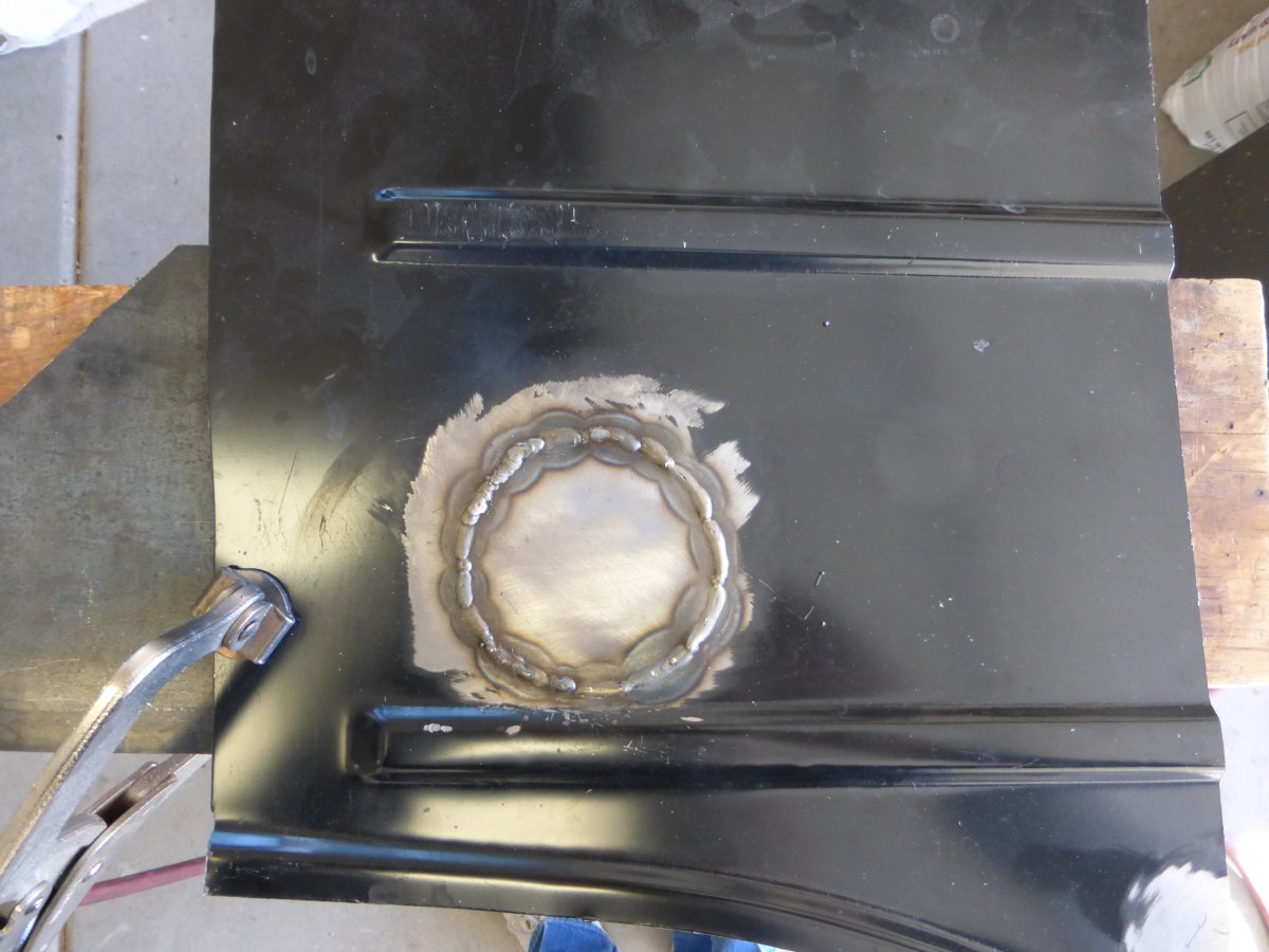

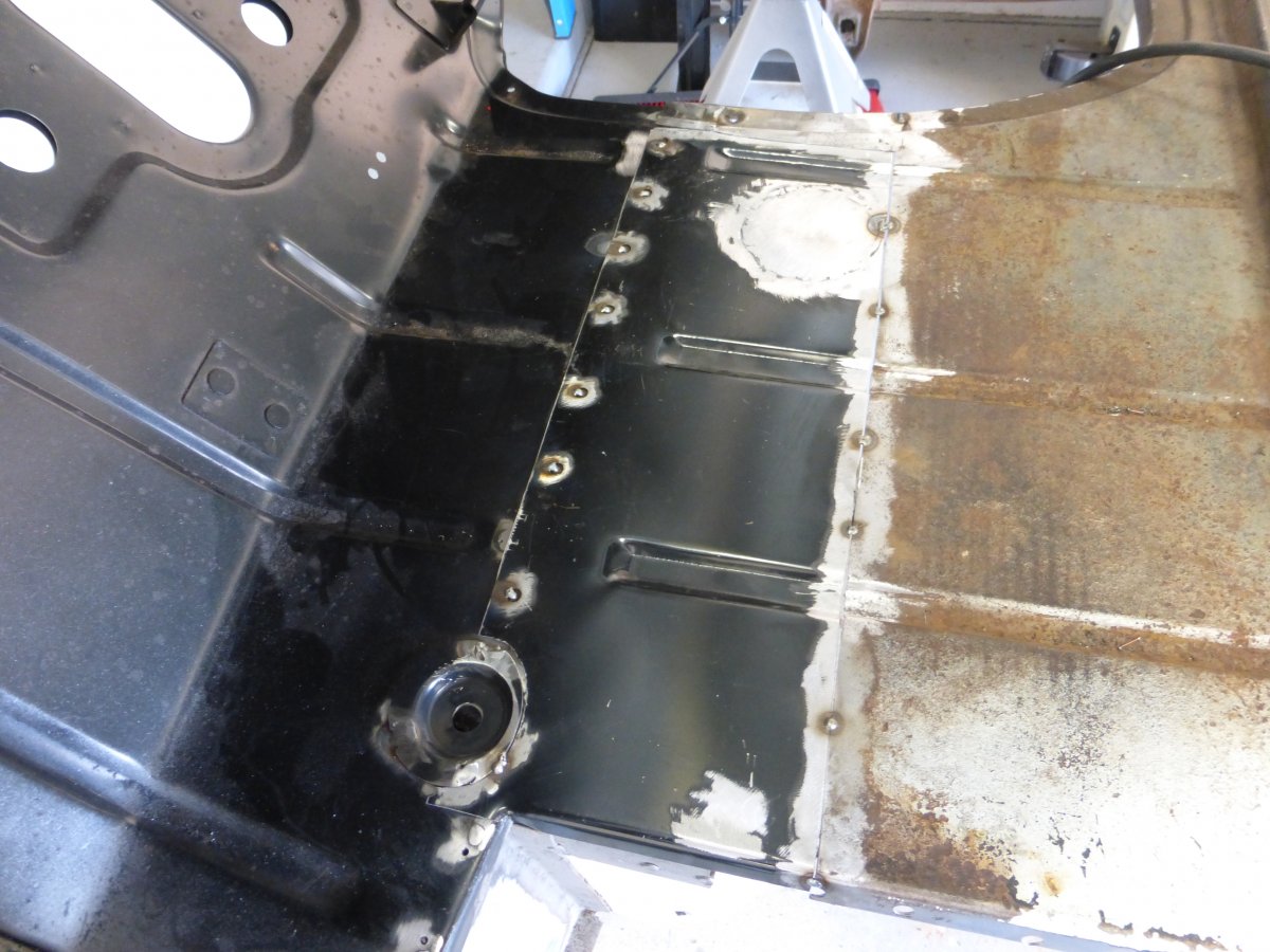

    OK. I'm really messing up this thread business. I started out in the "Introduce Yourself" section of the site. Not many users go there, I guess, so I moved to the "Projects" section. But ... looks like I got bounced back to "Introduce Yourself" in The Great Crash. So here I am back in "Projects" but with some lost posts and many lost replies. Let's just move on, OK?
    So I did decide to close up that access hole in the driver's side floorboard and was happy to discover that I can still weld!
    Next, we'll see if I can get the floorboard back to flat.

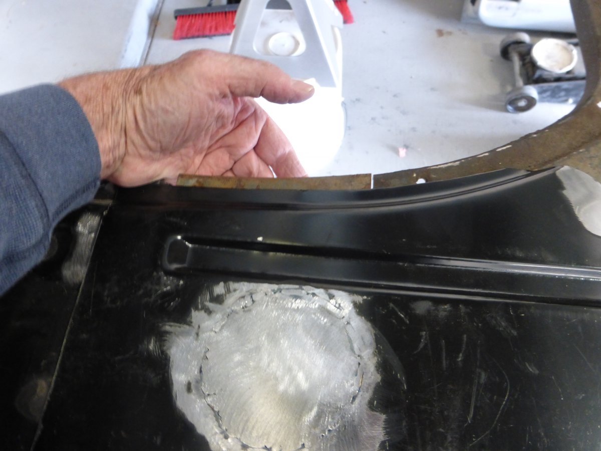

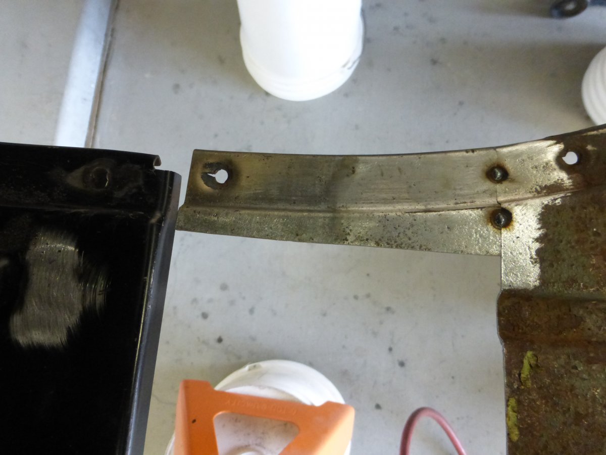

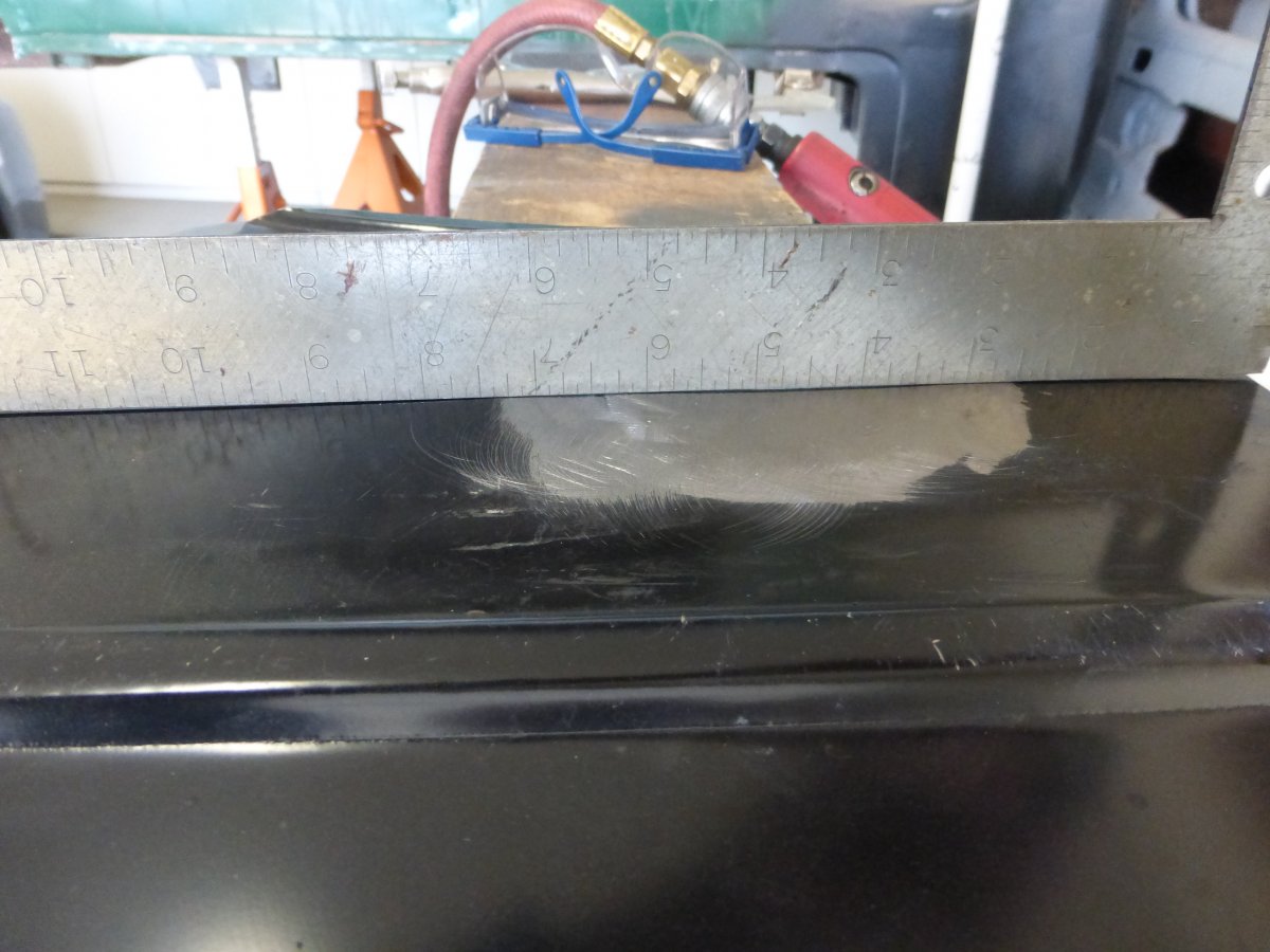

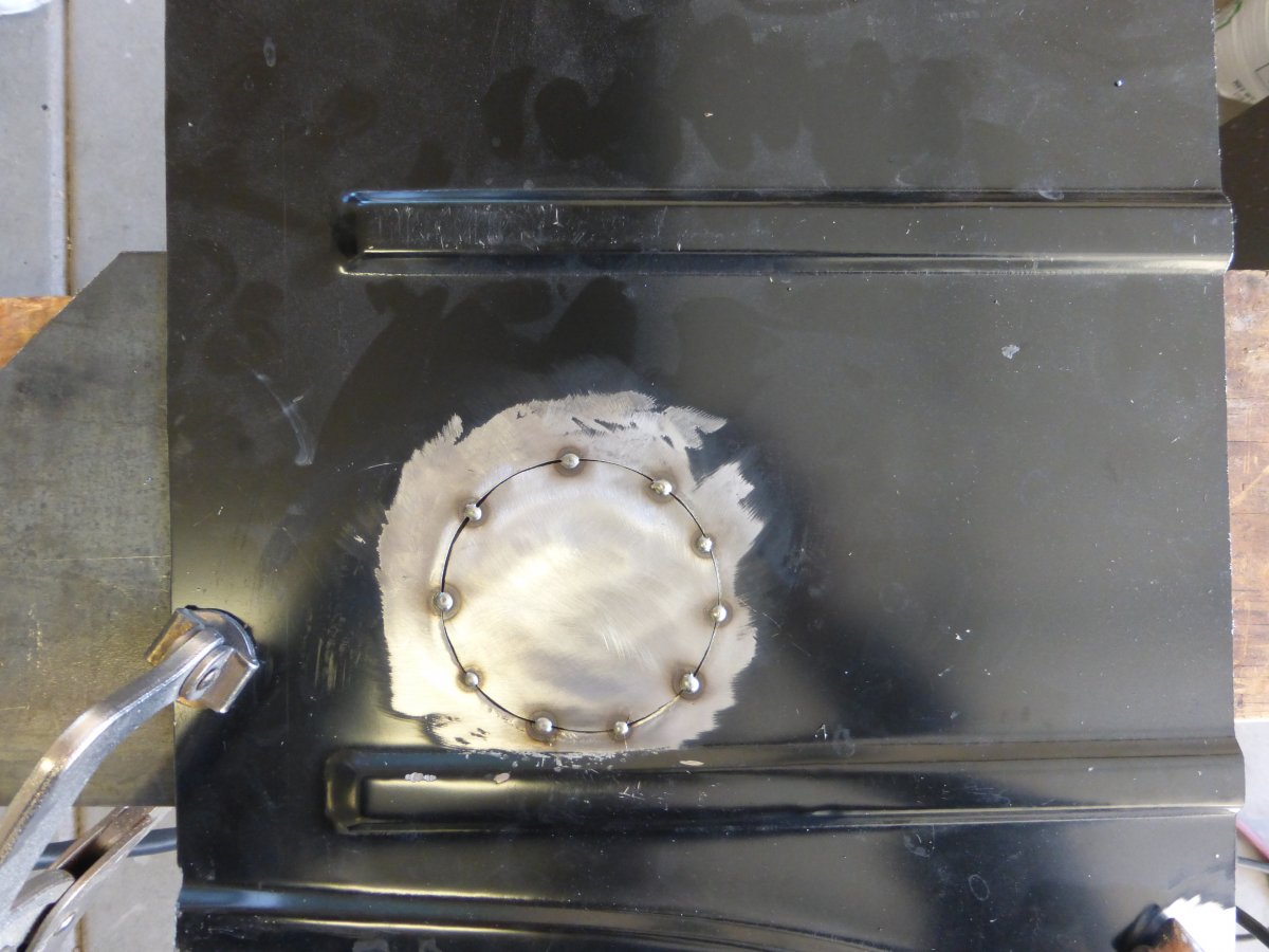

    Today's post is called "Plan Ahead." The floorboard isn't PERFECTLY flat, but hey ... it'll be covered by DynaMat and carpet so I think we're good:
    However, when I cut out the original floorboard, a piece of the lip that supports the trans cover went with it. So now I've got to re-attach that piece of the lip, either to what's left of the existing floorboard or to the new section:
    (Would have been nice if the replacement floorboard section included the lip.)

    After that response above I Googled "59 Chevy master cylinder" and a**** the photos that popped up was this:
    Crazy or cool?

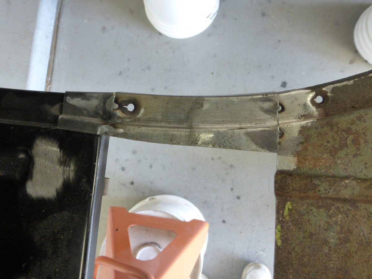

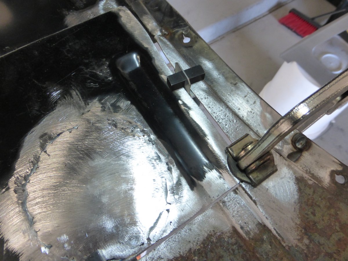

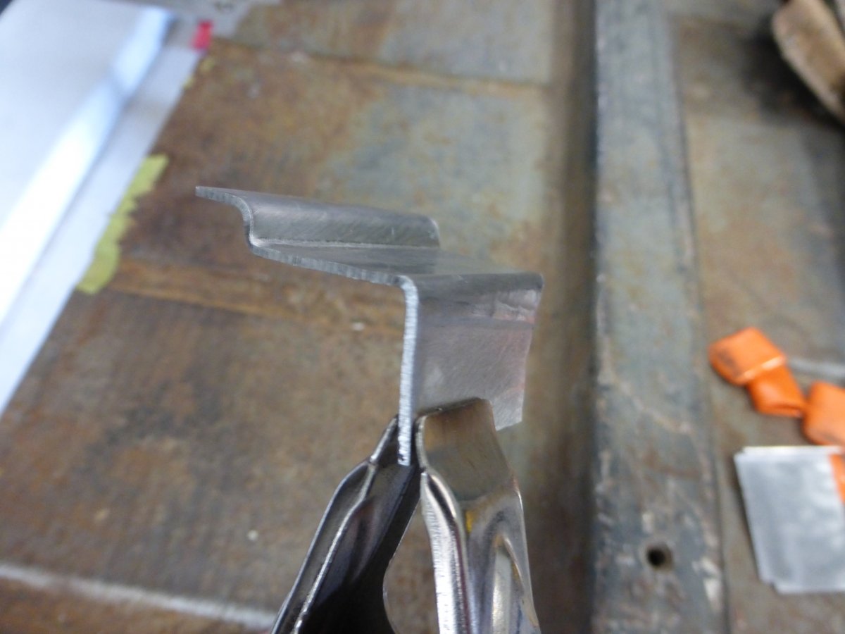

    Up thread, I noted that the repro floorboard did not include the lip that supports the ****** cover and hadn't decided whether to stick the lip to the new floorboard or back on to the old one. (Realized that was the obvious choice.) But either way, there was a problem - the old lip didn't extend all the way to the new floorboard:
    Which meant I had to fab a small piece to get it to reach:
    Worked out OK. Not perfect, but it'll be under the DynaMat and the carpet!
    Next, finish weld the extension and trim the new floorboard to fill the hole.

    Almost ready to weld in the new floorboard piece:
    The gap is a little fat at the inside edge:
    But with a copper backing, I think it'll work. We'll see!
