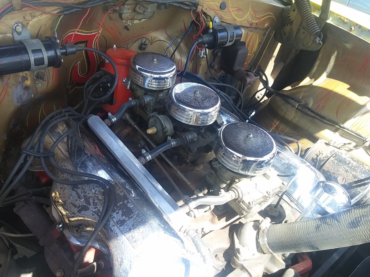

    Hi, Jim! Didn't know about the 283. I got a major hankerin' for the 348 w/3 deuces. There is (or maybe was) someone here in the Valley who specialized in W heads. Saw him at the Goodguys in Scottsdale a few years ago.

    That would be fun! A friend has one of those in the 55 Chevy (car) that his brother built in the early 60s.

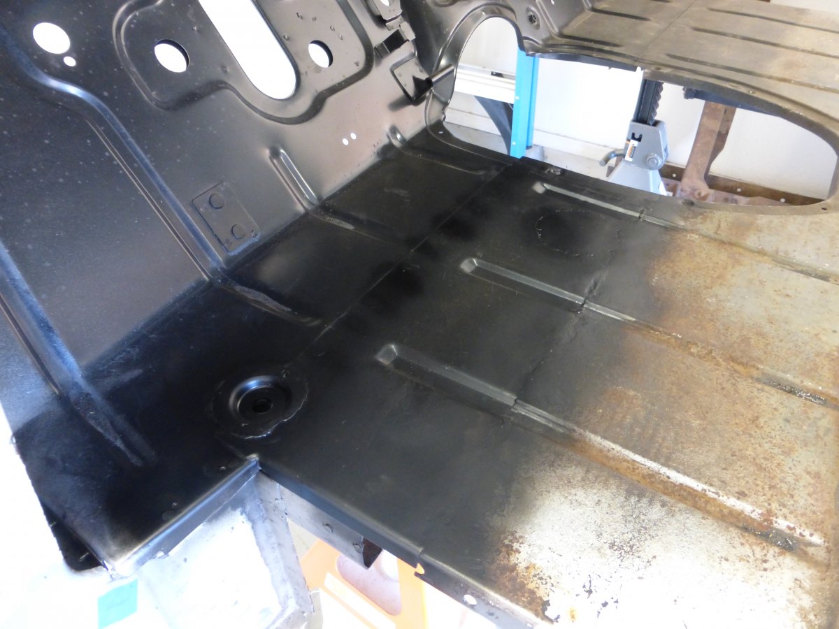

    Did your floor pans line up okay? I helped a buddy with his 59 and some of the ribs weren't exactly in the right place on the new stampings.

    I'm pretty pleased with it. The ribs line up well. Just wish it had had that lip that supports the ****** cover.

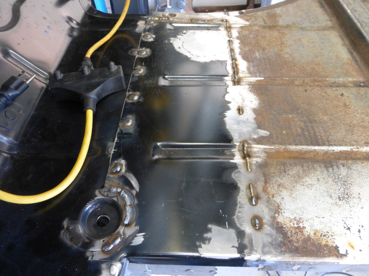

    Almost there! All it took was a couple of clamps and a piece of s**** to get rid of the sag:
    Seams all welded. After they're ground down, it's on to installing the driver's side step:

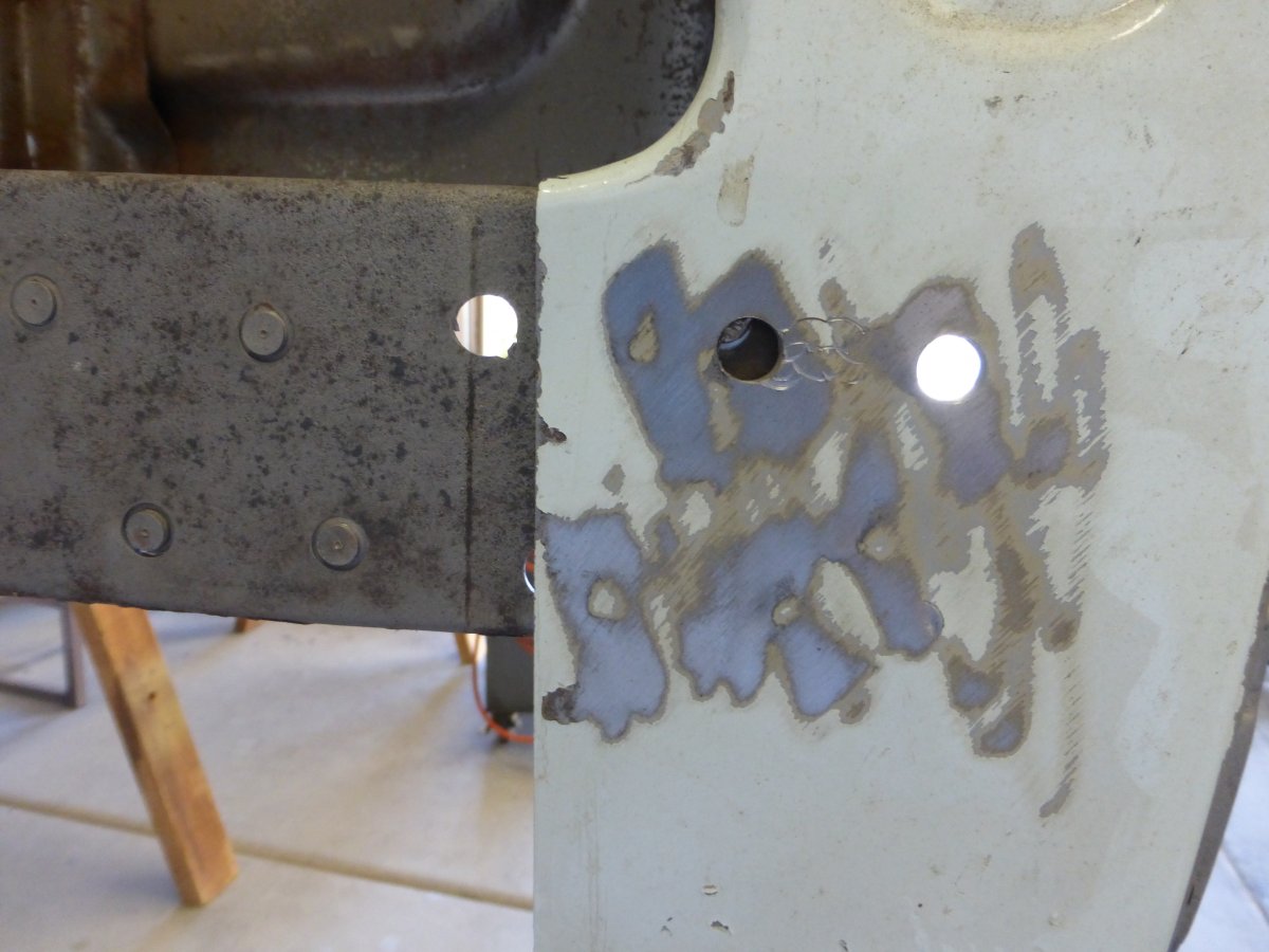

    Done with the floor patch. It's as good as it's gonna get. The ribs didn't match up exactly, but whatcha gonna do?
    Next up is the driver's side inner cab corner. It does NOT just slip into place. It consists of two pieces spot welded together and there is no way to get it into place without drilling out the welds and dropping each piece into place separately, then welding it back together.
    This also happened when I did the p***enger side cab corner and step some years ago. When I drilled out the last inner cab corner spot weld that attaches it to the body and frame, the body snapped out about a half an inch! Had to rig up a ratcheting cargo strap to get it back into place.
    Same thing happened here on the driver's side. (Doesn't say much I guess for 50's era manufacturing practices!)

    I think they put the parts in a jig, then welded them. It makes sense that it would pop out when you drill out the welds.
    They were not built to be works of art, they were built to be trucks :)
