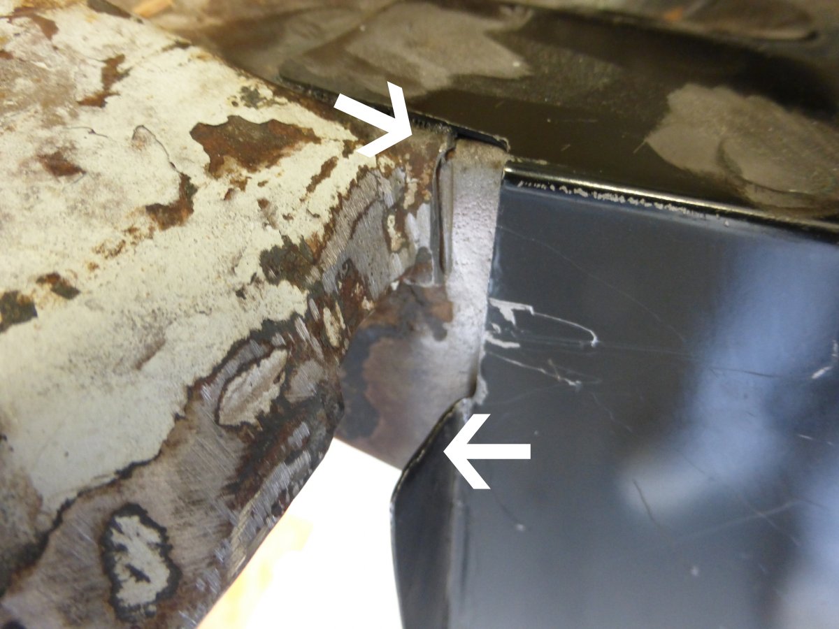

    Well, I gotta own this one. To recap, discovered the new driver's side step did not slide all the way into the space for it. This is something I really should have anticipated. I replaced the p***enger side step a few years ago (before I got frustrated and put the whole project aside) and it fit fine. BUT, on the driver's side, I charged ahead with the new cab corner installation without anticipating what came next - fitting the step. Uh oh! The inner cab corner should be about a half an inch further in!
    If the step won't go in any further, it sticks out beyond outside of the cab.
    So, had to remove that flange from the inner cab corner.
    The opening for the step front to back is still tight, so I got the bottle jack out again to do a test fit with the flange gone but ... the jack ****ped out on me! I could go get a new one, but ... I dunno ... maybe I'm cheap, I ordered a repair kit that'll be here in maybe three weeks. Meanwhile, I scratched my head and came up with a different method of spreading the opening.
    You're right. It didn't work. So I'll see if there's anything else I can do while I wait for the bottle jack parts.
    BTW, not sure when I bought the bottle jack, but the instruction sheet says 1995. Is it odd that I keep things like that?

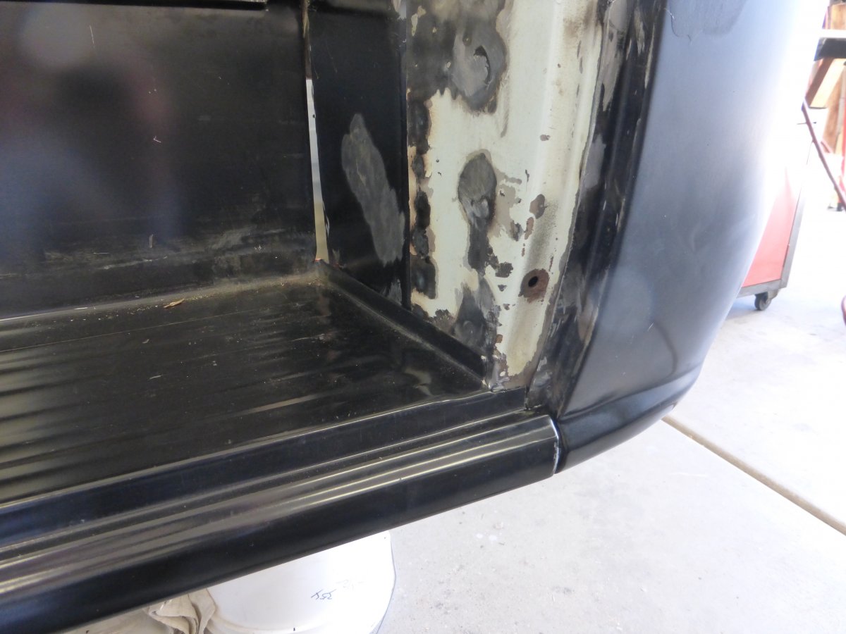

    Ta da! Success! To make a short story long, a neighbor wandered over to see what I was up to with the failed attempt to spread the step opening with a "door stop." Told him my bottle jack had ****ped out and he said, "Why don't you use the jack in the car?" Duh. Never thought of that. (Y'all should know I'm not the brightest bulb in the neighborhood.) The wife has an '06 Acura TL she loves, but it's got a scissors jack. Not sure that would have worked given the restricted space. I have a '15 Canyon and had never had a reason to use the jack, so I thought I'd check. It's a bottle jack! Mechanical, too so no worries about leaking seals. Thank you, neighbor Pat!
    The step still wouldn't slide in all the way, but stuck out only by about a quarter of an inch, along the outer edge on the right side where it overlaps the cab corner. A little work with a 50 grit disc got rid of the offending metal and ...

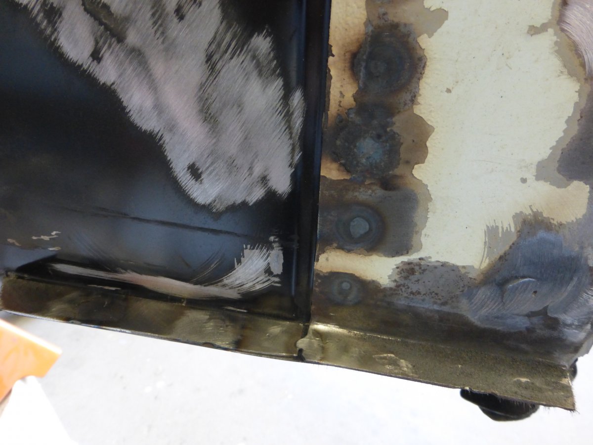

    Hmmm. Haven't seen Neighbor Pat out in his garage, so no pic yet of that old steering wheel yet. But, in the meantime, a little more t******* and tweaking on the step and it now slides ALMOST all the way in. Just a few taps with a rubber mallet and it's snug. The side edges of the step rest on a two piece stepped flange at the front and back. (Too many steps?) Well, both are supposed to be stepped, but the rear one is not. The new inner cab corner piece is flat, so I fabbed a small piece to make the flange that supports the step level. Next, fabbing a little larger replacement flange for the vertical joint with the inner cab corner at the rear of the step. BTW, not that I work quickly by any means, but things may slow down a bit. We had our first 100 degree day here in Phoenix last week. Right now it's 97.

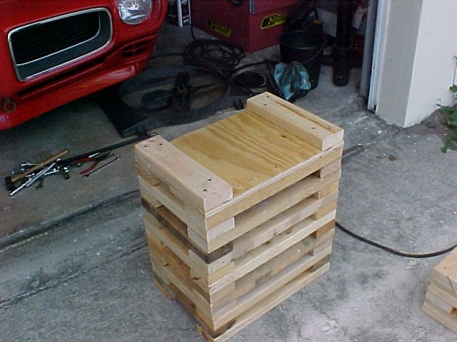

    Looks like you are moving right along. I would like to suggest that you spend $30-$40 or look around for some s**** 2 x 4s, 2 x 6s and some plywood and get those plastic buckets out from under your truck. That looks like an accident waiting to happen with the jack stands sitting on top of them. Just think of your hard work coming crashing down onto the concrete. Especially if your legs or body is under the cab.

    Okay, okay. Thanks for your concern. You're not the only one who's warned me about an impending disaster. Love your solution! I'll get some casters, too. The body is tucked in the corner of the garage and that will let me move it around when needed.

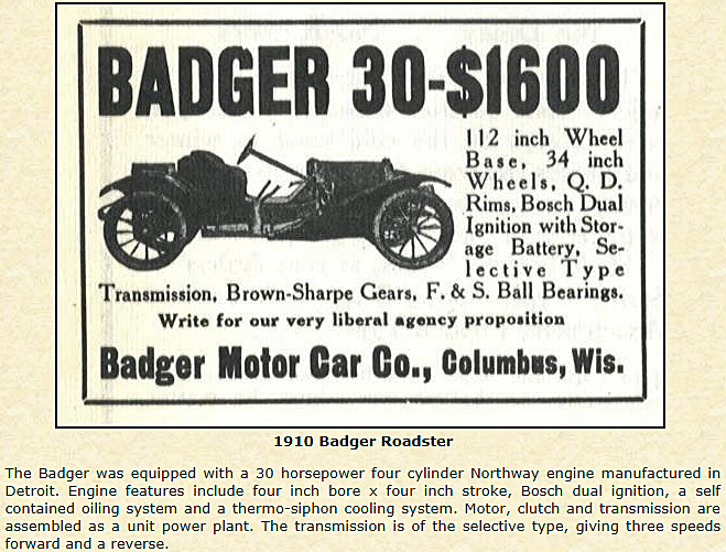

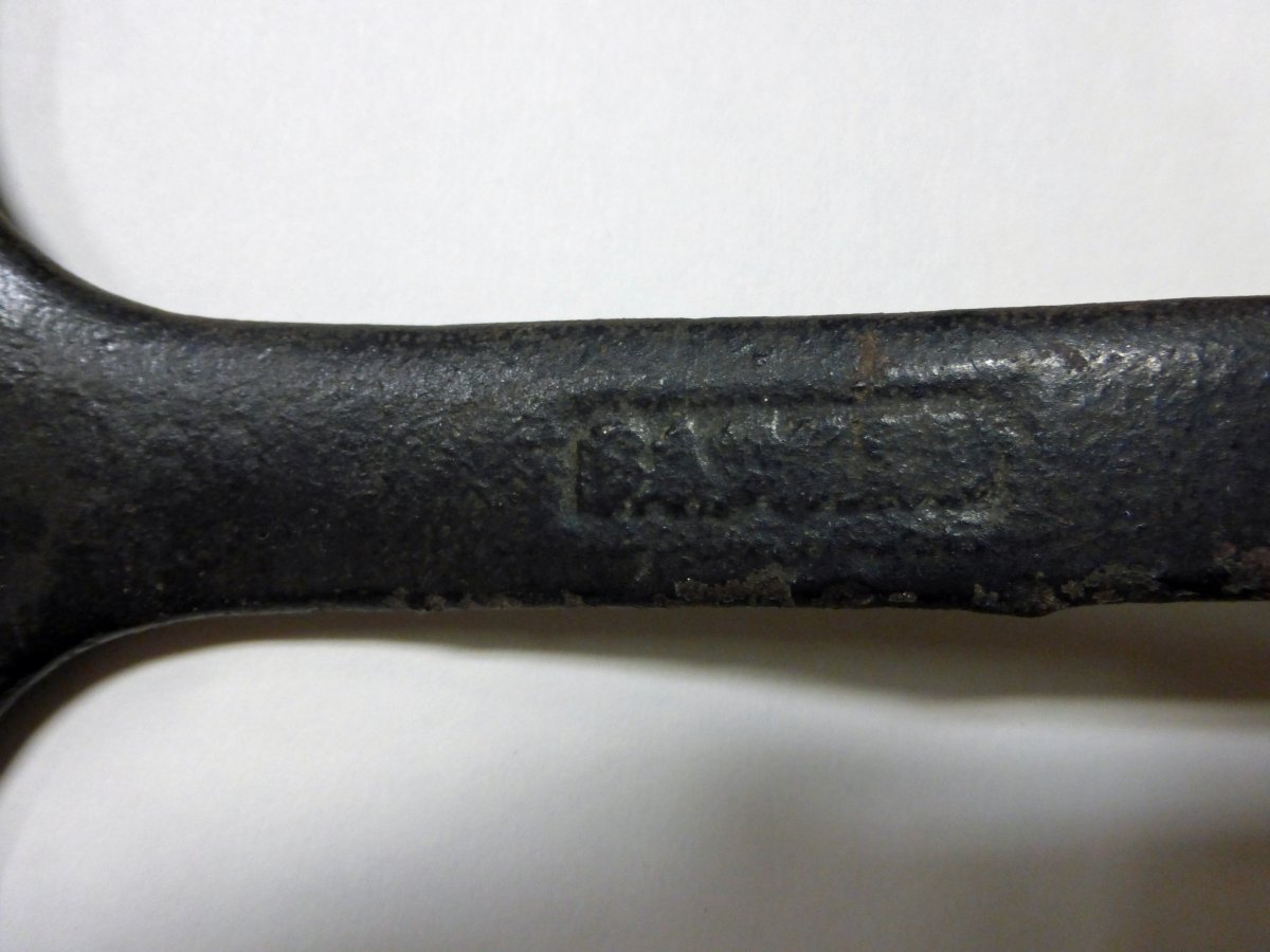

    Finally! An update and info on that antique steering wheel Neighbor Max gifted me with. The rim was in four pieces and one of the four original screws was missing, but Master Craftsman Neighbor Pat did an amazing restoration job, including replacing that original screw!
    There is a stamp on the 3 o'clock arm of the wheel that's virtually illegible. I tried pencil rubbings but that didn't help.
    I was puzzling over it again last night and tipped the wheel so the light in the garage caught it at an angle. Does that spell "Badger"??? Guess what? There was a Badger Motorcar Company in, of course, Wisconsin!
    Here's the link to the site:
    http://www.american-automobiles.com/Badger.html
    Still, given the condition of the stamping, I can't be sure it's from a Badger. Would love to hear what y'all think!
