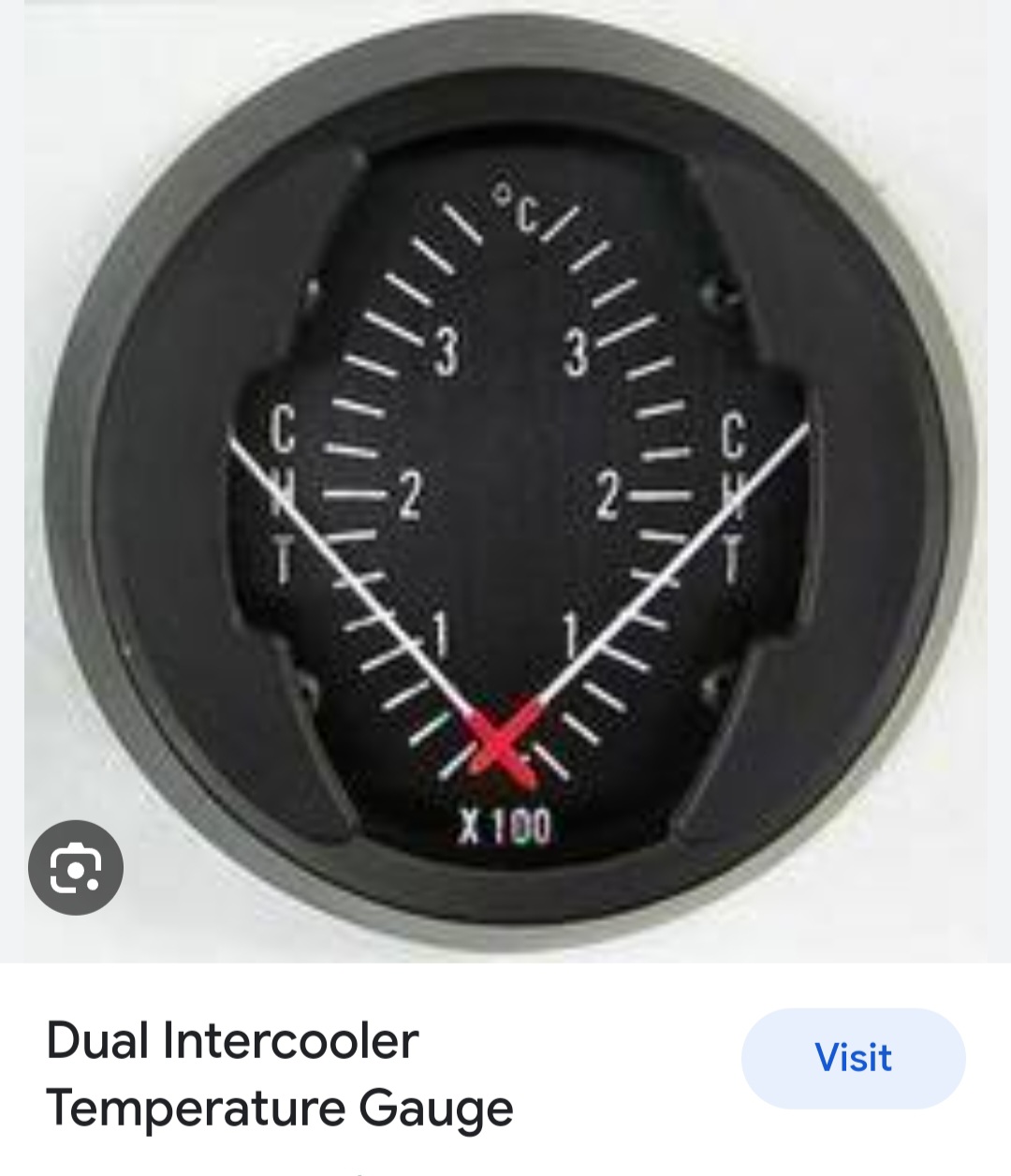

    I would be looking in the areas of things that use more than one engine; tanks, boats, airplanes.
    The only common single gauge twin needle I can think of would be for aircraft though.

    Run a dual digital gauge for setting up the two temp warning lights one for ea

    If his Caddy is running at 300°C, I think he's got a problem.
    Need a CHT from a water cooled twin, like a Diamond or something.
