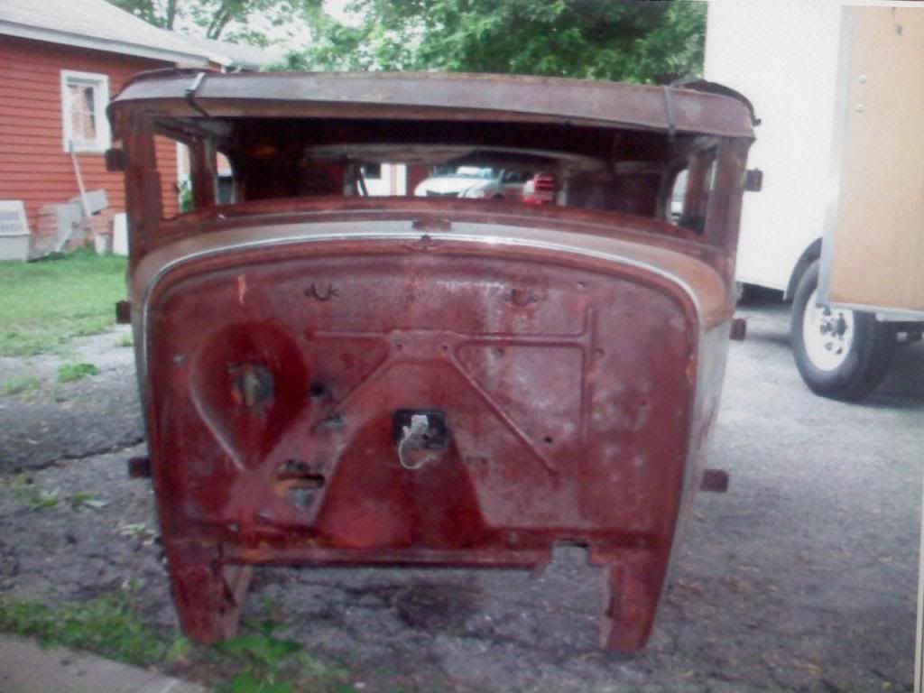

    Ok it just like it says in the raw. I am building a 31 coupe on a brookville a chassie. My plans are to clean up the metal and clear it. I dont like shiney paint nor do i want flat or simi-flat. I got the body on a trade in and it was already chopped. I dont know how much or if i will have to diet to get in but i dont care. Lol its going together. They will be alot of people who do and dont like what im doing. Soooooo........Let it fly. This is going to be fun for me and hamber remarks is what makes it even funner.
    Now down to the build.
    My car when pics were sent to me before trade.

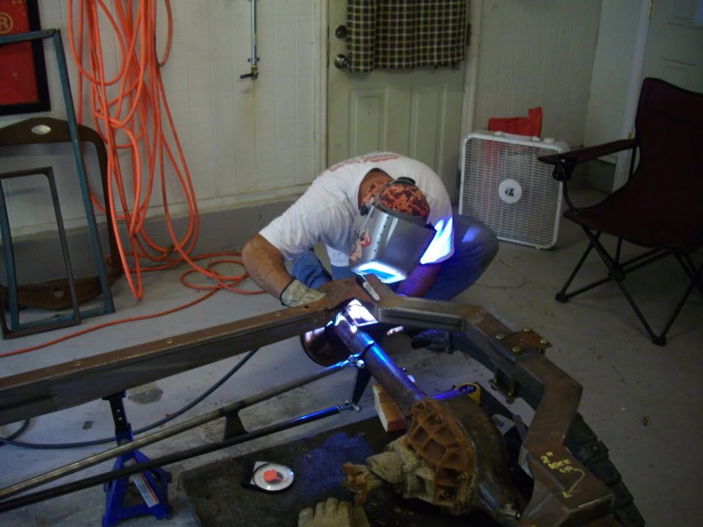

    Thanks for the pic of the rear set up. I thought i would post a couple of updates.
    Call a friend ( brad ) over to do some tig welding.
    Brad

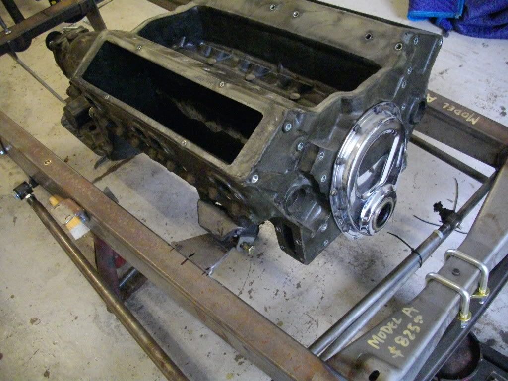

    I got a bolt in rear trans mount. I found center of crossmember and clamped it down.
    After makeing sure the frame was level and were i plan for the rake i wanted, I then took the motor mounts and bolted to the plastic block. I lined up the transission mount and set it in. It came out to 5 degrees.

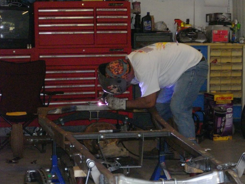

    I am now setting up the vega box, so that my friend (brad) can come back up with his tig and put a safe and professional weld. I felt my welder was to wek, and i must face it some things should be left up to the pros.:D

    The i had to find center of pete and jakes ladder bar mount and trim to fit into the frame. This took me some time. I just didnt want to cut too short so alot of grinding to get it to fit.
    once the bar was in place we bolted the ladder bars in and set the rear end and tacked the brackets in after we got our pinion angle. Then we set the spring up and added the brackets another friend jr made for me. Brad tigged in the brackets for the spring bracket, spring axle brackets, and now i have to bust back apart so we can flip frame over and finish welding.

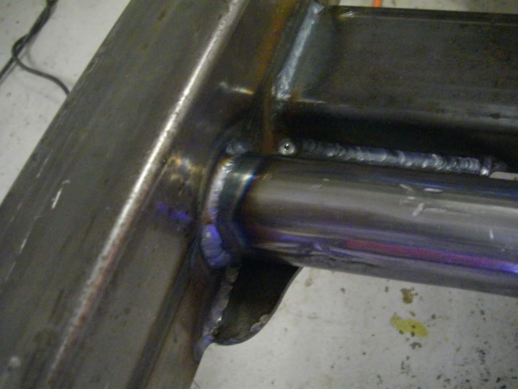

    my friend brad came over and we got the chassie finished. What we did was finish the vega mount and rear spring mount. my friend jr had made three plates, one for top and the other for the bottom. The third plate goes under the spring. He tigged the top, then made gussets and tigged to the plates and crossmember. Then we finished the ladder bar crossmember. Now in the next couple of days well finish the rearend and i can paint and reassemble. Then on to the body:D which will be an all winter long project. Heres some pics, let me know if ya think it is strong enough or needs anything else.
