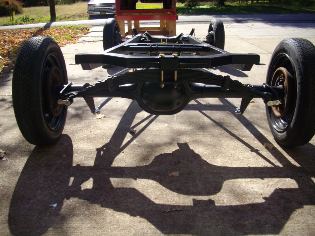

    That's a really smart way to start, with a new frame. Saves so much work in the end. One thing I see that I had to mention is that you really need to clean the metal to shiny and contaminate free status before doing any welding. Some of the parts you welded on, like the Vega box mount, were not so clean in the pictures, and even where the rear perch went on had some surface rusting.
    I hesitated to mention anything, but these threads are a textbook for guys just learning and the only way they learn is to see it done correctly. By the same token, if they see something done wrong they will ***ume that is ok too. Sorry to say anything, and hope you understand. :)

    I just walked out to garage and thought i would snap some current pics.
    I painted the rear jake bars dove gray, but may change it.

    I agree, from looking at pics it does look bad. He is a certified welder and i trust him. If he needed to do anything it was done. You are correct by pointing this out. If rust is below the weld then it is a week point and can cause major if not life threating failure. Good thing hes out of the will.

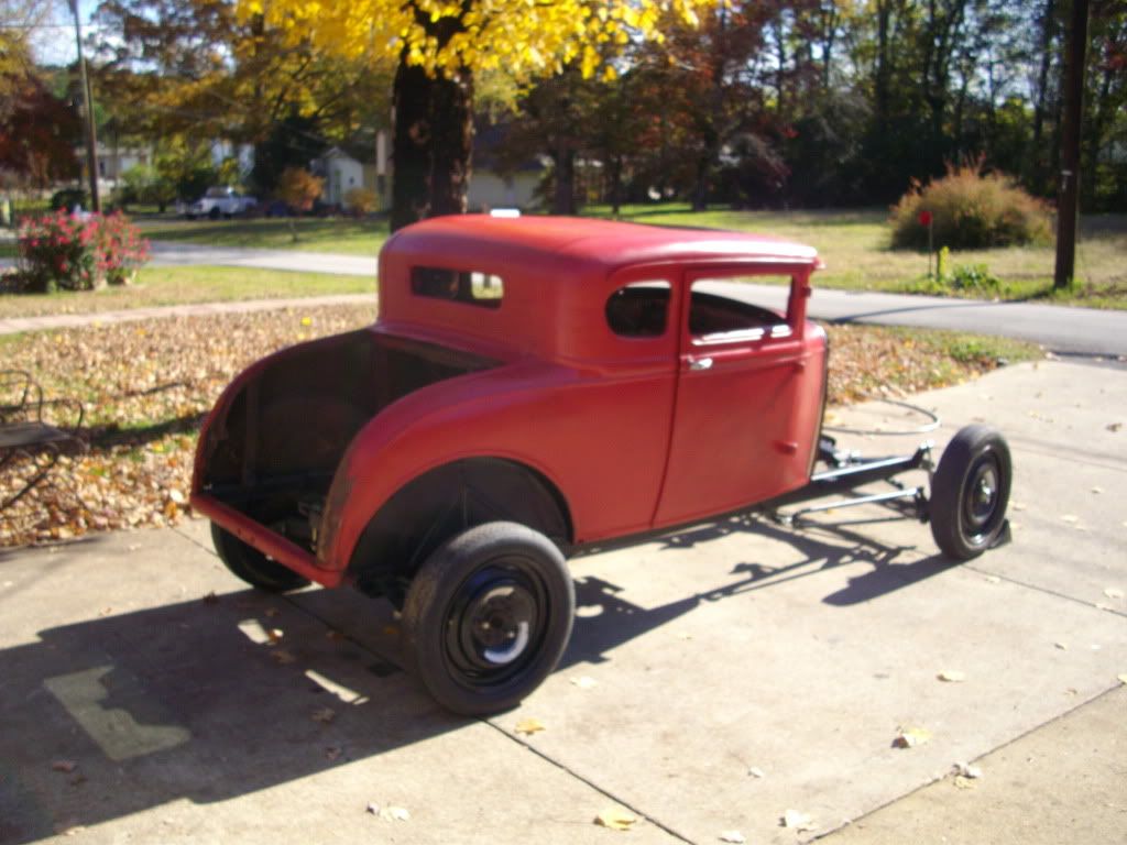

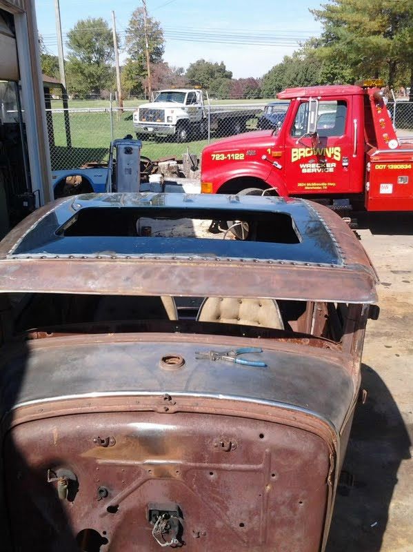

    Its been awhile since ive updated. Havent gotten much done but my friends did. I was staring at the roof and was wondering about the top. I called a freind (ricky bobbie rod shop) and he said bring it over. I loaded it up and the next day he calls and said come back and get its done.
    First pic is of roof skin in place.
    the next pic is he chopped the windshield frame and it is just laying on the cowl. He also punched some holes. I didnt want big m***ive holes so this is what i got. If you look close you will see my seats sitting in the car. Somebody some time ago cut some drums down for a bomber look.
    I also got me a dash out of a metrapolitan frazer. Complete and was donated by medic customs. That will have to wait for a rainy day lol. I will roll it out tomorrow and get some better pics of roof.

    I had to do something, this thing has a 7inch chop. Way too much, if i had some pieces i would try to unchop it by 3-4 inches. I am think about putting the frame in so i would have a rain gutter. Then making a metal panel that would just pop out with quick release pins, and then covering the top. I could roll the material down into the sunroof frame so when the sunroof is in it would be tight. You would see a seam but not bad.

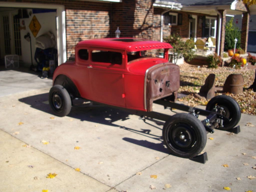

    Ok now what i have done is took it to metal and just sprayed some paint onto it to find all the dings and dents. I dont thing my metal skills will allow me to dollie it all out so ill make that decision when it comes. :D
    Good ol rustolume paitroit red
    Now by measuring the body and frame i was able to see it wasnt goin to sit down on the frame without a knotch for kickup. Measured 20 times and cut once.
    the knotch.

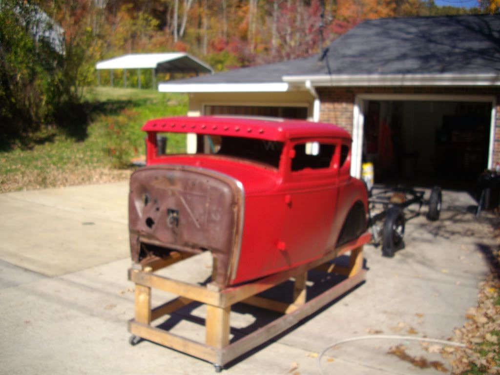

    Now im the one who dont like to ask for help when i can do it myself. So i need to get the body on the frame. What i did was roll the cart behind the frame. Put skotches in the front so it would not roll. Then the front two mounts on frame. I found two bolts, cut the heads off and used them as studs. I picked it the front of the body and drug it on the rear crossmember. I had to stop from time to time to push my hemroid back in:eek:, jk and then it happened.
    It was on the frame. I couldnt believe I did it.......:D:D:D:D:D:D
    Here is a pic of the knotch i cut out.
    I cut a little too much but i didnt have to take the body back off.
