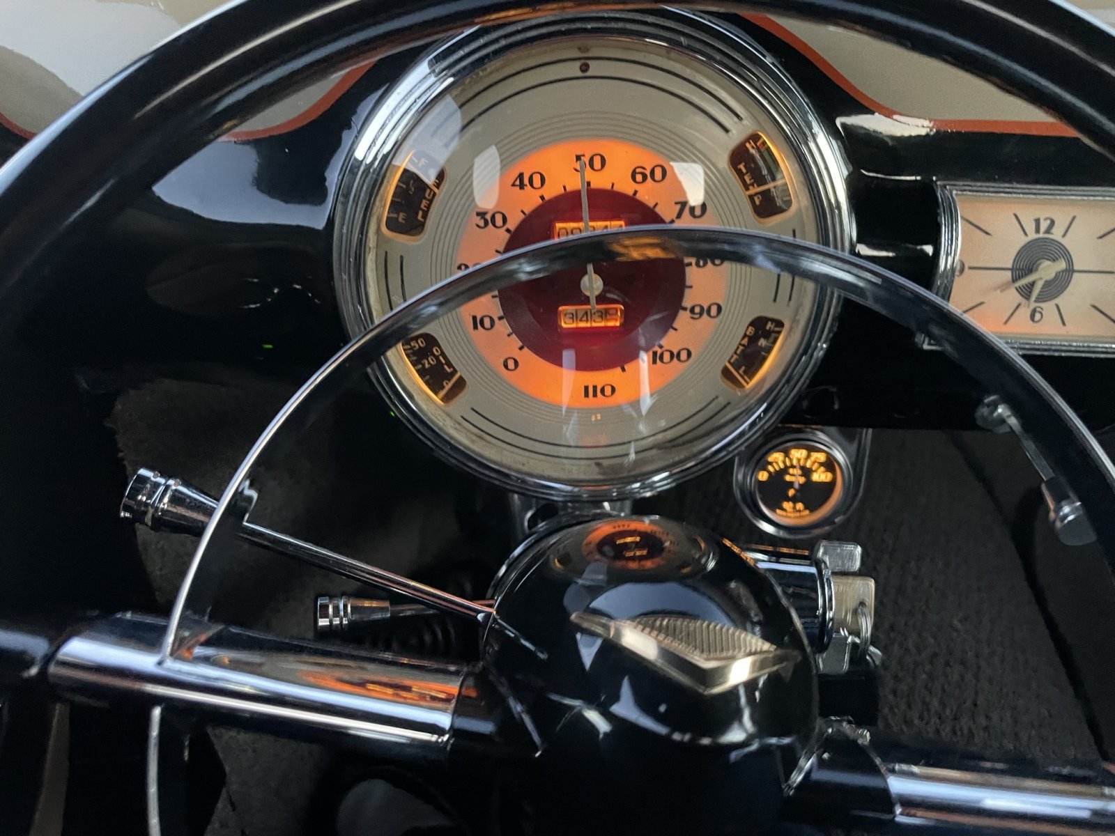

    Soooo dodge that bullet!!! Drove to and back from work today. My gauge was reading 55-60psi @50mph (no tach) and 35-40psi at idle. My gauge would rev up as I accelerated. 770FCEB6-0869-4744-9935-B1B95571C15F.jpeg 7F5553B1-CF76-478A-81F9-1866F240D3AD.jpeg

    I've seen way too many faulty old electric and mechanical oil pressure and water temp gauges. The first test is always check with a good gauge. What is unfortunate these days is that being new doesn't always mean its good anymore.

    I wondered that. I only have one wire going to the sending unit that’s threaded into the block. Maybe I need a separate ground from the gauge to the body/frame?

    What is that gauge cluster out of, it looks neat?
