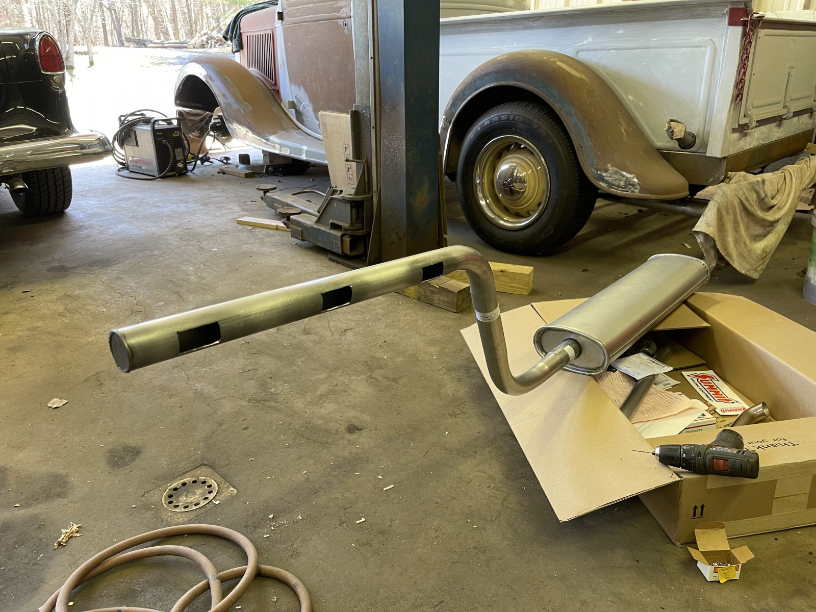

    Here is the new stock “manifold” I installed
    Waldron exhaust did a great job, it bolted up and fit great.

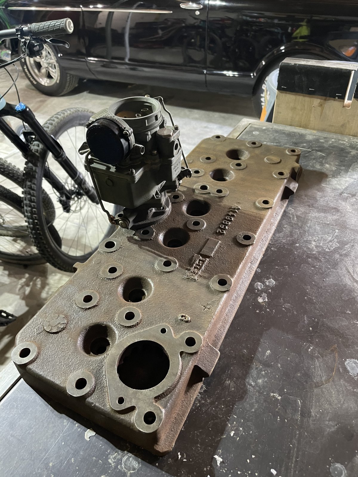

    Got the head and carb
    The date casting on the head is 3-14-56
    So it is not the low compression ‘53 year
    I think I will have to pull my existing head and compare before I make any decision on machining the head down. Hopefully its already at 8.5:1…

    So air goes down the carb, straight down the two holes into the "trough" in the head and maybe in the block, before going into whatever ports that lead to the valves, right?
    So when you mill for compression you will also reduce intake volume, unless you mill/grind the intake channel a similar amount that you take from the gasket surface.
    The asymmetrical chamber shape is really interesting, i have seen similar on supposedly good running Briggs racing flatheads.
    I would put #1 and #2 priority on improving flow- intake, exhaust and in-chamber. Any compression between 7.5 and 8.5 is fine for a flathead,, as long as flow improves. More is of course better, especiallyat your al***ude, but it must not restrict flow.
    I would: CC your new head. From there you should be able to play with a compression calculator and roughly estimate what your current motor is and how this head stands in comparison. Have the head checked for cracks. Reread the David Vizard book on porting and airflow, and likely heavily radius the edges of the two ports where the air enters. Get a 1" or 2" carb riser, most likely one with two holes that match the holes in the intake and carb(vs an open one). If you are going to have the head milled, talk to the shop and see if they can run an end mill in the channel to remove a similar amount there, and hand blend in the ends.
    On the block side of the engine, it looks like there is a factory relief that could be improved. But! You better call Kenny Loggins, because you are in the danger zone if you are grinding on an ***embled engine.

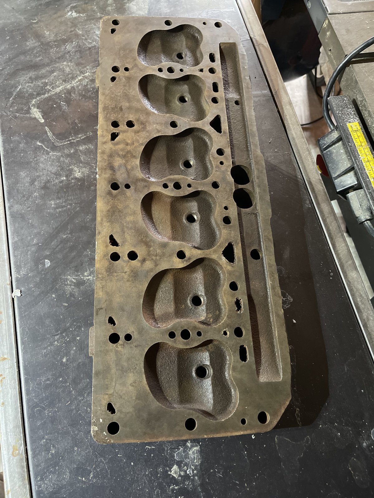

    Upper is the 2v '56 head (7.45-1 cr)
    Lower is 1v '58 head (8-1 cr)
    You can see the big divots around the sparkplug, it must be reduced chamber volume, but didn't want a longer thread spark plug. Quench pad is the flat above the flattop piston. Not likely domed pistons are the answer here, since they would have to fill the transfer area to make an increase, blocking flow.
    Carb "ports" go through head so opening it up much might hit water.
