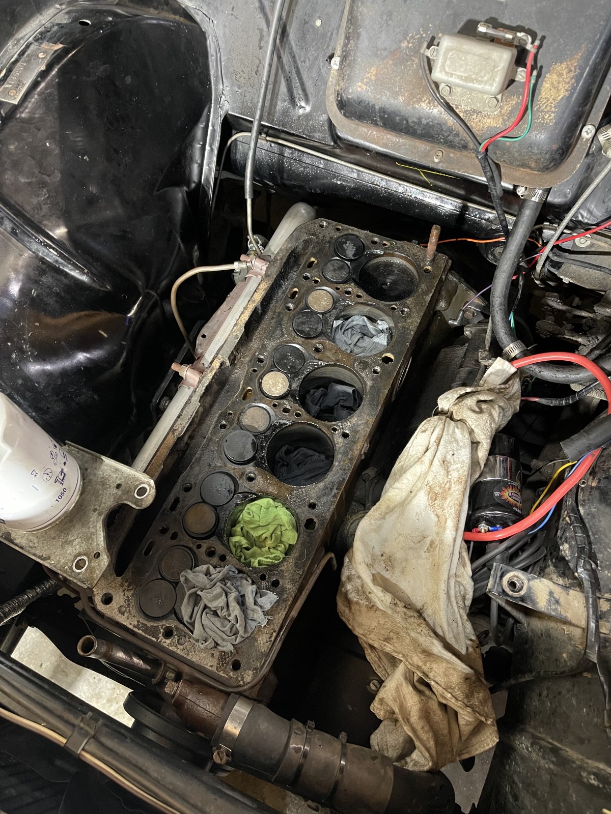

    I finally pulled my head. Motor looks pretty good inside!

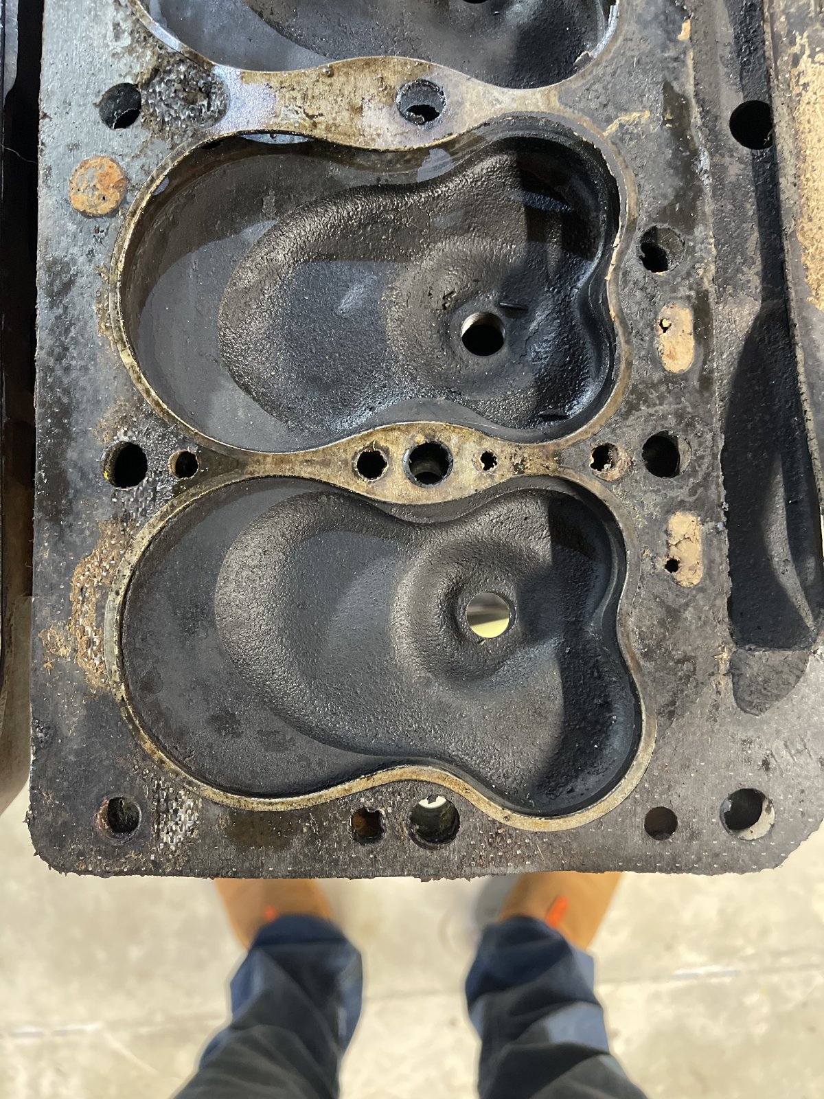

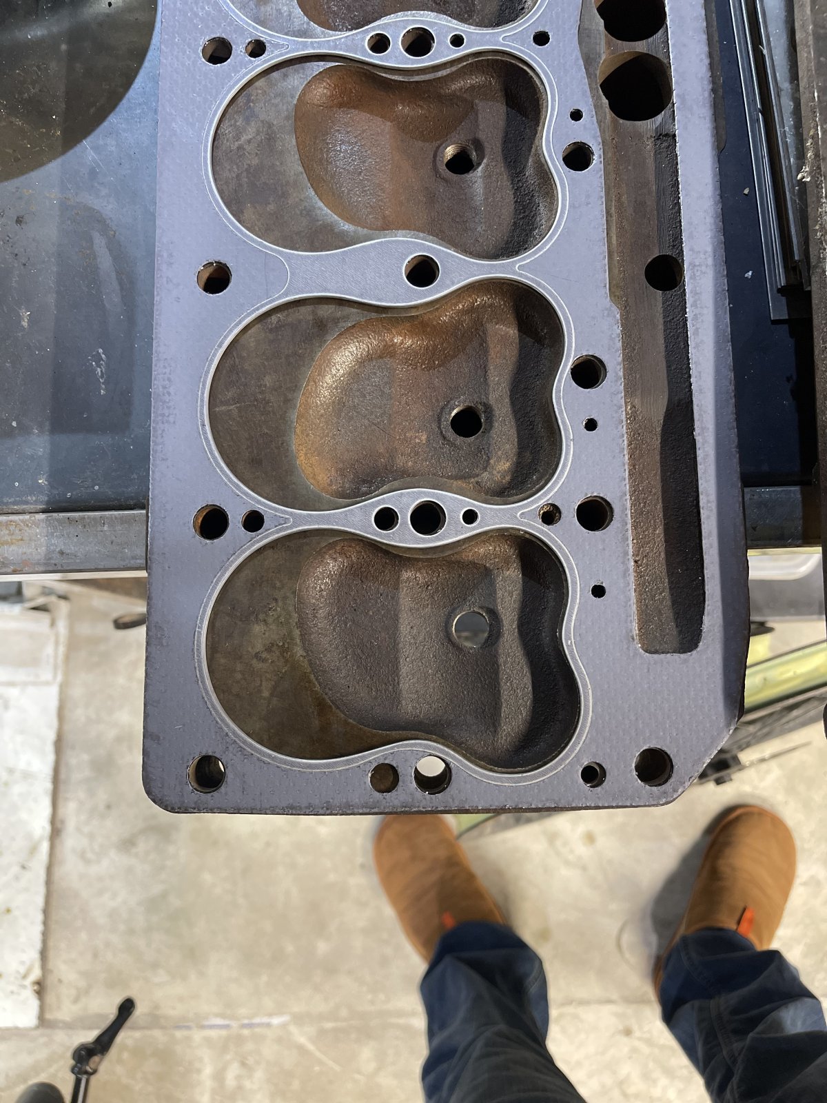

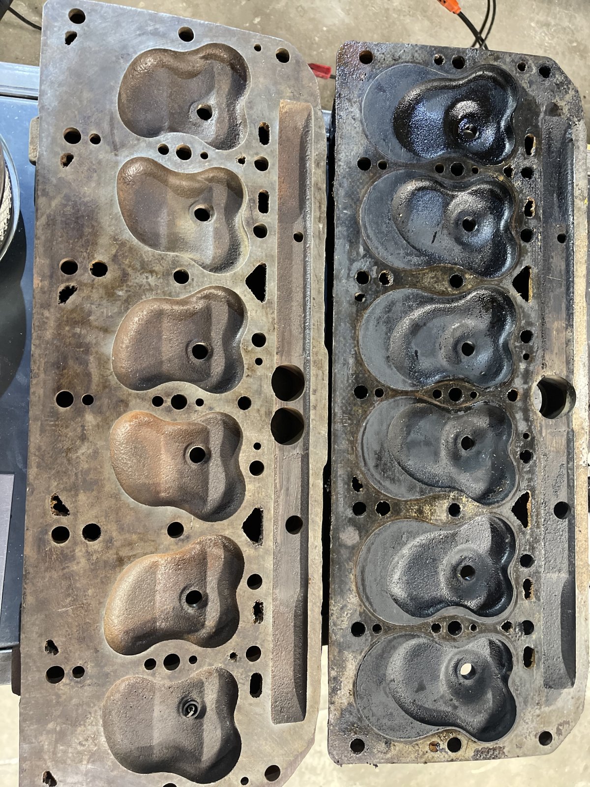

    My first very unscientific measurement of the head volumes show my stock 1959 1V head to be about 50cc
    The 1953? Nash 2V head is about 60cc. So it appears to be the lower compression ‘53 head versus the 8:1 compression ‘54 head. Of course my ‘59 motor could also have different piston height than they used in ‘53/54.
    At first inspection of both heads, it looks like I have pretty significant room on the ‘53 2V head to take off material and maintain the same valve clearance.
    Also I purchased two different head gaskets. The newer Fel-Pro 7802B gasket is significantly thinner that the older looking Fel-Pro 7802A that I got. The head gasket I removed looks like the 7802A.
    So my next steps are accurately measuring the volume of each head. And checking valve clearance on each for comparison.
    My initial thoughts are that I will have room to machine the ‘53 head to get be back towards the 8:1 compression and use the newer thinner 7802B gasket.
    Just need to figure out how much material I can and need to remove. 950C29BA-34A6-4051-B927-2B9F97AF2EDD.jpeg 7BE63B04-2CA8-4C1F-957A-A5AC5ADA2425.jpeg D6C28E33-EC81-4985-AD5E-7B91E88BB078.jpeg F3DE2F1A-B4ED-4C6F-919A-1C2EC835489E.jpeg

    Here's what I've come up with.
    Rambler American 1959 1V head = 55cc (8.0:1)
    Nash Statesman 1953 2V head = 63cc (7.45:1)
    I checked valve clearance of '59 head with the old gasket and it was pretty much identical to the '53 head with no gasket, average at .1300".
    Compressed gasket thickness of my new FelPro 7802B is listed as .0535>.0625

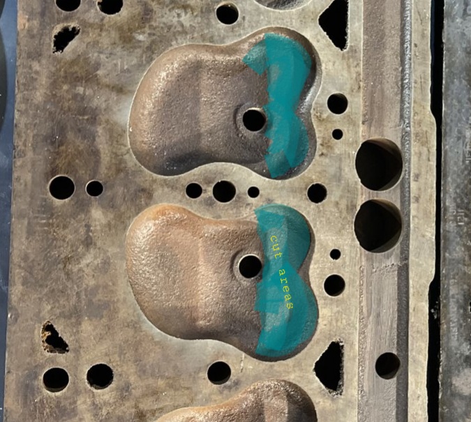

    So I think I'm going to take .0650" off of the '53 head. Add the gasket thickness back in, and I still should have adequate valve clearance, ~.1175"+
    Mapping the area of the funky head shape, I came up with 61.25cm2
    So taking off .0650" should equate to about 10cc of volume
    If the machined head finishes out at 53cc, that would bump me to 8.2:1
    Time to get it down to the machine shop in Denver!

    The problem with skimming an L head is you get diminishing returns. The less room above the valve and you restrict flow around the port. You are significantly reducing the crossectional area the gas has to get in and out of the combustion chamber. High compression heads often have a different combustion chamber shape AND sometimes even have to move the spark plug hole. You may not get the results you are expecting.

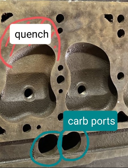

    Did anyone else notice that 2 head bolts go through the channel of the cast in intake manifold. Thus restricting airflow to the end cylinders. I would try porting the one barrel head and make the two bbl carb fit. Try opening up the head around the head bolt going through the port, and rounding the p***ages that feed the valves. If you wreck the one bbl head you still have the 2 bbl head to use.

    For true, there are tradeoffs. Milling the head .060" will increase the compression ratio that much and increase low-to-medium torque. It also decreases the transfer area, limiting top end power to about the same as you had originally.

    Those are vacuum ports, not head bolt holes.
    I don't see how adapting the 1bbl head to a 2bbl carb would do anything. The AF mix has to squeeze through the same size single hole. The two ports for the 2bbl are 30% larger than the 1bbl port.

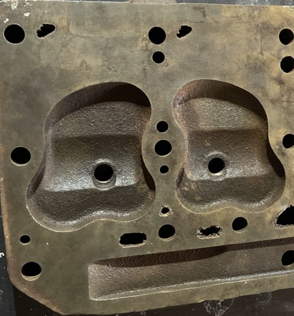

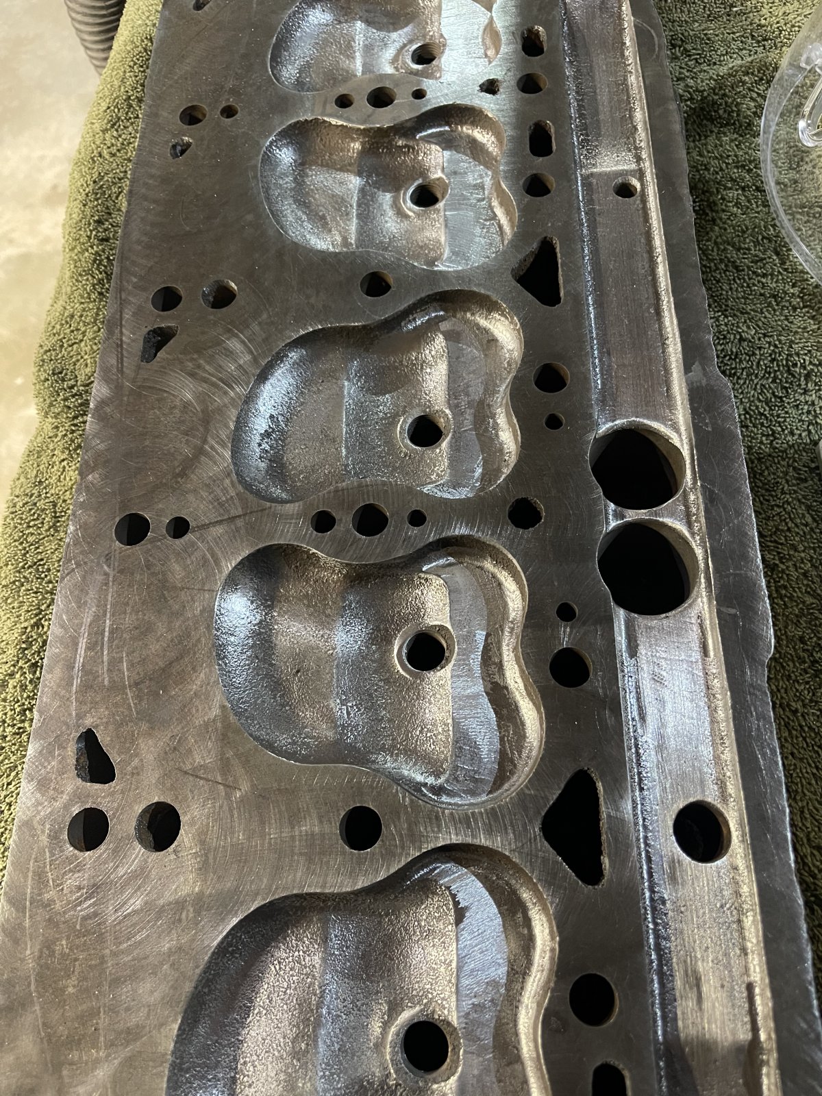

    I did do some smoothing out of the intake runner and softened the sharp edge of the intake ports. I also smoothed out the combustion chamber of the head, and removed material at the valve reliefs. That was before my PlayDoh valve clearance check.

    Head after some smoothing

    I see that they are vacuum ports now. I was not thinking of just adapting the 2 bbl carb, but boring out the holes to match the carb base. If you didn't hit a water jacket you would end up with an 8 to 1 head with a 2 bbl carb.

    The mounting flange and carb stud pattern is different as well. I didn't see a good way to make the 1V head fit a @V carb. So I bought the NOS 2V head.

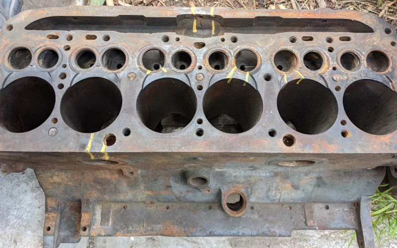

    If you look at the carbon deposits on the block you can see where the choke point is, it looks to be roughly where the spark plug hole is. If you put a strait edge accross the head at that point the gap is where the g***es have to get through. It may be why some historic high prrformance heads resort to moving the spark plug location.
    You can calculate the reduction in crossectional area of that gap with a 60 thou skim on the head

    The pistons are very close to the deck at TDC, hard to even measure a gap. So the squish is essentially the head gasket thickness. All I can find for a spec on my gasket is a range, .0535">.0625". I'm going to use the newer Fel-Pro gasket that measures .0640", I would imagine it will compress to under .0600"

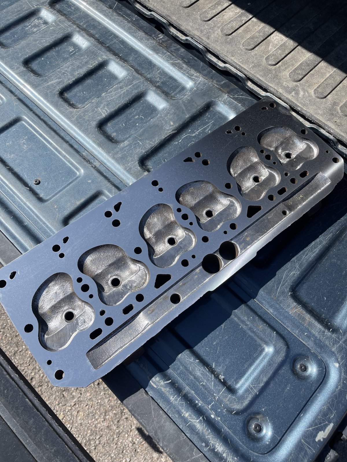

    Got the head back from the machine shop, they removed .065”
    Measured two of the chambers and they are right on 55>55.5cc matching the volume of the stock ‘59 head. So it should maintain the 8.0:1 compression.
    I’m going to do another head to head comparison of valve clearance on every cylinder without a gasket to get a solid comparison.
    If everything is looking good I’ll be ready to ***emble with my new head gasket and ARP studs.

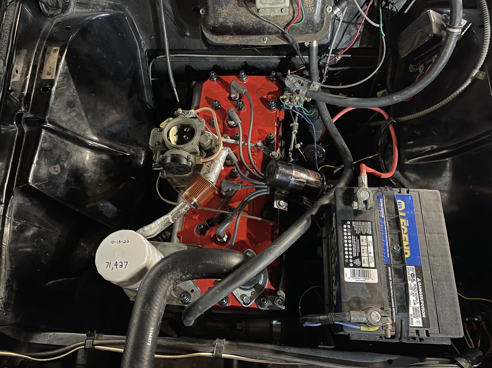

    Got it installed and fired up!
    Too snowy still at 10,000’ to drive it, but dang she sounds great and the throttle response is off the charts!
    Can’t wait for dry roads so I can take her out.
