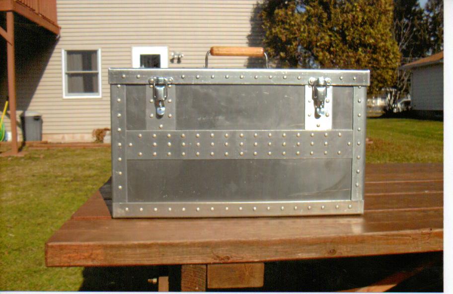

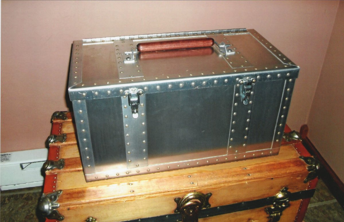

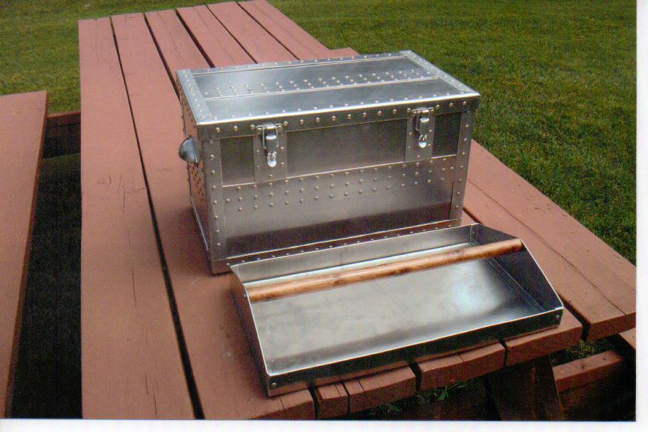

    here are some battery boxes and tool boxes I made for guys on here,my stuff is for sale in the cl***ified in miscellaneous section. Thanks Mike alum toolbox 2.jpg foz box 003.jpg new tool box 3.JPG toolbox12.jpg coffin 2.jpg toolbox12.jpg coffin 2.jpg

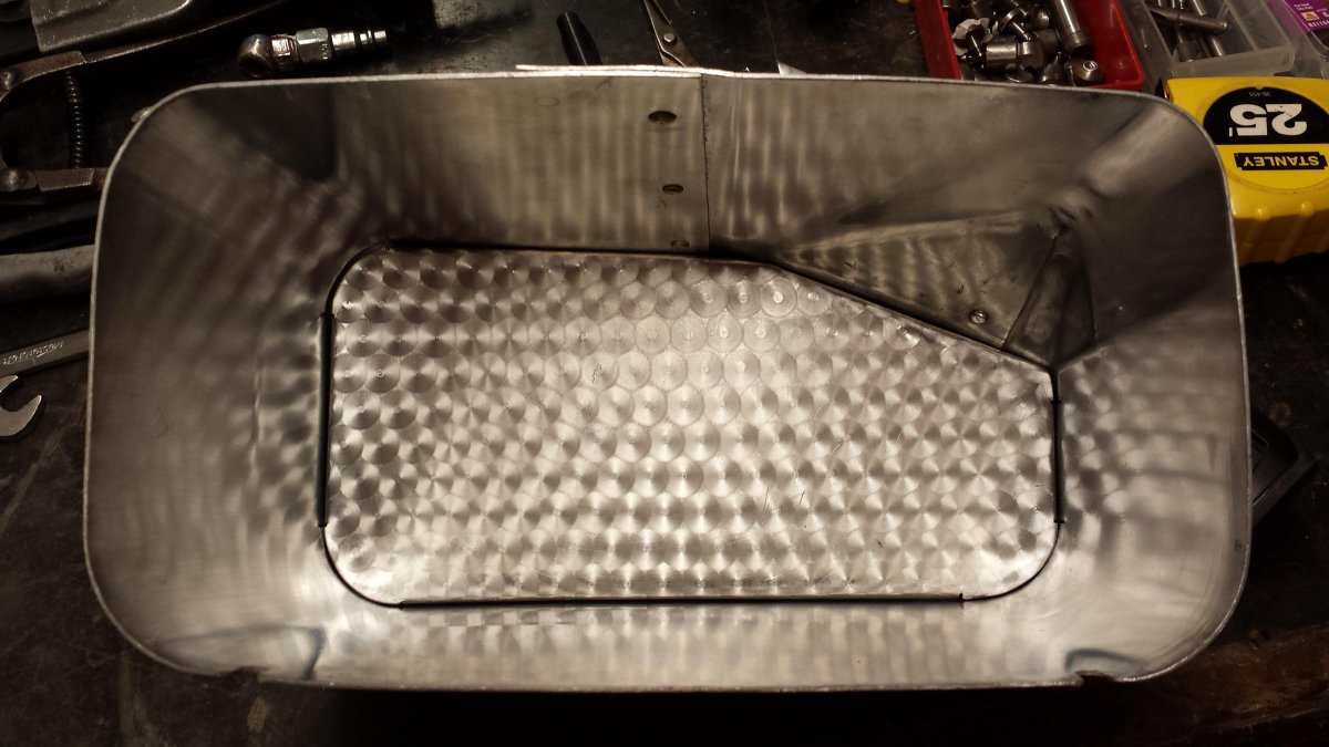

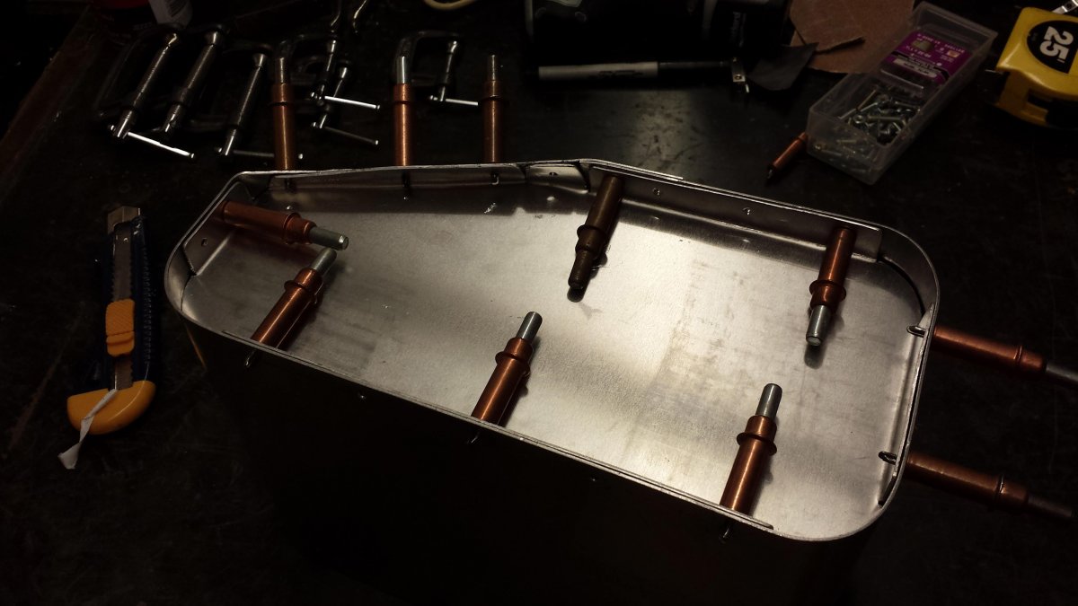

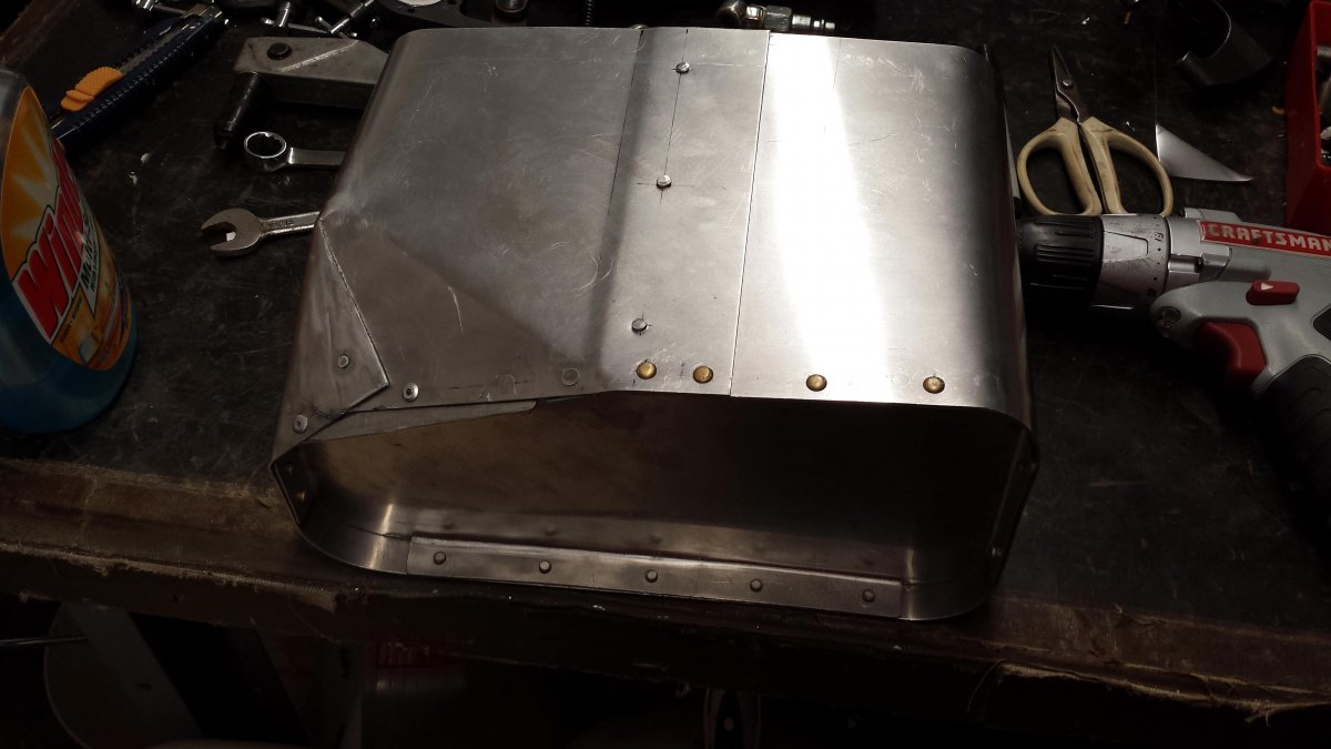

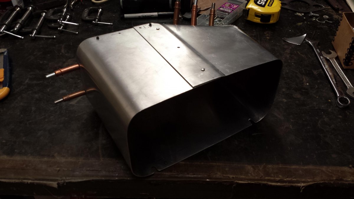

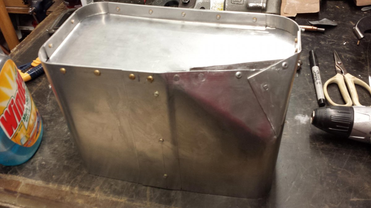

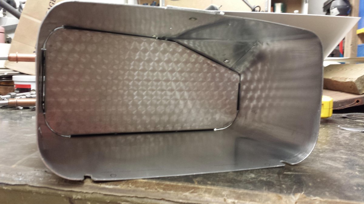

    Working on a glove-box for the 29 to go along with the theme...
    Patterned with bristol board, pencil, scissors and tape
    1) Material: Aluminum sheet (soft)/ Metal Supermarket
    2) Rivets: #30 (1/8") 'A' type/ Aircraft Spruce
    1/8" pop rivets
    Hole Size #30 with 1/8" clecos using cleco pliers
    Holes deburred with 1/4" countersink (best) or 3/16" drill bit (will do)
    3) Cut with Beverly shear, aviation snips, hack saw
    4) finished with file, sandpaper
    5) Bent up with angle iron, square tubing, round tube, mallet, hammer and vise
    6) Rivets hammer bucked and squeezed with pneumatic C squeeze
    7) Engine turn done with burnish tool with pilot removed(Brown Tool)
    on drill press with angle iron clamped to table for fence

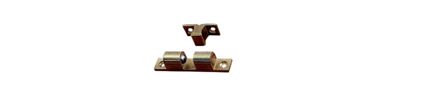

    the latch I will be using
    Still have to get it in but happy with progress so far...
    Dash is 36 ford. Indented corner is to clear 29 tank skin.​

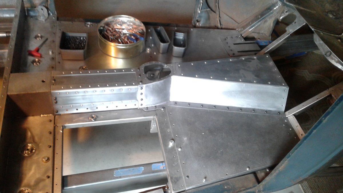

    I will be riveting my 32 frame together including the boxing plates for a factory look.
