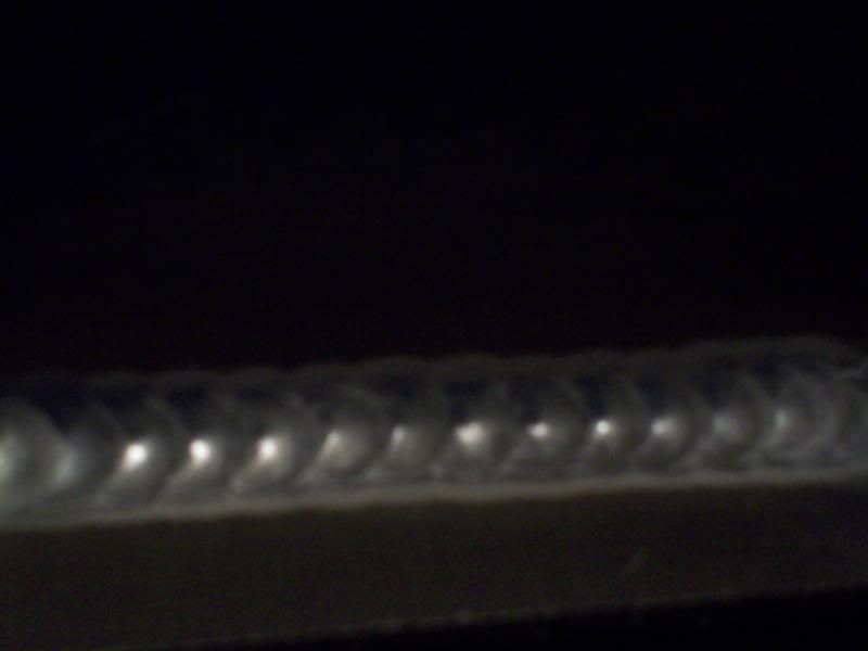

    sorry but its a camra phone
    sheetmetal intake turbo elbow
    alumium

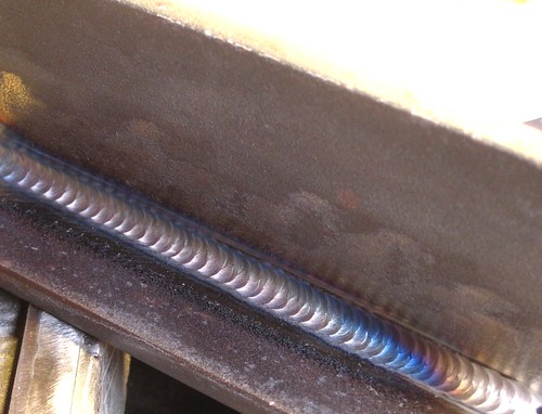

    Since I've been gone from Chrysler, I don't get a ton of practice doing structural/fab stuff. I've been staying pretty busy doing my sculptures, it's a lot of s**** getting welded, some sheet metal but not a lot. Right now I'm working on a '29 Seagrave fire engine...but I was having a hard time getting going on it today. So I found a couple of old coupons that hadn't been welded on both sides and laid a couple lines.
    Here's a mig a did a while back, just snapped a pic of it today.
    Nothing really functional, just trying to stay sharp:eek:

  10. inkmunky
    Joined: Jun 29, 2009
    Posts: 537
    inkmunky
    not to answer for jdutsu but i believe he layed the wire and walked the cup, moving the heat up and down the course of the weld. Check out the first few pages there are some more examples of this technique.

    Yup, that is what it is.
    On a flat fillet joint you can lay the wire, then you get the tungsten stick out and cup size matched up to where you rock the cup back and forth...the edge of the cup stays outside of the actual toe line of the weld, the tungsten stays out of the puddle. There's more than one way to do it, you can mess around with it. You can set it up so you've got a little bit of an angle to start with, then on the back of the motion the torch it almost 90*, or you can even go back to a negative angle on the "back stroke." You can use different motions to make it look different, once you are sure you're getting the penetration. You can use kind of a slanted figure 8, or you can rock it in a half moon, as long as you are keeping an even toe line and the weld profile is staying uniform and within spec.
    On v-joints it's similar, but you'll have the cup edges resting on either side of the groove. Once you get out to the last few p***es and there is no edge to rest the cup on you actually rest the front edge of the cup on the weld, and you use it as a fulcrum. The tungsten stick will be such that you can roll/twist the cup from side to side in a sideways 8 and it will stay out of the puddle.
    Depending on the position, you may have to mess with how you lay the wire. If it's flat or straight up, you can lay it in the center. If it's horizontal or at a funky angle, you'll have to move it so that the weld will stay flat, because gravity is gonna mess with the puddle. On wider cover p***es you may either want to roll the wire from side to side, use two smaller rods, or dip it to make sure you get the metal where you want it.
    As far as what I'm seeing, I watch the puddle and the freeze line, and try to make sure each one stays the same.

    You basically touch the edge of the cup of the tig torch on the metal, and use it as a swivel point for the electrode. On a fillet or a v joint you'll rock it back and forth between the two pieces you're welding, you can kind of see the trail(the zig zag marks on the base metal) the cup is leaving in the marks on this piece:
    Where there is no "wall" to rest your cup, like on the cover p*** of a pipe, you rest the bottom front edge of the cup on the weld itself, and rock/swivel it forward.
