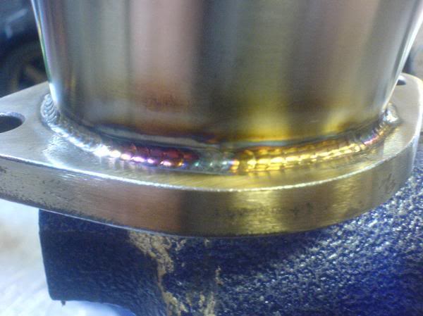

    onlychevrolets
    you see that GOLD weld. Thats a near perfect weld, I mean the temperature is just right, to hot turns it dark gray. thats as pretty as it gets.

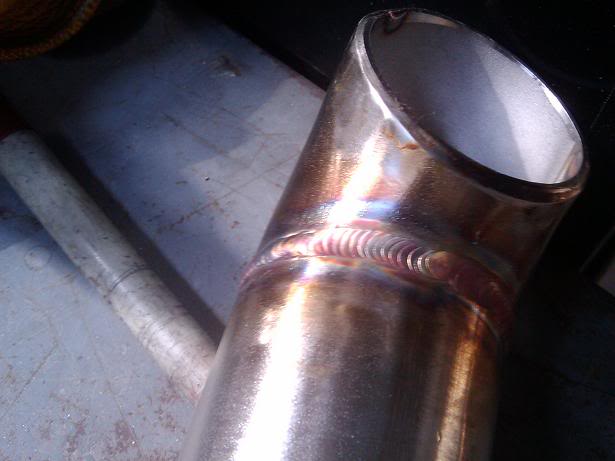

    tee joint
    i teach at a welding school here in western ohio...welds look really good. taught tig now for 21years. the welds to me look like ther were done with a pulser box built into machine ,what it does is goes to a high amperage then the puddle cools and you step ahead a half puddle.this is what gives it a row of dimes look.a lot of guys do this with there foot reastat or foot pedal. makes a real destinctive ripple some guys even go back over there welds to give a nice washed out look. still loooks pretty *****in!!!!!

    from Detroit
    The only time I use pulse now is on stainless or sheetmetal and I crank it up to around 110pps, it helps with the warping and on stainless it gives you a cleaner bead without really effecting the ripple.

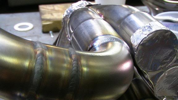

    I dunno if mine would be considered "incredible" but here are a few pics of my work.

    from Atlanta
    I would .... & your "purge system" is a great idea. I've used bicycle tubes but will try the tin-foil trick next time on headers.
