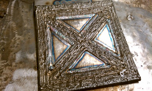

    You know what they say about practice, right? :D Line after line after line after line....
    It might not look like much, it might seem tedious, but it's great practice for torch control and hand/eye coordination.
    I recently got a pretty cool gig, and the last two weeks they had a few of us at a tig cl*** prepping for out of position military spec certifications in aluminum, stainless, and mild steel. I got my 3g and 4g with no backing on 1/8" in all three Friday night, so I'm stoked.
    Most of the time we were using Dynasty 350s, which makes my 200 feel like a toy. But they had me mess around on a Miller Aerowave for a bit, and that's probably the baddest *** tig machine ever made. I didn't use it to a 10th of it's capabilities, but even just the arc control and power is so smooth. And it won't start an arc if you forget to turn on the gas, which is a pretty sick feature. Thursday we were trouble shooting it all morning. For whatever reason I couldn't get a decent bead, no arc control, burnt beads, it was just bad news. My first guess was bad gas, but we went through and messed with everything else first. It turns out it was the gas. They got a shipment in a day or so before and it looks like all 15 bottles were contaminated. It welded mild and aluminum fine(although I was having arc control issues on .040 aluminum, and this is probably why), but the SS looked burnt and bad.
    This is a nice picture of it. Far right is with the bad argon. The middle bead is when we tried a bottle left over from the last shipment, and the far left is the new gas.
    So then I had to take it for a test drive :D
    I guess someone in the night cl*** was trying to show off his knowledge and was explaining to someone else that "this weld was done by hand, and these two were obviously done by a machine" referring to that piece with the three welds on it above. The instructor told him "not exactly" lol
