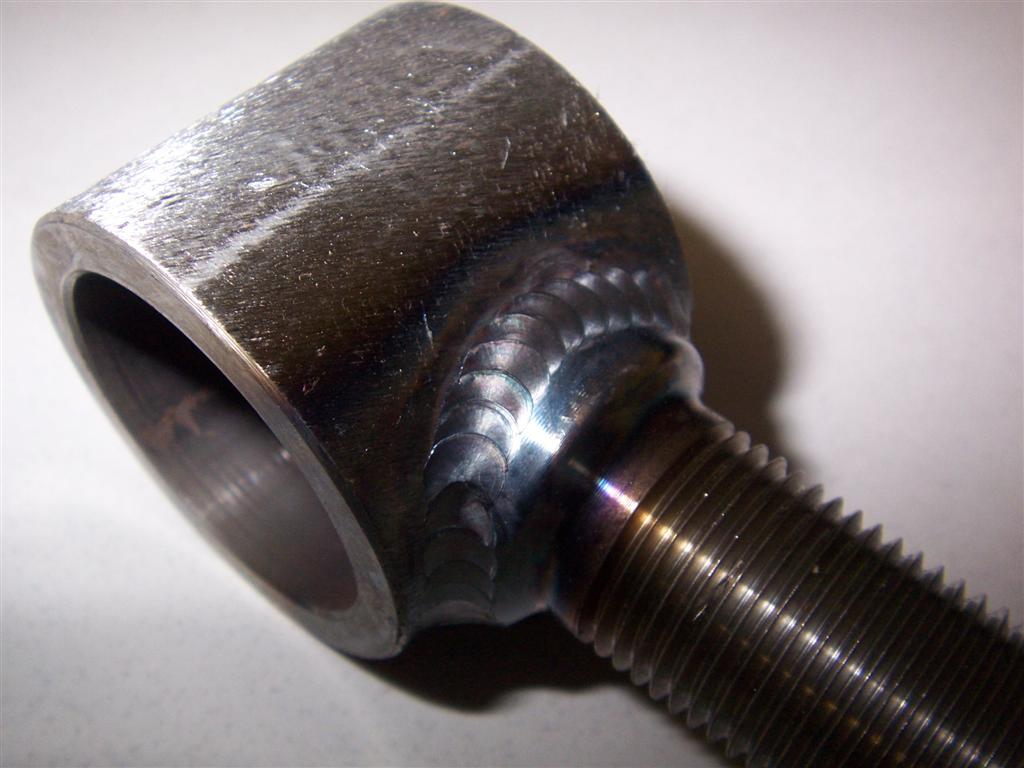

    Josh, you're a welding nut bar. Crazy!
    Lincoln 255 Square Wave (with the digital controls) from something like 15 years ago? I pulse with a foot pedal and a small gas cup.
    These are some recent parts...

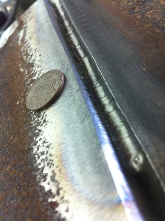

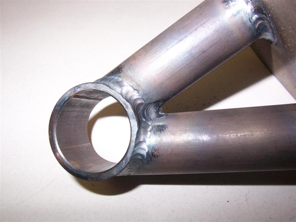

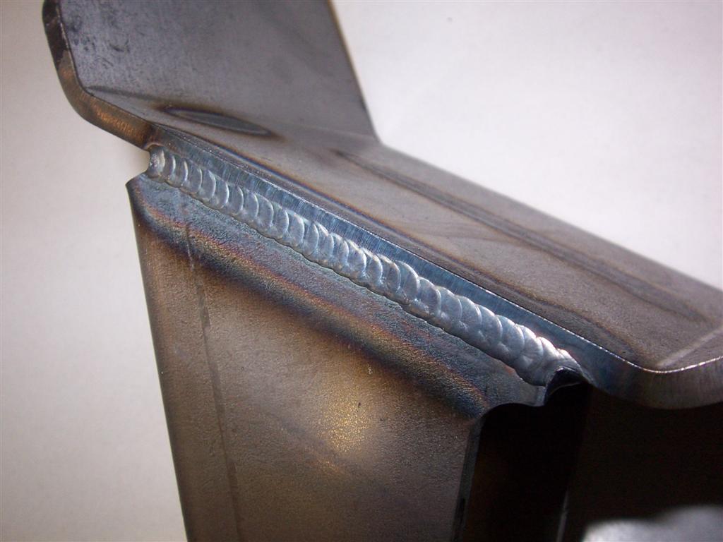

    Not the most incredible in the world, but here are a few brackets I put together for the last car I built. I'm using an old Idealarc TIG 300/300 that was built about 15 years before I was born.

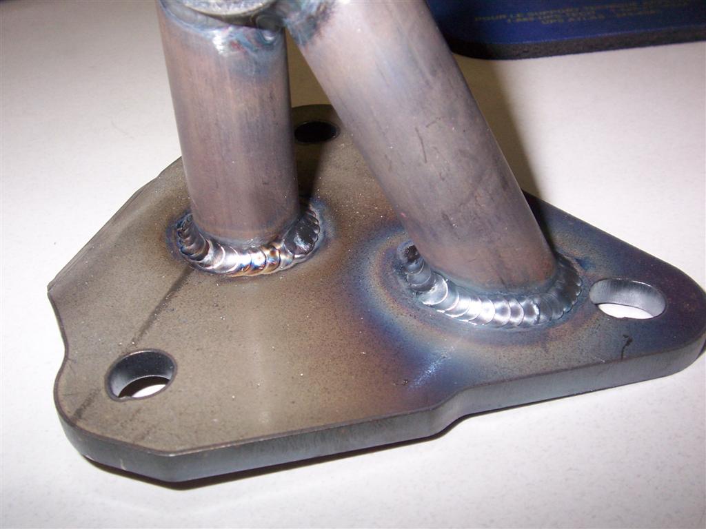

    This is not as elaborate as the stuff Stinkbug just posted (nice work!), but it is hot rod related. These are parts of some motor mounts I made for an unboxed '32 frame with a '57 283.
    I do use a gas lens by the way. I know my stuff isn't perfect...but I try to improve everytime I pick up the torch.

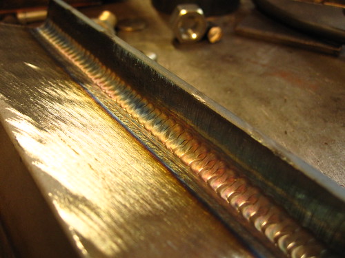

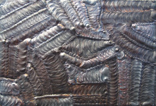

    I can't really post pics of the stuff I do at work...but here is a practice piece I did when I was stressed out last night. How I relax lol

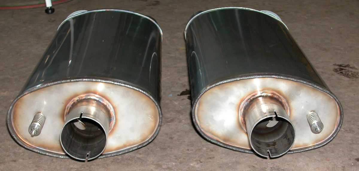

    Having a pal that welds weapon components for a living that also was a professional welder helps when you weld 304 st. st VOE mufflers! Check these out!
    Tom

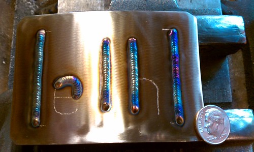

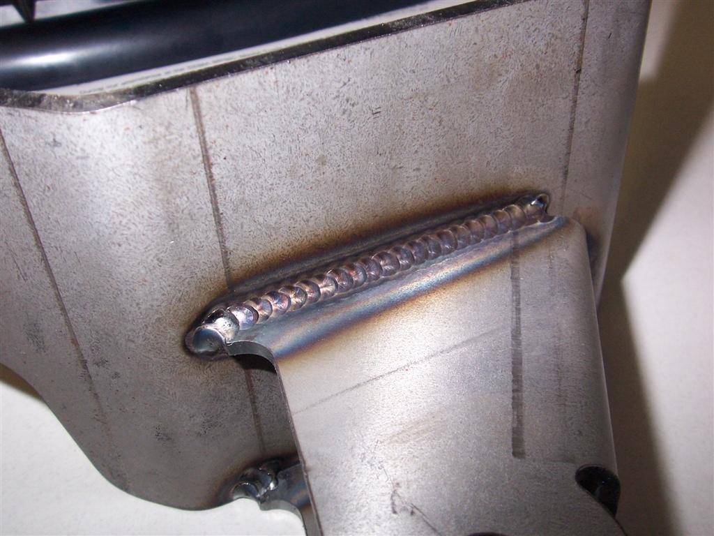

    Here's some aluminum I did today. TIG.

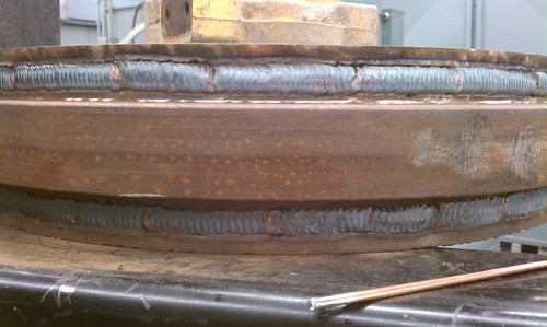

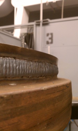

    This is a wheel off a bulldozer track that needed a couple low spots raised.
    I put two 1/8" rods together and did a little free hand weave all the way around on the top and bottom.

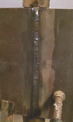

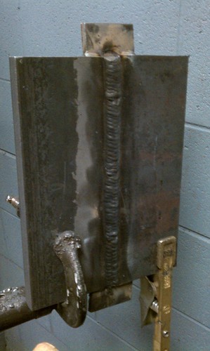

    I think somebody asked about stick welding a while back. Last night I found out my GMAW-P plates p***ed X-ray, so I messed around with this bad boy at school today:
    It's so freaking smooth. I did a 1" thick plate with a K joint using 5/32" 8018 electrodes. It's hard to see in the pic, but the root p*** came through the back side really nicely. I need to get a bigger shop so I can start collecting some of these machines :D

    front finished
    back finished
    Pretty happy with it considering I don't stick weld much. I forgot how much fun it is. Especially compared to spray transfer pulse welding lol

    That looks like the setup for an AWS guided bend test. If it is, shouldn't the edges be beveled?
  30. jdustu
    Joined: Sep 1, 2008
    Posts: 728
    jdustu
    from Detroit
    Those pics ****, but one plate's edge on the front and back was beveled, and then the other plate is flat. It's a k joint. Plates were 1" thick, and it was X-rayed not bent. It was mil spec, not AWS, although they are similar....and it p***ed.
