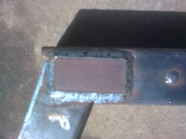

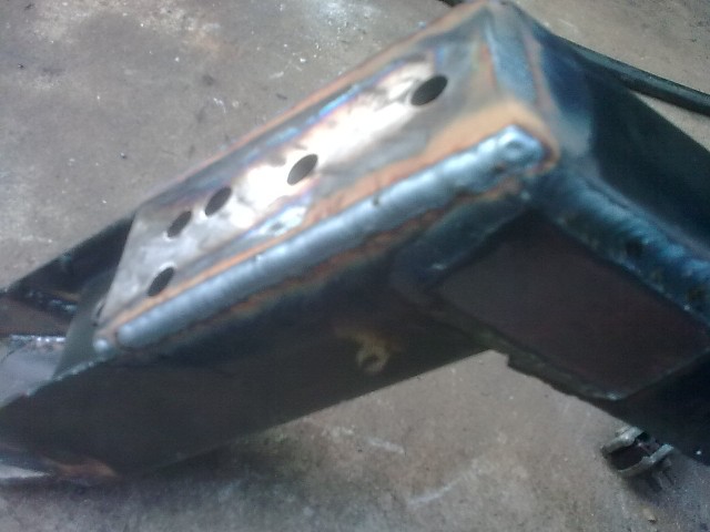

    About the welds. Is that MIG? i'd say TIG, but lateley ive seen Skoty's MIG welds and look as good.
    If mig, could you explain how in hell? Ive tried many diff. settings, but cant seem to make the this happen. It always look like a continuos bead, really tidy, good borders, penetration, and it kinda looks nice, but cant seem to pull this "tack after tack" look.

    It's all tig. I'm doped up on pain meds and getting ready for autorama, I'll try to post a little about the techniques I use next week. There are a few ways to do it. Had a lot of people ask for vids, may do that soon. Welder Series has some nice vids showing how he does his magic.
    Same with mig, every line/ripple you see is a freeze line. Once you can read the puddle, you can really start to manipulate the bead.

    BTW, if i wave making a larger bead i can sorta pull the look, but if i go in a straight line that is a diffrent story. I guess its an estetic thing most. Or does this kind of weldin makes it stronger too? talkin mig.

    Some guys say you don't want to weave, and in some cases they are right. But typically it's all about puddle control...if you don't know what you are doing you'll get the puddle too wet and lose control, or not hot enough and get cold spots. When I did certs for the spray pulse mig, it says on the procedure not to weave past a certain width for that reason. The instructor told me to try weaving if I'd like, so I did multiple plates both ways. They all p***ed X-ray.
    Doing typically short arc mig I like to have the heat "normal", wire speed a little "slow" and then I move relatively slow. I'm not rushing, and I'm making sure the puddle is hot and penetrating.

    yah this is how i do it normally.
    Ive attached a couple of pics of beads ive done last week, sorry for the ****py quality but its the only camera i have, as you can see is "clean", but i cant manage to make the single drops show drastically like on yours or Skoty's.
    Any idea what im doin wrong?

    The "drop" look comes from the freeze line of the puddle. You can do it a few ways. You can run half moons or circular motions, or you can move-pause-move. I like to move-pause, but I'm also moving the torch a bit to get the bead profile I want. You've got to be careful doing it this way, it's easier to get cold spots than if you're just going straight and steady. But if you can see the puddle and read what it's doing, it shouldnt be an issue.
    When I say root in that instance, it's more of a first p***. It was gonna be a larger weld, so to insure penetration and fusion where the two plates come together I ran a tighter, smaller bead first. I think technically the "root" is where the bottom of the weld meets the base metal, I usually use it when referring to the weld in a multi-p*** weld that digs into the base metals.
    It is hard to see in those pics, but I'd say your movements are too tight to get that "look". Nothing wrong with that, they look fine. If you want the dime look, exaggerate the movements a little more, and make sure each move is even.
