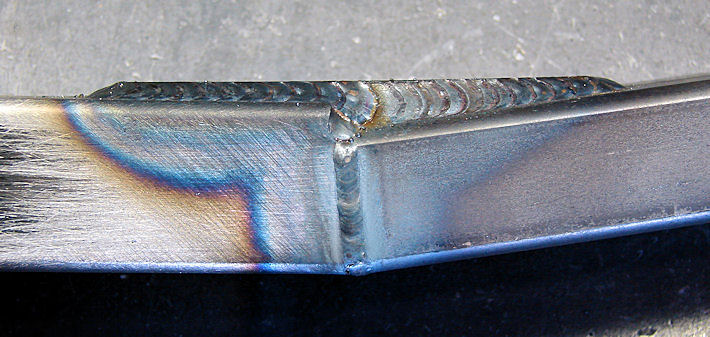

    Someone asked the other day to see some thin stuff, this was the thinnest I could dig up at the time. .055. I need to get in for some gl***es, I have a hard time seeing the puddle at this size...
    [​IMG] [​IMG] [​IMG]

    jdustu that really is an incredible weld , id need a magnifying lense to see the puddle , great weld ,

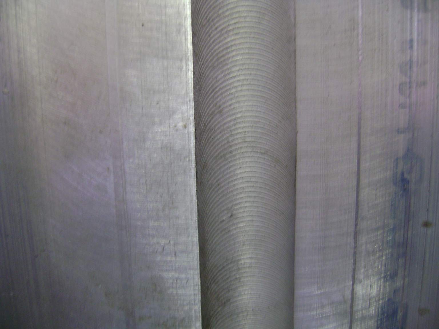

    Usinng 50-50 Helium Argon is great when you are welding thicker materials. Helium increases the heat input. When welding thin aluminum use 100% argon or 90 - 10 Argon Helium (I prefer 100% argon)
    The white stuff is a byproduct of the cleaning action of using AC. You will always have it and it is not a bad thing. It is do to the oxide that is present in all aluminum even after thorough cleaning.
    The oxide layer on aluminum forms in milliseconds, so even after a good cleaning it comes back immediately in a thin layer, think .0001 micrometers but it is still there, it will get thicker the longer it sits. 6061 will for oxide very fast.
    MIL-STD 248 requires that welding be performed within 8 hours of cleaning, sometimes 4 depending on the alloy. At our shop we weld within 6 or 7 minutes of cleaning.
    Best semi mechanical cleaning process is a red scotchbrite on a grinder followed by a wipe with denatured alcohol.
    You can also chemically clean sodium hydroxide, followed by and acid wash followed by a baking soda rinse followed by a clean water rinse but it is messy and a pain.
    Here is one of our **** welds on 5083 H111

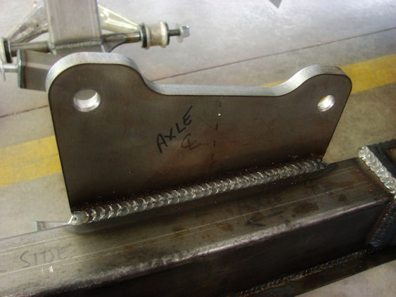

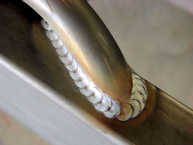

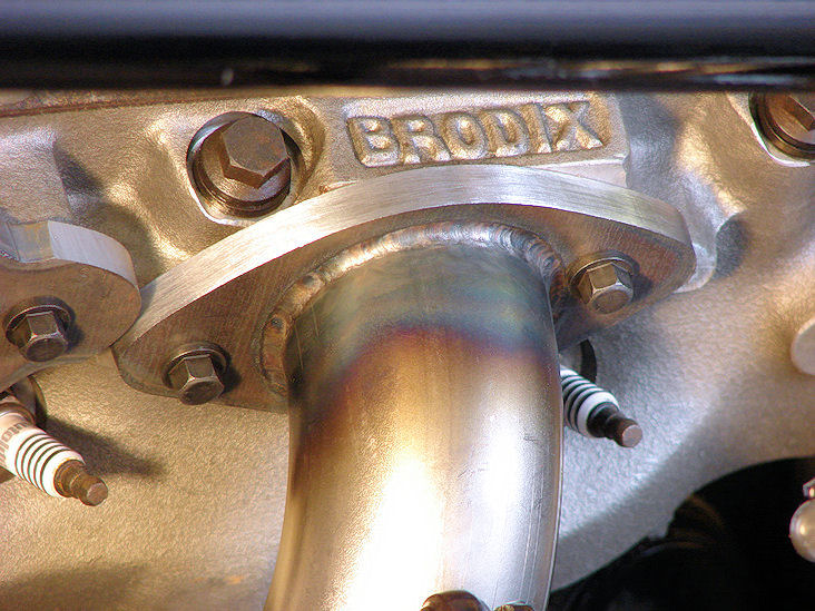

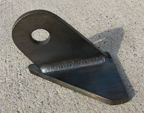

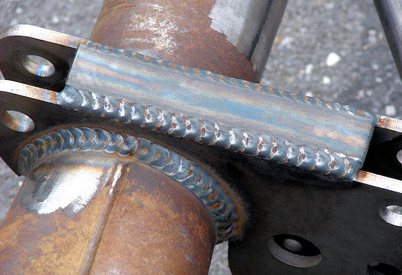

    Welds by 1320 Speed & Kustom ... Thanks for looking!

    How do you find the strength of the mig welds?
    I know it looks good but to me i just think the weld would be weaker when you overlap spot welds with a mig welder allowing the weld to slightly cool between spots and not be as stronger as a straight run.
    Do i make sense? anyone else have an opinion.

    ^^ that is a seriously nice bead. its not a s***ch job. btw, it wouldnt make sense on material as thick as that.
    S***chin is for sheetmetal to avoid heat build up. whos done that btw? real nice.
    found out who did it, previous page 1320 something.

  26. looks cool, but to me its not right or strong. I've seen this type of weld done on panel work,,ground down ready to bondy over,,,but light visable through the spots !!!!
    Shrapnel :cool:

    ^^^ this type of weldin is for frames or thick walled steel.
    You are referin to s***chin, badly done too apparently. anybody grindin a bead on a frame is a hack. unless its a showcar that doesnt get driven.

    that is absolutely for looks only, not strength, see the little dimple in the middle of each puddle, he's pulsing his MIG instead of a good consistant bead, I am against this on any sort of structural weld.

    I see this done in aluminum also, the beads look good but you can clearly see its a series of weld "dots" stacked on top of each other. Kindof bugs me because everybody thinks its an awesome weld.
