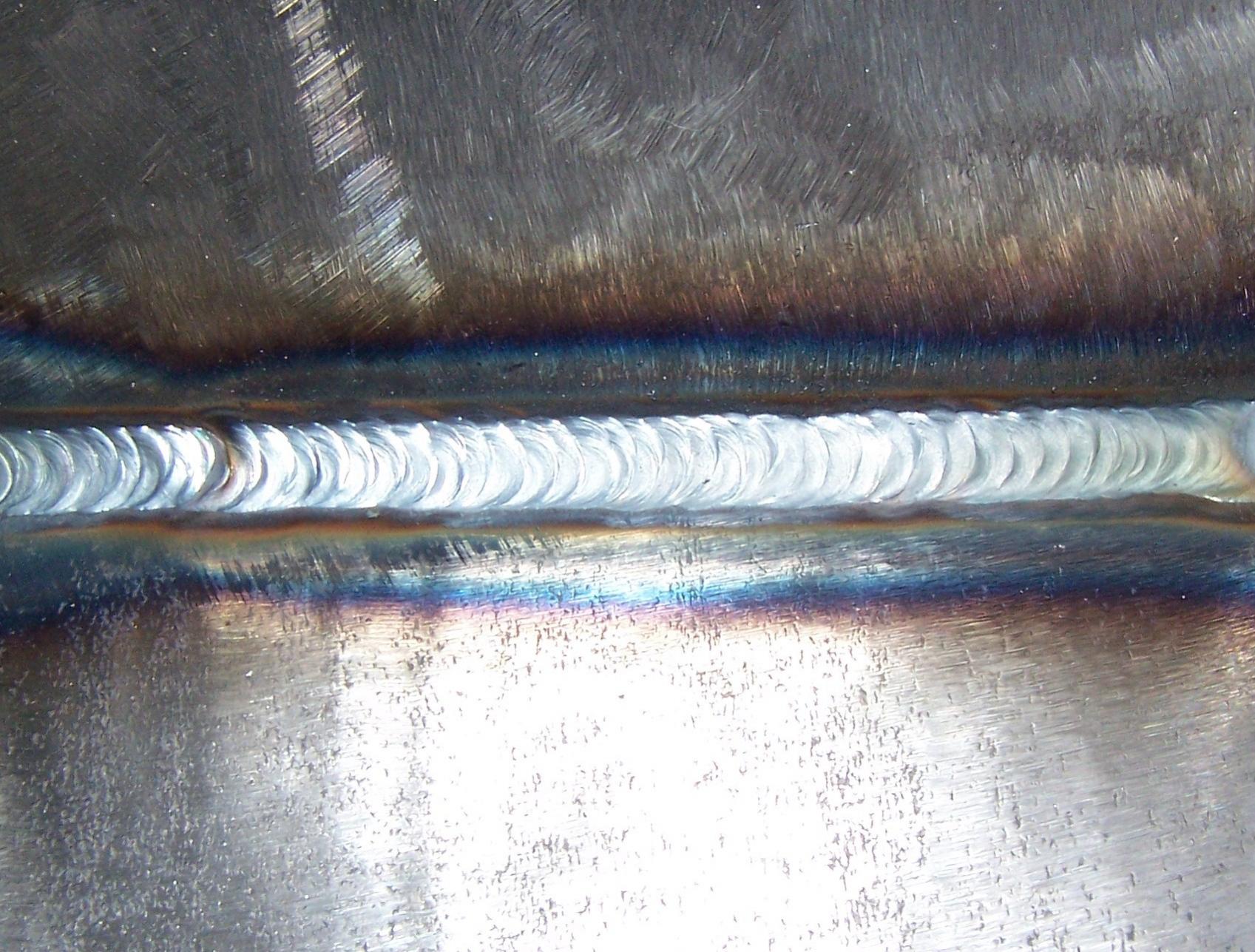

    You'll typically get a more "defined" dime look on aluminum, even without using any sort of "pulse." It freezes so quickly.
    I'll occasionally use a slight pedal pulse when tigging al or ms, it's all about reading the puddle. If you know what you're doing there aren't going to be cold spots.
    You can get a similar appearance using short arc MIG by playing with the motion. If you know how to read the puddle you'll be able to avoid cold spots. Definitely don't want to trigger weld that thicker stuff, you're not going to carry the heat and get the penetration.

    You can also get that pulse look with a mig by going a bit ahead then falling back and hold for a bit, then rush ahead and fall back... etc. Don't take your finger off the trigger. Hard to type, but kind of like going ahead 1.5, back .5, ahead 1.5, back .5 etc. instead of going ahead 1:1.

    Yes it makes sense, but you can look at most of the welds like that and see that these guys are pulsing with the trigger. You can see the divet in the center that is the tell tale sign. I've played with it to see if you can make a good looking (TIG like) weld with a MIG. Suffice to say if you want a TIG look, get a TIG.

    Yup. I've always preferred a smooth mig bead myself, with no pimples or spatter, and all our parts that are MIG'd will always be like that. I think it's a sign of a steady hand, personally.

    Just another trick in the bag. You can cover more area than with a stringer.
