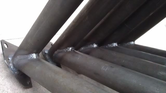

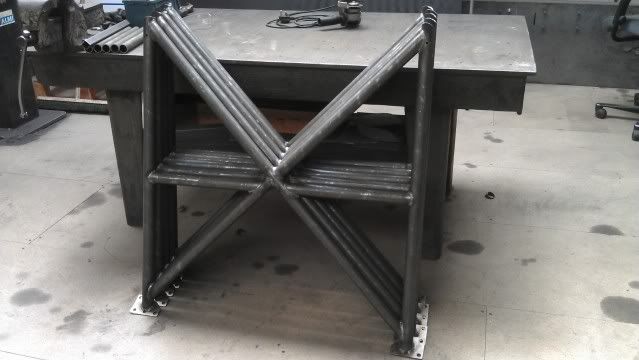

    Ooo almost forgot about this pain in the ***! MIG welding tube... my god what a nightmare. These pictures here are the best out of like 50 welds! :eek:
    They are back stays for a rally cage... From the main hoop to the rear shock towers, if anyone is wondering :)

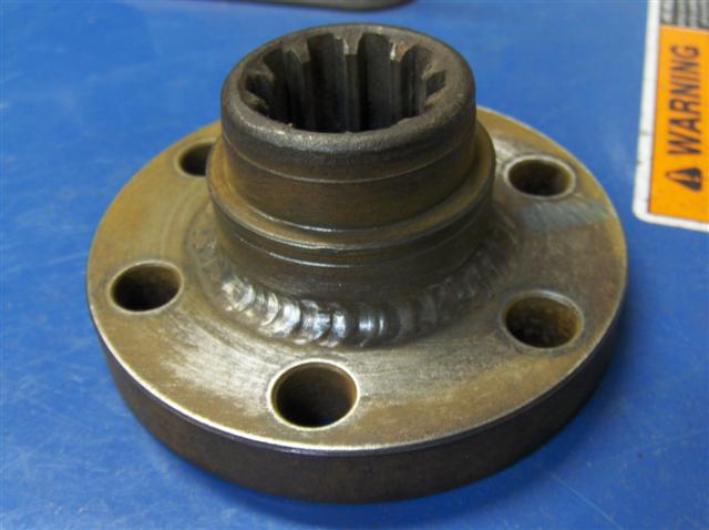

    I can lay some good looking tig welds but have not posted any. Under cut is BS, if you tig weld two pieces of 1/4" together, never is the tig bead a 1/4" thick. A small amount of under cut shows the temp was hot enough, instead of a taller bead with a rolled edge due to being cold....imo:cool:
    Here is a direct drive flange i made a few years ago for a pro four dirt car. I made the flange out of cold plate with a clutch disc center welded in. I would go into the corner at 8000 rpm set with the brakes and stop the engine, and then power out. I ran this for two years without fail, although it was close to failing, the splines are almost torn in half. The weld has minor under cut and was tested in brutal fashion, p***ed with flying colors:eek::)
