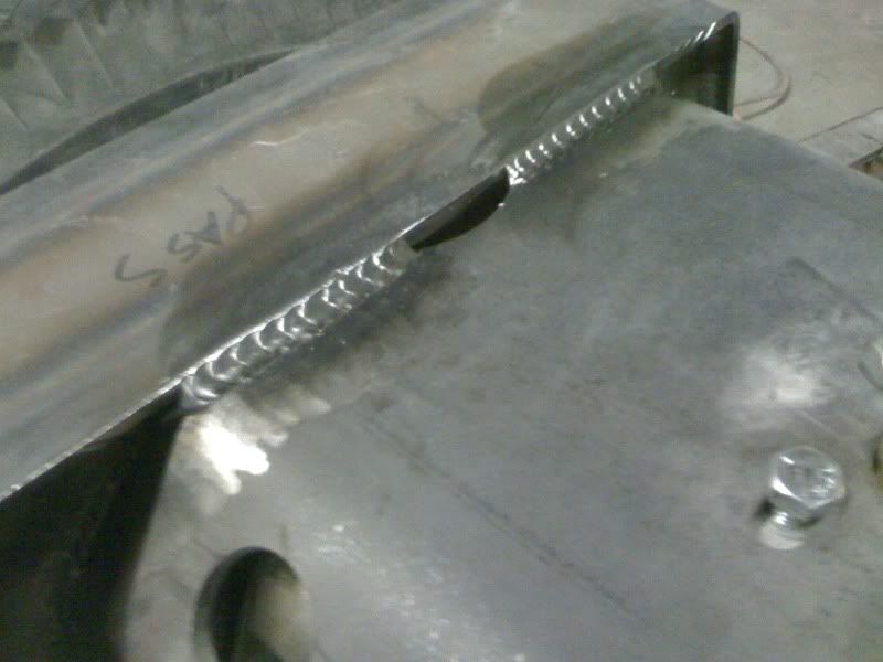

    Hell yes Kid, nice work. Nice pics too. I was messin' around with some similar stuff today, love that quick dab pattern. Hot and fast. Super consistent.

    I wanna see some welds on thin sheet metal, like rust holes... These welds are perfect on here, mine on the other hand are never to pretty. However I don't do a lot of thick metal seam welding.

    Not much incredible about welding rust holes. Weld and metal finish, right? The incredible part is keeping distorting to a minimum and blowing through as little as possible. Cool(and very useful) tricks, but not really "weld ****" material.
    This isn't too thick...
    Here's some thinner stuff. Junk shims taken off a water jet table.
    http://watchtheprettylight.tumblr.com/post/5829063999/thin-junk
    Here's a sculpture I did of a '33 Ford. All s**** sheet metal, some thin galvanized too. Not easy to weld. I weld on a lot of junk for my art stuff.
