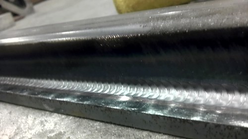

    Some damn good welds in here. Mine dont belong however I'm just looking for some insight in to how i can improve. I've got a Miller Diverson 165 TIG. Ive been welding for a while now but ive only TIG'd for less than 8 hrs. Let me know what you guys think.
    Heres some of my practice work...
    Thanks
    Justin

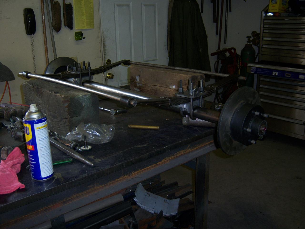

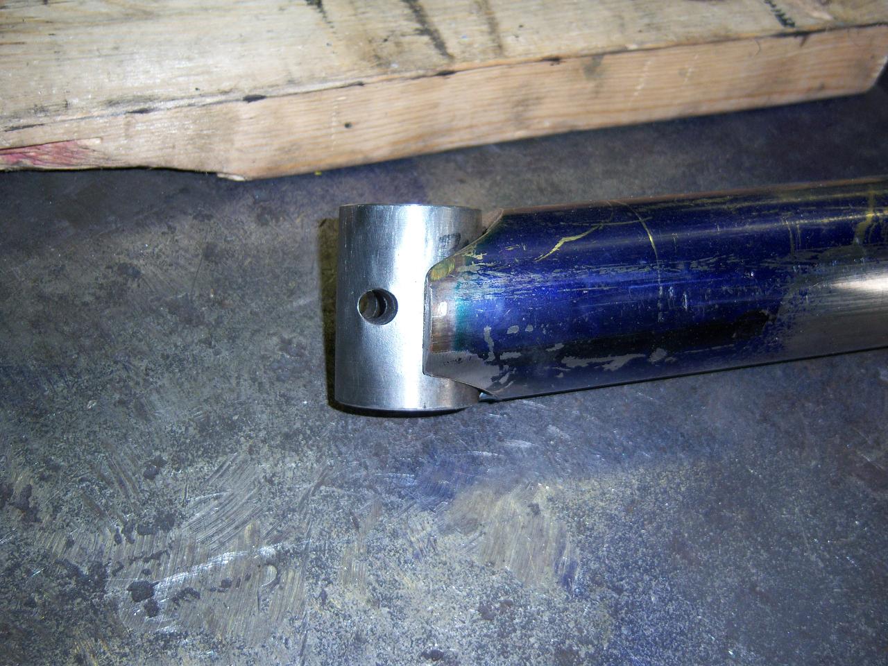

    Building the straight axle for my Willys truck today. Spindle boss before & after. I got too many projects, need to stay focused:eek:
    John

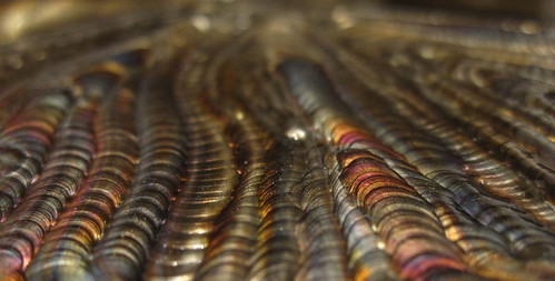

    Here's some of my stuff , just started with tig a few weeks ago; I'm hooked.
