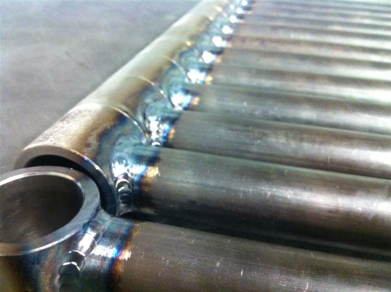

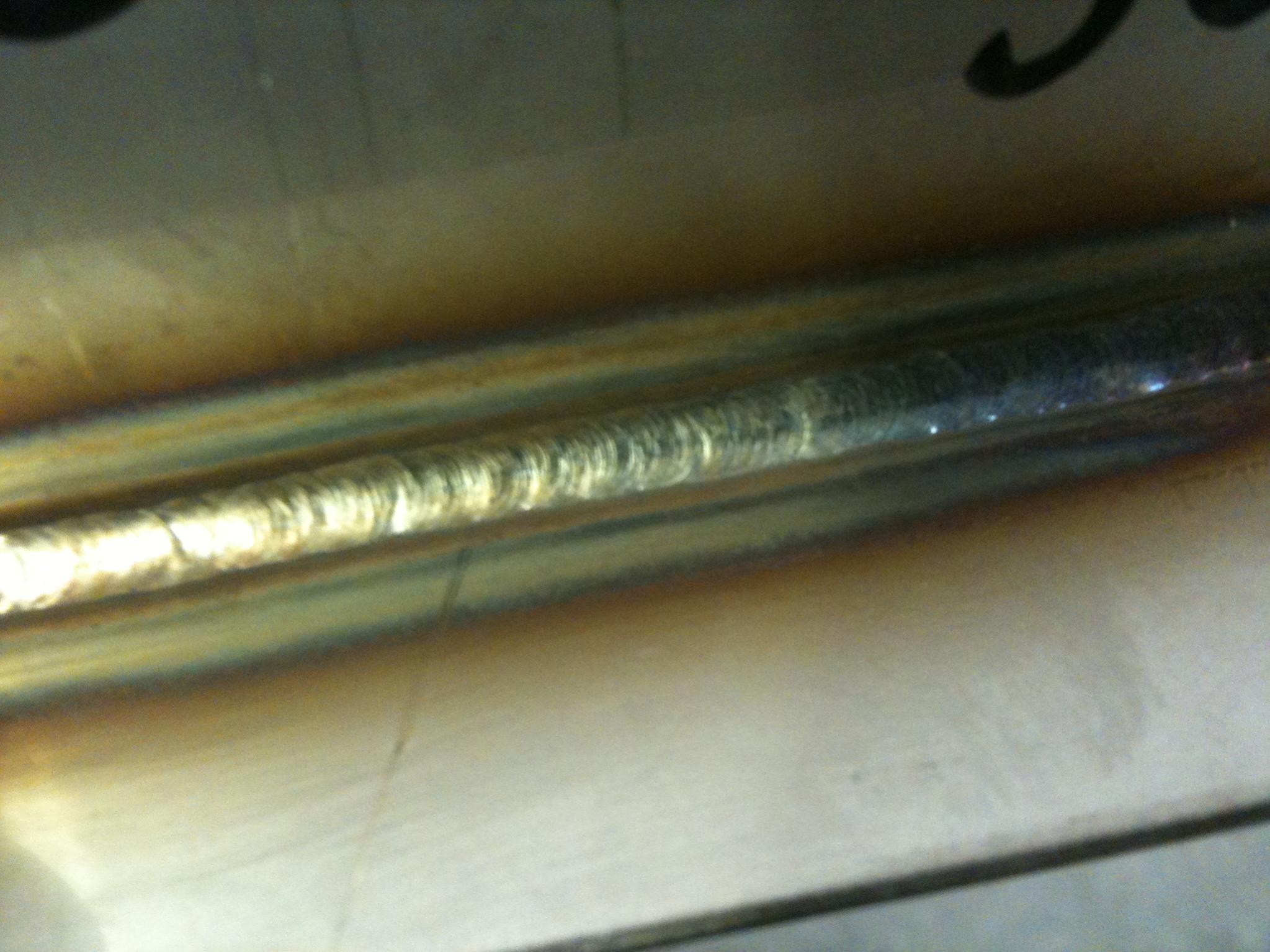

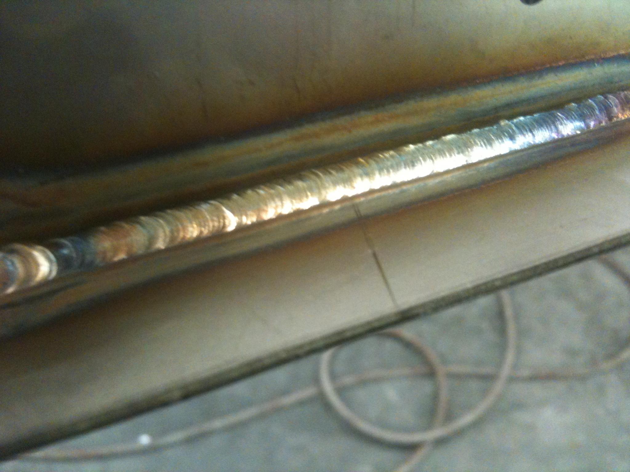

    3/16 Aluminum?
  7. Cuda340
    Joined: Oct 7, 2011
    Posts: 59
    Cuda340

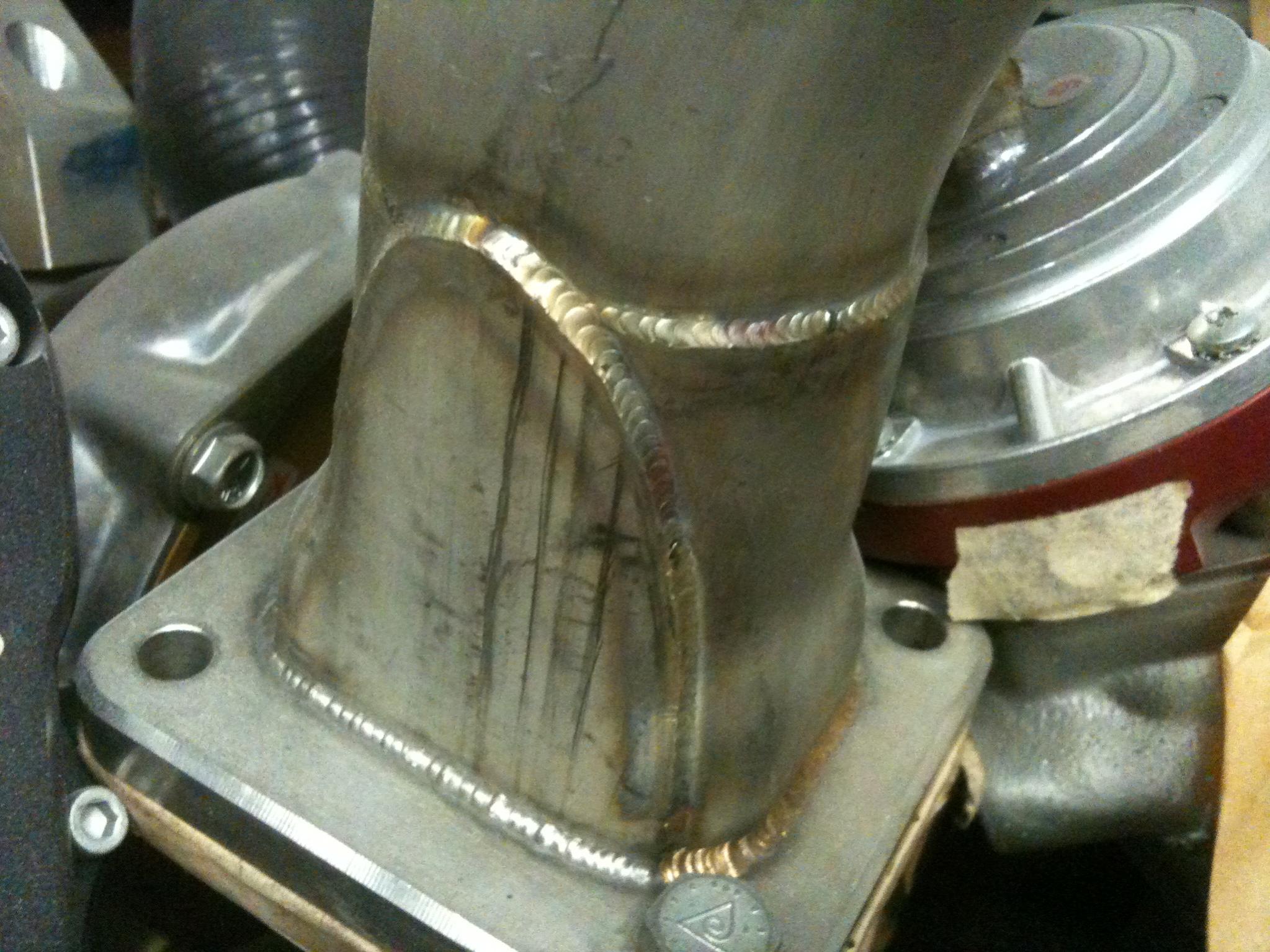

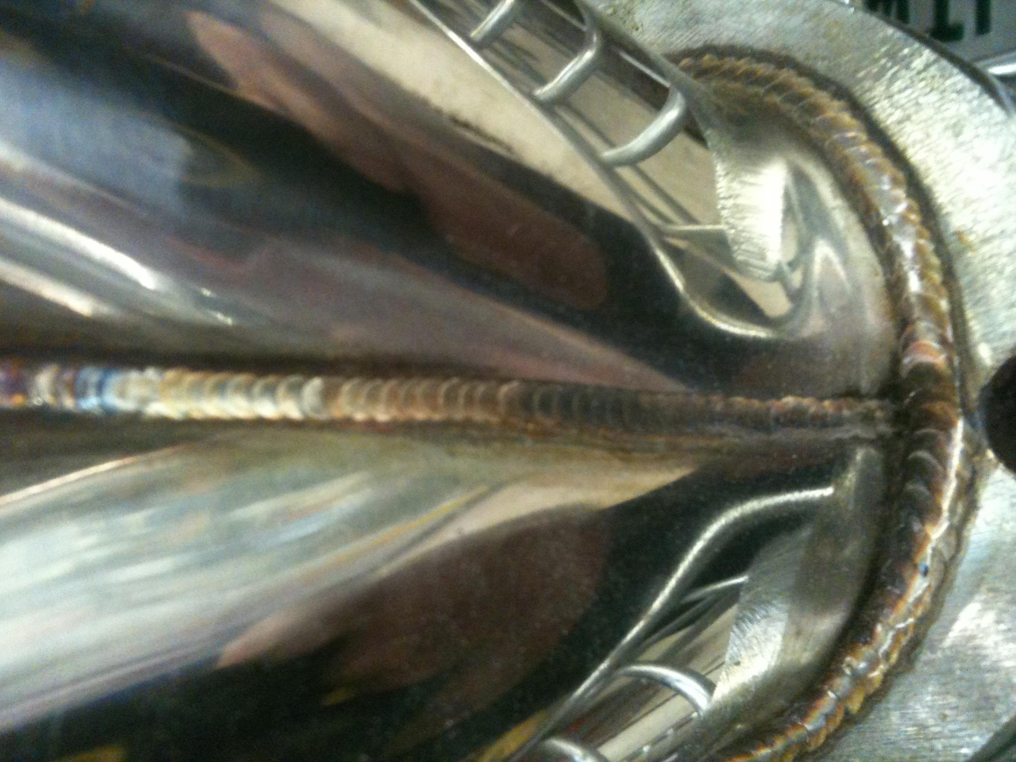

    321 stainless I did for a turbo system. Silicon Bronze on the flange. 304 stainless channel.
    I don't use the pulse feature and I'm getting old, so my aluminum is not as good as it used to be. Row of dimes and then someone throws in a nickel!!

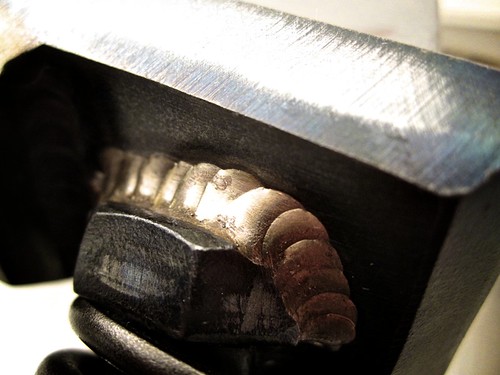

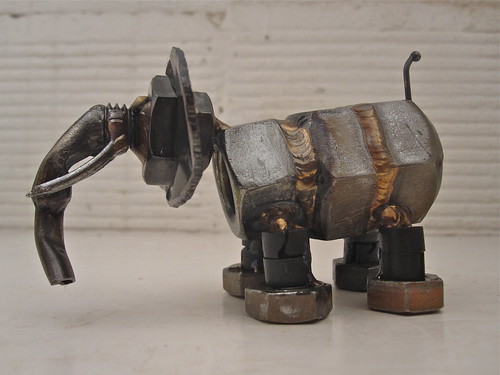

    I use silicon bronze a lot on my sculptures, it's so versatile. More of an "electric braze" than a weld, I dig it 'cuz I can join dissimilar metals and weld on zinc coated nuts/bolts without it popping(the base metal doesn't get hot enough to). Plus I dig the color contrast.
    Metal Elephant Sculpture by Brown Dog Welding, on Flickr

    A couple tiny welds on the latest piece:
    Berzerker, Robot Sculpture by Brown Dog Welding, on Flickr

    Those are super cool sculptures!! Love the last one. I use silicone bronze on the outside of the flanges for a little support that will give. Stainless headers move around a ton when hot and anything else would crack. I do weld the inside with 321.

    Edit: Would you run into problems with the bronze filler if you were to hang a turbo off it?

    Yes. Turbo's need to be supported. Never let it hang off the end of a header. Cast manifolds are okay because they are beefier. I use support rods with heim joints on either end to carry the weight of the turbo on a header and allow expansion/movement. Silicone bronze is only added to the outside of the flange. The flange is thick and the tube is thin. The expansion difference would crack the tube at the flange if welded on the inside and outside. Weld the inside and silicone bronze or nothing on the outside.
