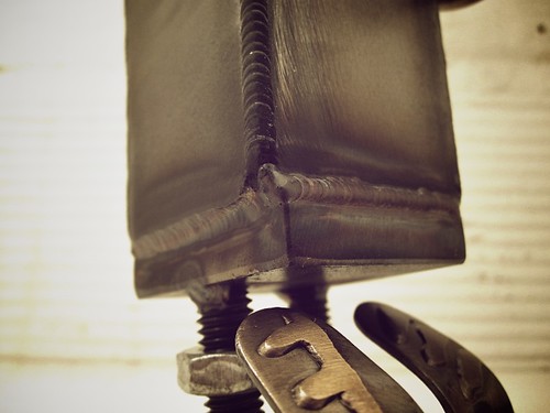

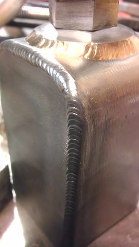

    Here is some lefty action. On the right is right handed right foot on the pedal and left is left hand left foot. Kind of a pain in the *** to support yourself with your right leg and controling your left is even worse lol
    This one has a bit of under bit at the beginning, it's just the way that the laser cuts the tubing and me not using enough filler :) But made for some nice photos I thought?
    Man do I gotta work on my starts and stops... :eek:

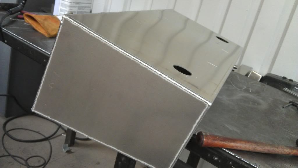

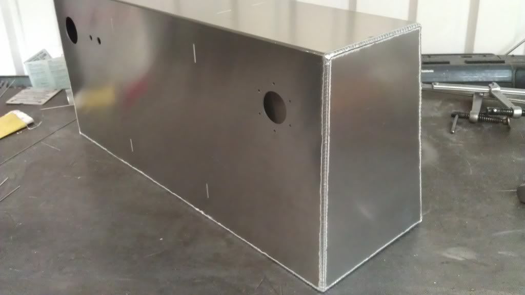

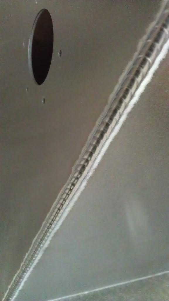

    OOOooo OOOooo Almost forgot... Got to weld some aluminum a few days ago. I like aluminum :)
    Just a couple of fuel cells.

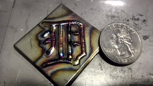

    Old E D on Stainless. .030 wire, 1/16" tungsten.

    Thats nice man, gotta be tough to see what your doing at that point?

    And yeah, my eyes are terrible as it is. Pretty bad double vision. At that point I'm welding by feel as much as sight.
