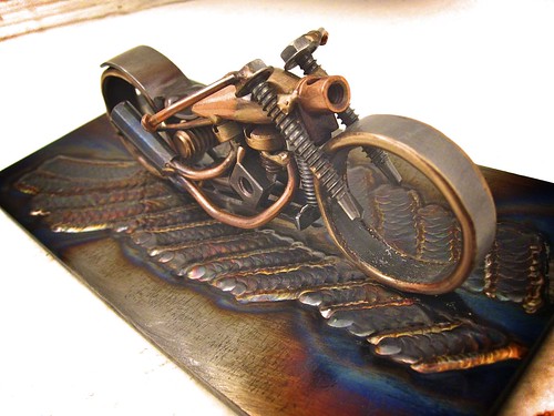

    I made a base for my latest motorcycle piece.
    Anyone gonna be at the Detroit Autorama this weekend? Stop by and say hi, I'll be in the Artist's Alley in the ba*****t.
