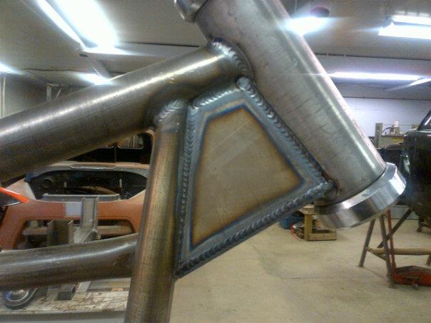

    This is the kind of weld that I would like to know more about. I,m not a pro Tig welder by no means but can handle my own on 16ga. to 22ga. just fine. I would like to know the process of welding 1/4" to 1/4" with this style of a weld. Tungston size, weld rod size, heat setting and etc. would be helpfull. I can weld 1/4" but does not look like the one pictured[​IMG]
  30. deto
    Joined: Jun 26, 2010
    Posts: 2,619
    deto
    I laid down some sweet beads at work today and didn't take a pic.
    As far as the picture above does anybody know what technique it takes to have the weld net be straight across the top and bottom as opposed to having a slight amount of scallop to it?
