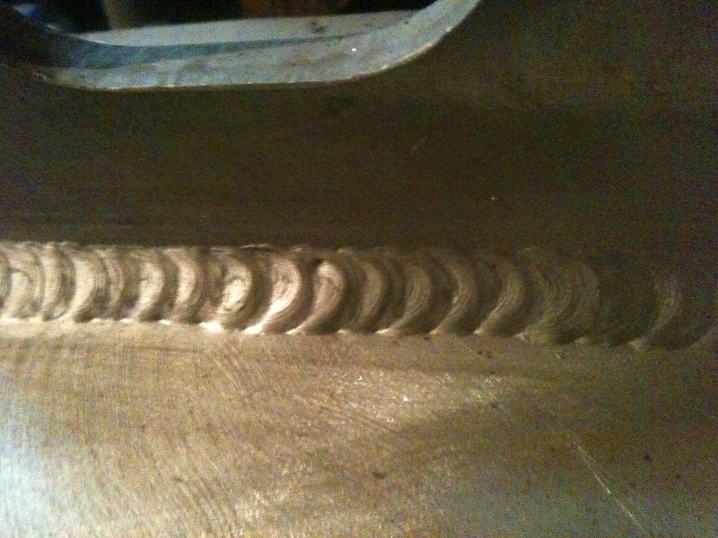

    I love tig and have a pulse feature but I don't use it. I lay a bead down similar to what Sniffn is referring to. ImageUploadedByTapatalk1338752137.182004.jpg
    Not my best bead, by any means, but it does the job and then some.

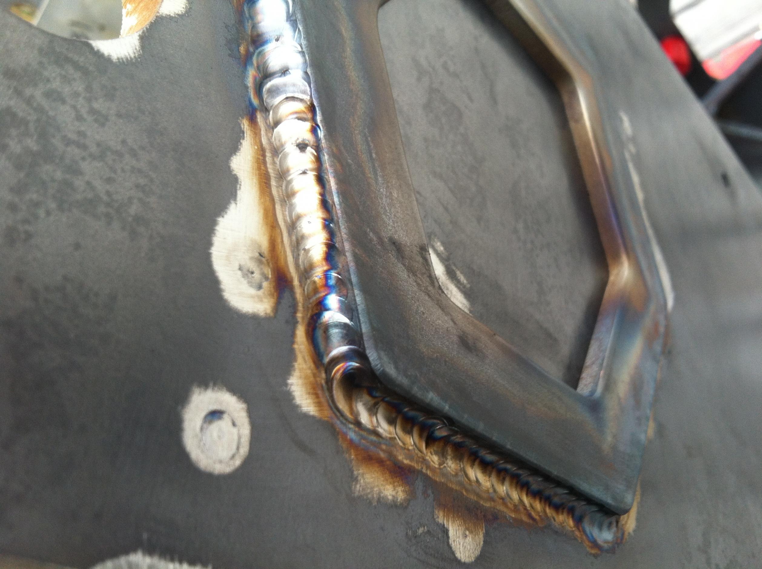

    OK cool. Thats what I figured. Here is me welding a 10g ring to 1/4" thick hot rolled using the pulsing method. Got a little under cut but I had it up on the welding table. I should have just climbed up to get a better angle on it.
