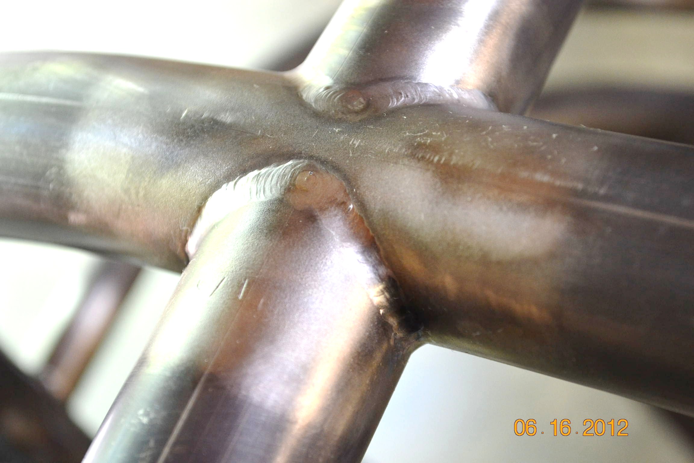

    Ok here are the welds at the top of my cage on my new FED frame--what ya'll think? Will I live if it wrecks?
  2. deto
    Joined: Jun 26, 2010
    Posts: 2,619
    deto
    Its a little under cut... but you will live. otherwise good job!
  3. deto
    Posts: 2,619
    deto
    or it could be an optical illusion. but the area directly facing the camera looks like it could have used a little filler.

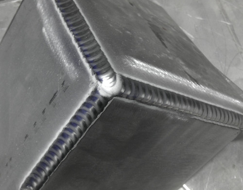

    so... I quit being stubborn and finally tried helium on aluminum. HOLY ****. I was running about 40% less amps and getting better penetration and a better bead. That is 1/4 plate. I was trying all different techniques to feeding the rod. This was a bunch of quick feeds. Not the best by any means but not too bad either. I hadn't welded aluminum in over a month...

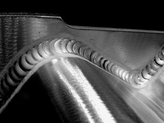

    5/32" 6061, 4043 filler, Dynasty 350, lap.

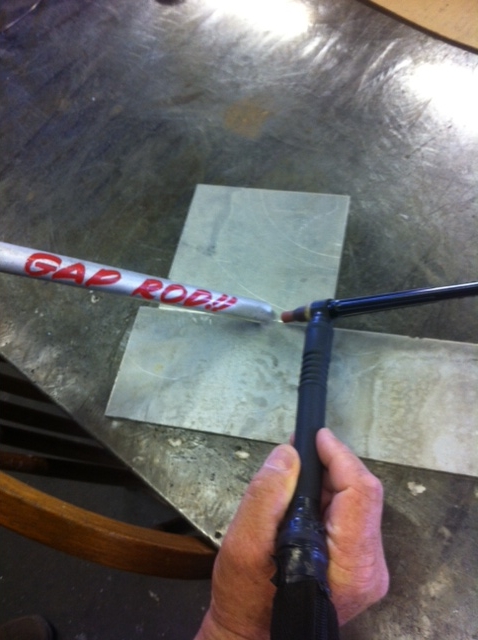

    As a long time welder I can say there are some beautiful welds done by great craftsmen. A long time ago my neighbor was a painter named Tom Stratton. He watched me weld blocks and cylinder head for local racers. He asked how I would fill some of the holes that connecting rods would put in blocks My responce was GAP ROD. Well Tom got a piece of round stock and gave this to me. It still sits in my office...

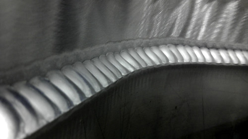

    Aluminum fillets
    practice practice practice practice
