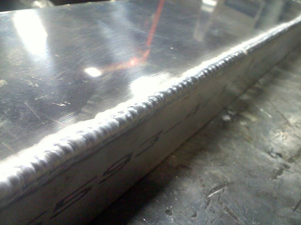

    Right on! My original idea(Which I think I'll still try sometime) was actually a "patchwork" look. Exposed welds are gonna be a big part of this bike. I practiced my **** welds for a week before doing the tank, wanted to get 100% penetration and welds that looked good! Definitely a challenge for someone who doesn't do this kind of aluminum work with regularity! I definitely appreciate your insight.
    Thanks!
    I feel bad when there's too many posts without pics....here's one I threw up on Instagram earlier(@welder******in if you're on there), close up of the tank.
    Can't wait to get back to this project. #panicattack #weld**** #alooominum #triumph by Brown Dog Welding, on Flickr

    No shame in those weldments!
    I have more people, when doing tanks, that want the larger roll of quarters vs. the smaller dime rows ... maybe it's more "industrial". I don't grind any aluminum tank welds & if it's requested I refuse. I like the patchwork idea. It gives it a more ... fabricated look.
