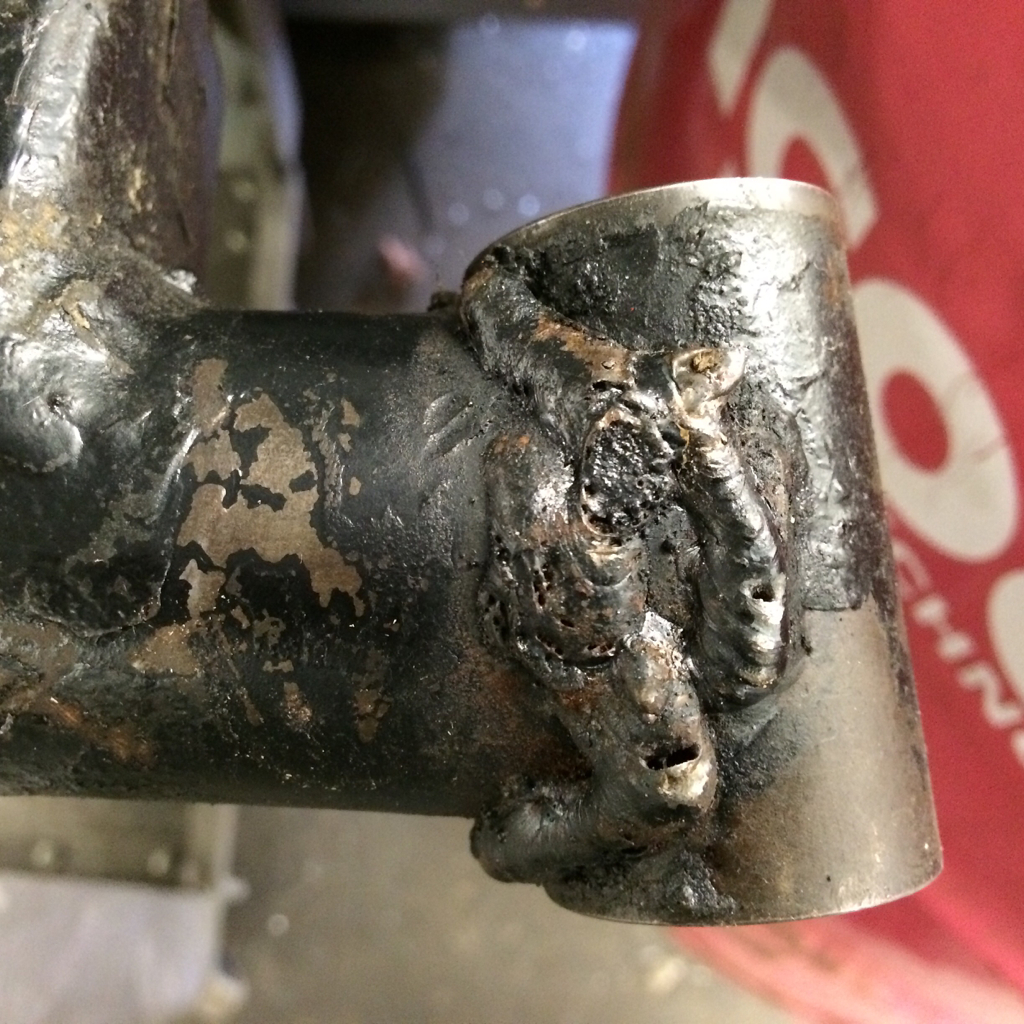

    I don't want to hijack the thread with bad welds.....but I have to share these.
    The repair tag on the Hydraulic cylinder read....."leaks at the port"
    The bottom picture is a 5" pipe.
    mgtstumpy and loudbang like this.

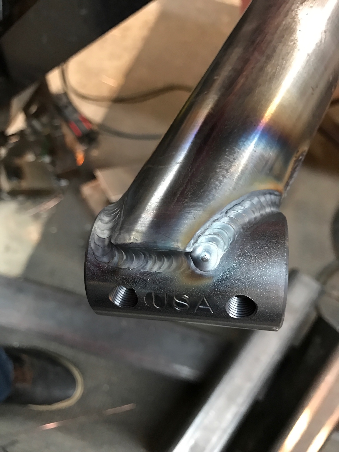

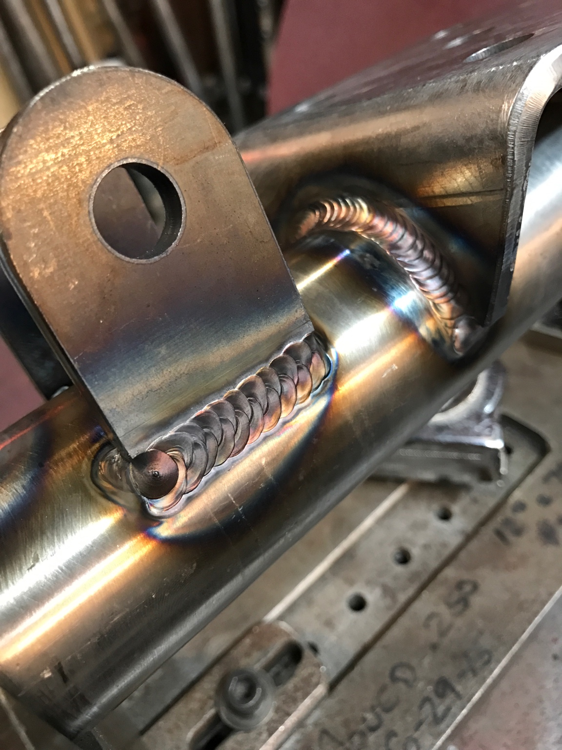

    Here is one from the other week
    ImageUploadedByH.A.M.B.1461181540.716967.jpg ImageUploadedByH.A.M.B.1461181587.502619.jpg
    jazz1, mgtstumpy, jerseyboy and 3 others like this.

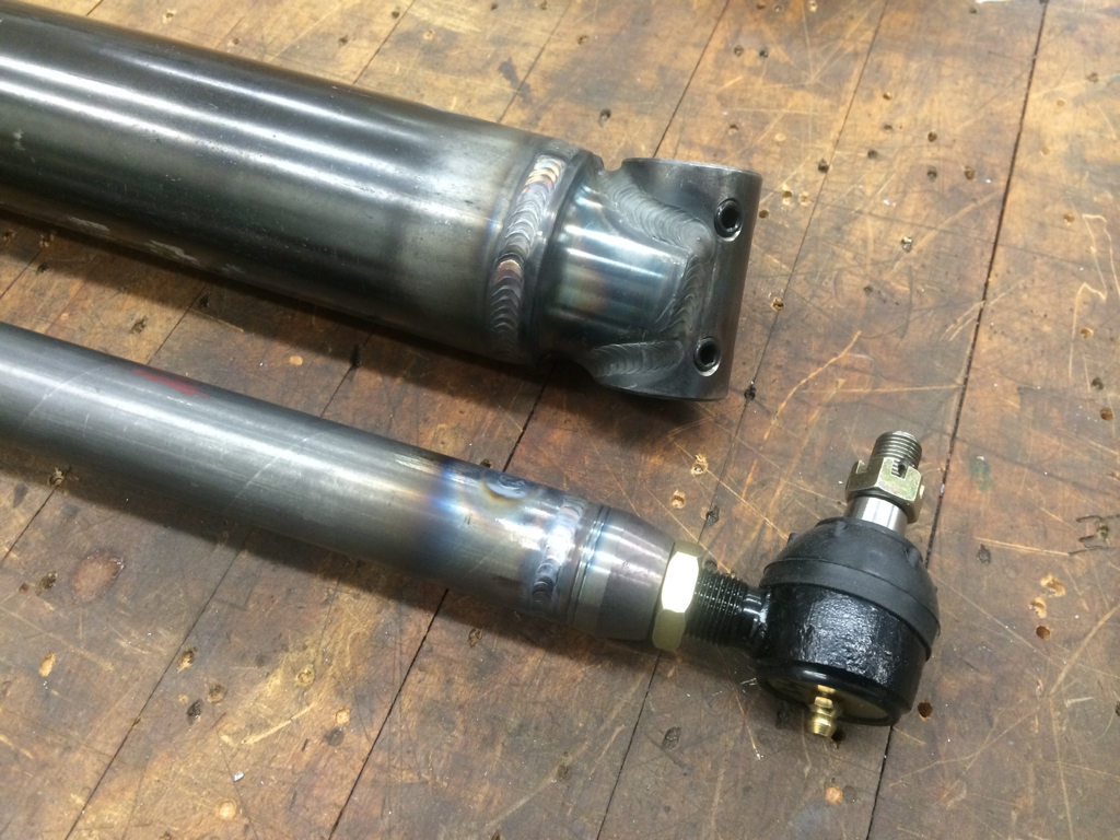

  10. BCCHOPIT

  12. BCCHOPIT

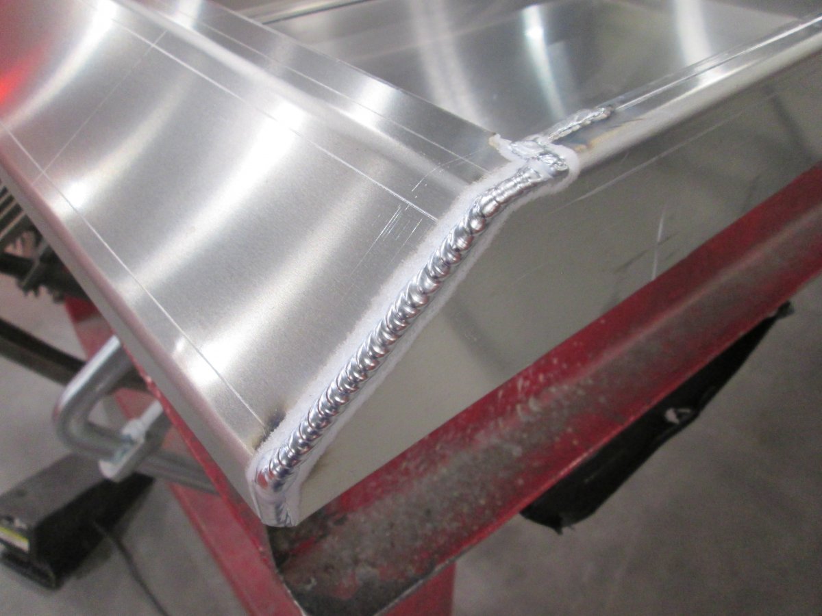

  14. A little more of my aluminum T.I.G. work-
    LBCD, jazz1, loudbang and 3 others like this.

    I am ***uming that trim was stainless about 0.010" thick. What kind of a TIG Machine does it take to be able to do that? Maybe 0.020 tungsten and 5 amps? Can you elaborate on the set up?
    loudbang and 1-SHOT like this.

    Back purging is always helpful when welding Stainless, you get full penetration with out all the nasty stuff on the backside. On trim I usually use a pulse setting about 1 1/2 per second.
    loudbang and simpsonrl like this.

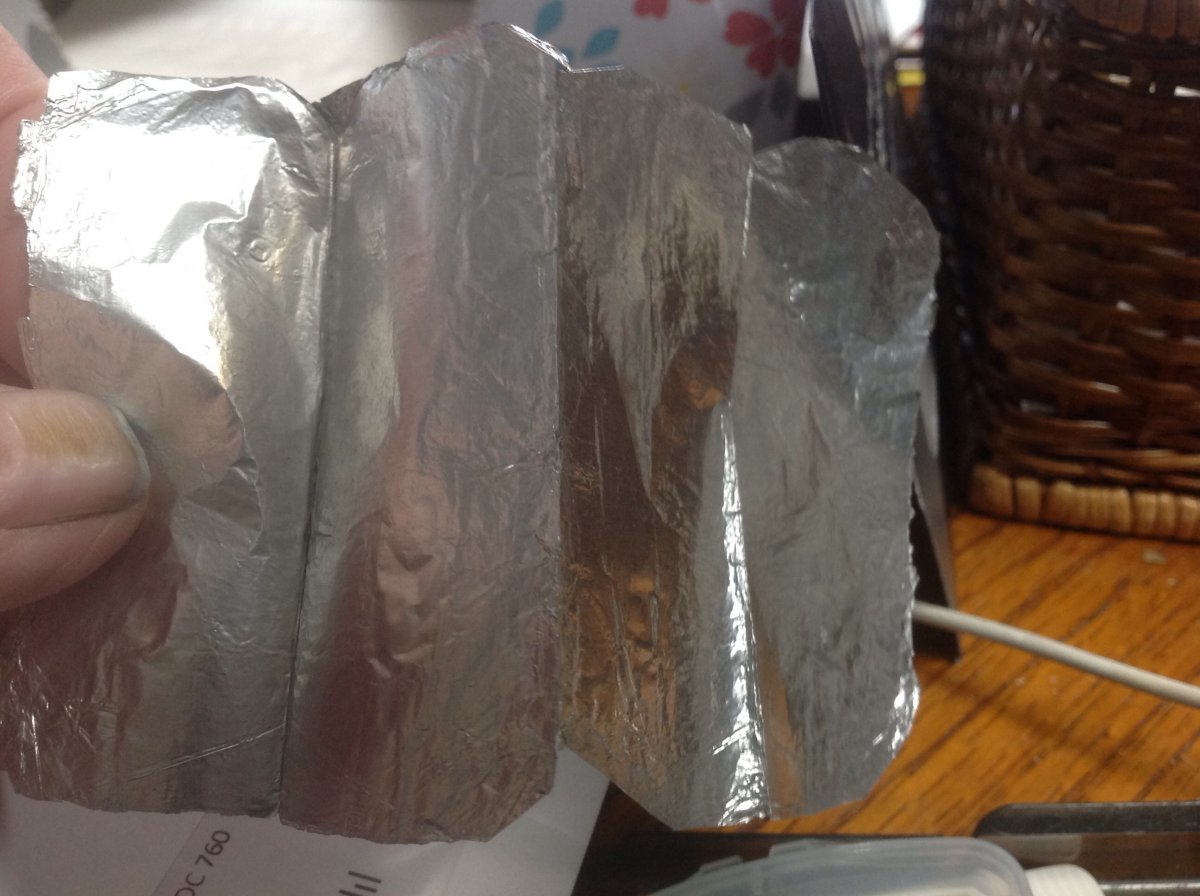

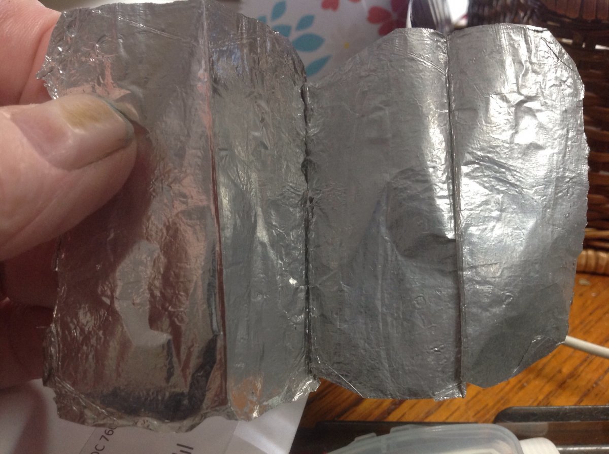

    image.jpg image.jpg Practice on box cutter blades welding the sharp edges together. And when you get good at that, get a piece of aluminum foil and tear it in half turn one side over so you have a shiney and a dull piece side by side and weld it together, you don't need any filler. This was done on my Lincoln 275 Square Wave Machine that's about 30 years old.

    Thanks 1-shot. I have a Lincoln 175 square wave tig. It is a hobby machine and is all automatic with no controls for wave balance and no pulse capability. The lowest output is 12 amps and with 0.020 tungsten. There is no way the arc is stable enough to weld razor blades or aluminum foil.
    I have been using it for 20 years and am a decent self taught welder with stick, mig, tig, oxy-act, etc. This welder does great **** welding auto body sheet metal. But that is still 0.030. It also does okay with 1/8 aluminum or so. Thicker alum it does not have the heat capability.
    I am looking to move up to a very good machine and want the capability to weld all the way from razor blades to aluminum cylinder heads.
    But don't know what the features are needed in a machine to do this.
    Suggestions?
