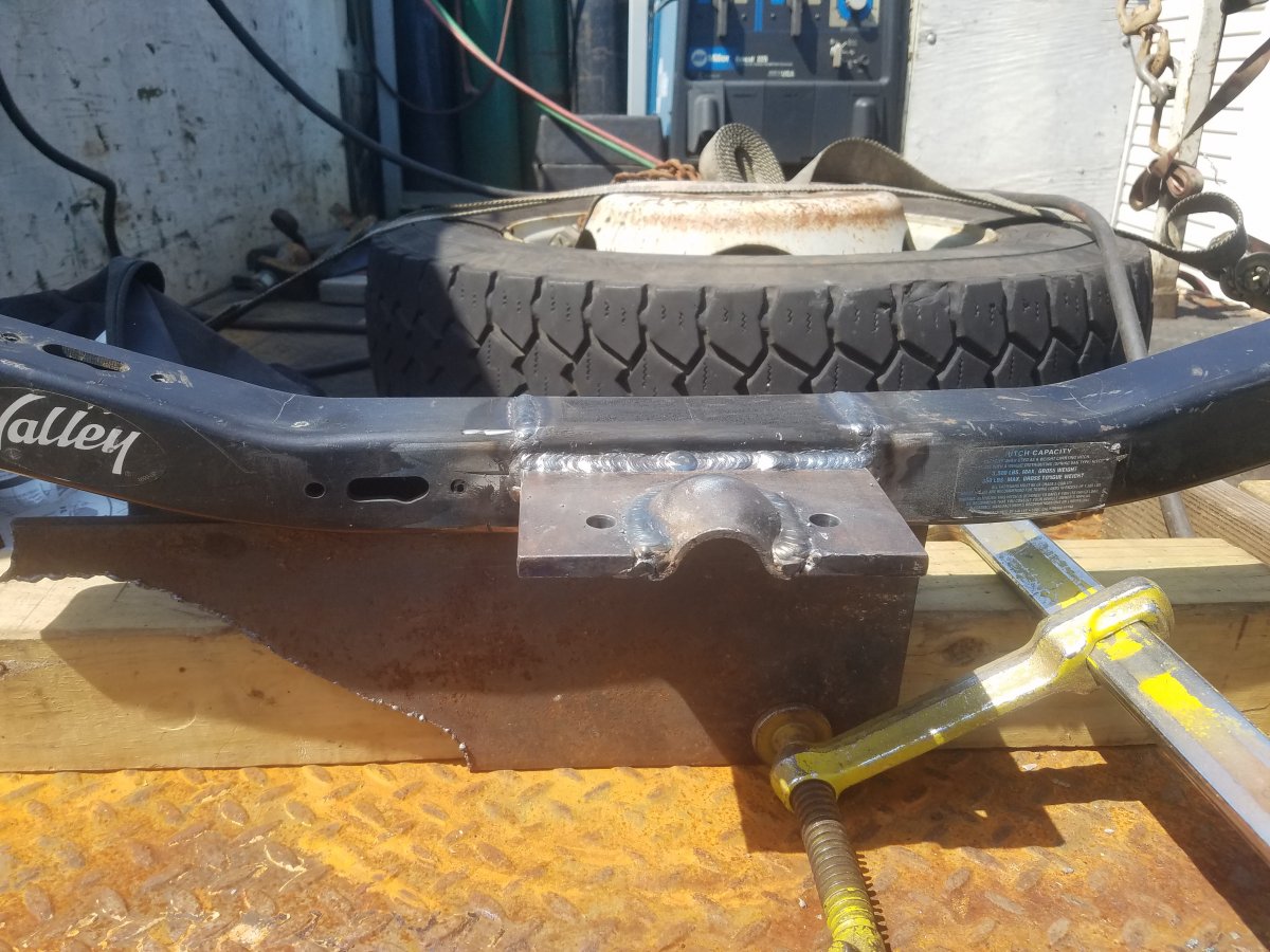

    Well I haven’t touched a welder in over 13+ years. Had to make a weld on a bracket for the motor home. Dusted off the Miller Thunderbolt A/C welder and grabbed my 13+ year old rods, that were laying in my tool box and went to work.Oddly enough since this weld a month or so ago , I’ve had to weld up two other projects! I guess it just primed the pump. Lol 3F824FF8-0ED4-4B6A-BD51-DA7EB7219762.jpeg

    Okay, this may be a good place to ask! I used my 13 year old Lincoln E-6013 welding rods and they worked great. But I ran out of my old stash and had to go buy a new box. I bought exactly the same rod! When I pulled the new rod out, I saw that the flux coating was smaller and a slightly different color.
    The new rods don’t weld like the old rods! I actually bought the box of new rods before I completely ran out of the old rods. The new rods were extremely difficult to get started. Since I had welds in some tough areas and some easy welds I alternated between the rods, using my old rods in the difficult areas! I overwhelmingly preferred my 13+ year old rods! Anyone else noticed this?
    Bones
  8. alanp561
    Joined: Oct 1, 2017
    Posts: 5,975
    alanp561
    Not trying to be a PITA or anything, but I wouldn't use E6013 if E6010 was available. I would only use that as a root p*** to burn through oxidation, paint or anything else that's attached itself to what you're welding and you can't s****e or brush off. Finish it off with E7018. Unless the rods were in a sealed can just prior to use, I especially wouldn't use a rod that has been exposed to the atmosphere for 13 years. Don't get me wrong, I broke in on a Lincoln AC buzz box with 6013 but when I learned about better machines and materials, that's where I went. My stick rod stays in a rod oven at 250 degrees until I need it and it doesn't stay out of the oven over 4 hours. I've seen a lot of pretty tig and mig welds done by folks on here. A lot of the welds could have been done with stick faster and still look nice enough to leave as they were without resorting to a grinder. My two examples are on a cross member that I built for the rear wishbones on my T. No one was ever going to see it but me. The only thing I was worried about was whether or not the welds I made were going to draw the cross member in a direction I didn't want it to go. I tacked the whole thing to a 1/2" thick strong back and brought the welds from the outside edges to the middle. There's exactly the right amount of weld on all the joints and after I removed the strong back, the cross member stayed in the shape it was supposed to be.

    I keep both my TIG & STICK rods in sealed rod holders so they don't oxidize or absorb moisture.

    I get that all the time from my B/I/L, he’s a professional welder and always accuses me of using junk rod. When I had to weld that bracket, I though I’d take a chance on that handful of rods I found in a tool box next to the welder. I truly figured an AC welder, 13 year old rods, no welding in 10 years, I figured I would have trouble! But, it looked like a pertty good weld for a guy with no real formal training.
    I ,too, learned on a Monkey Wards cracker box welder built by Lincoln and using 6013 Lincoln Fleet weld. Is it the best rod? It is for me. That weld in my picture, actually “ chipped it self! I knocked the slag off with my finger!
    I now have a Miller Bobcat AC/DC gas powered welder. But I still use the Lincoln 6013 Fleetweld37. It’s because I can get a pertty weld with it. I can and do use 7018 upon occasion, usually when I weld uphill, I use 6013 for down hill, I can control it better.
