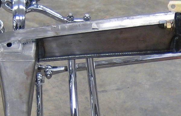

That's a mig weld... sometimes there's a bit of "dandruff" on the edge of the steel from the laser cutter. It's a few thou thick, and comes off easily, but sometimes I don't get it all.
