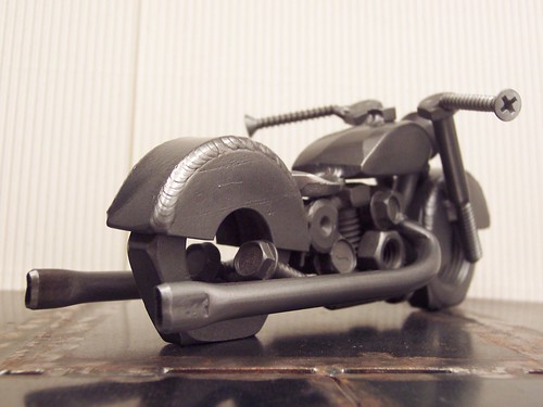

    I haven't done a heck of a lot of sheet metal stuff, but I looked through some of my models and there were a few decent examples:)
    I was really happy with the bike fender welds, even with the zinc cleaned of the washers are usually a pain in the **** to weld.
    -Josh

    What's going on with that burn trail?
    Is that from some weld on the other side?
