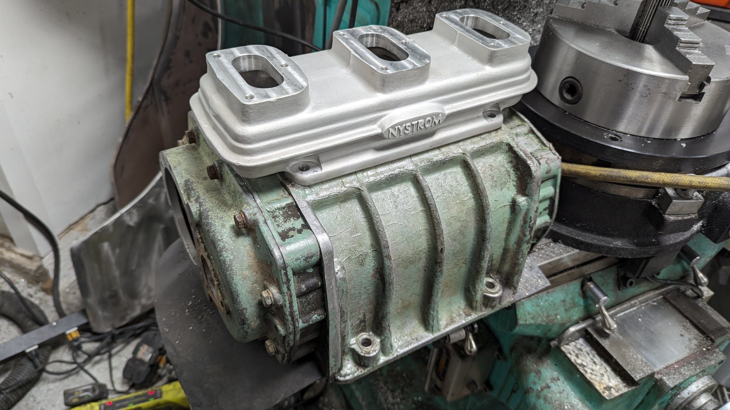

    I got this 4-71 for free.
    Getting it to this was, very emphatically, not free.
    Just getting it here was even farther from inexpensive.
    And it ain't done yet!

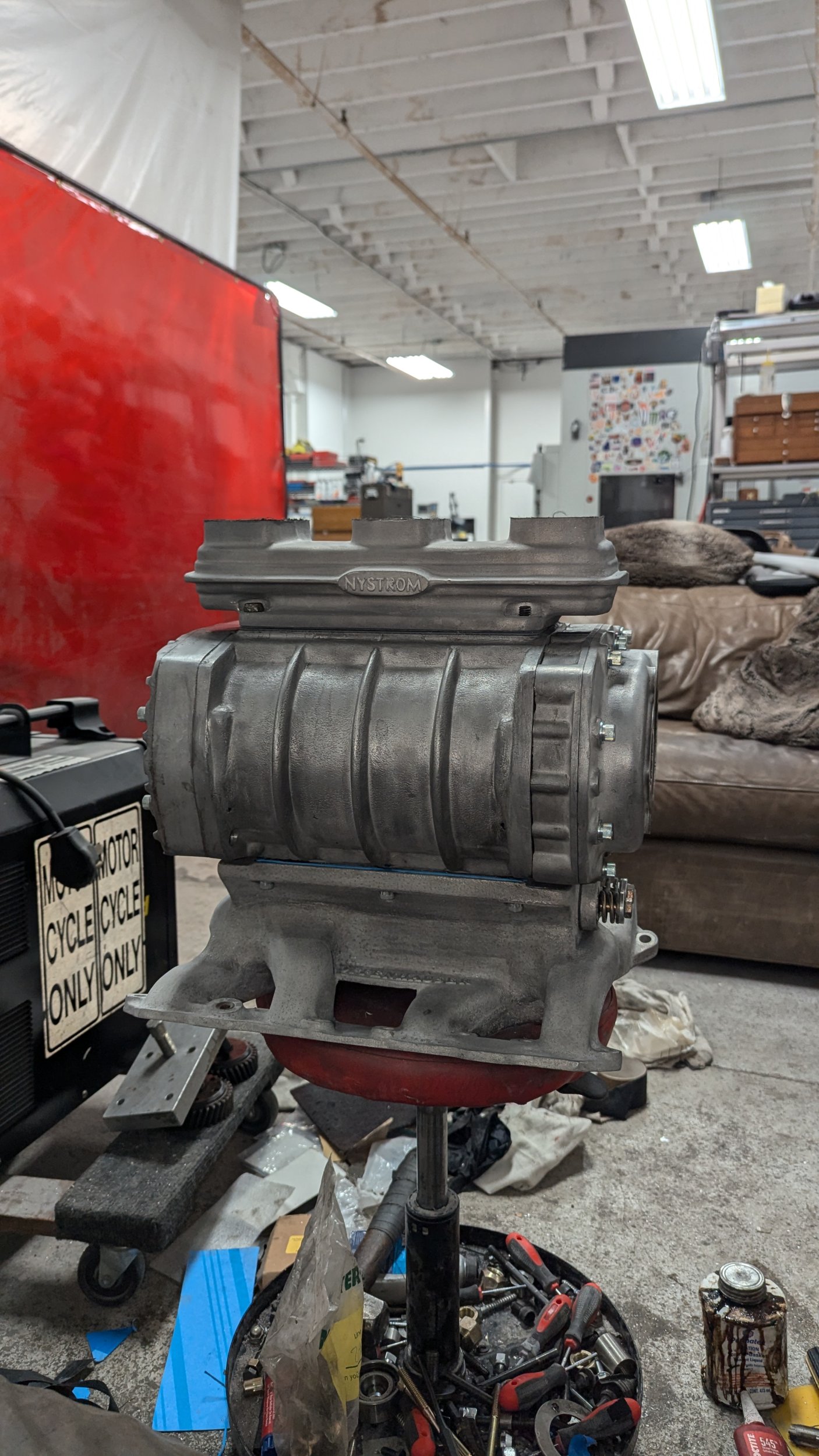

    Yeah I get that it's a dumb idea, and if it was easy and good everyone would be doing it. It's just something I want to try, and hell if I do it and make it badass I'll give the world a heads up.
    Also badass 4-71

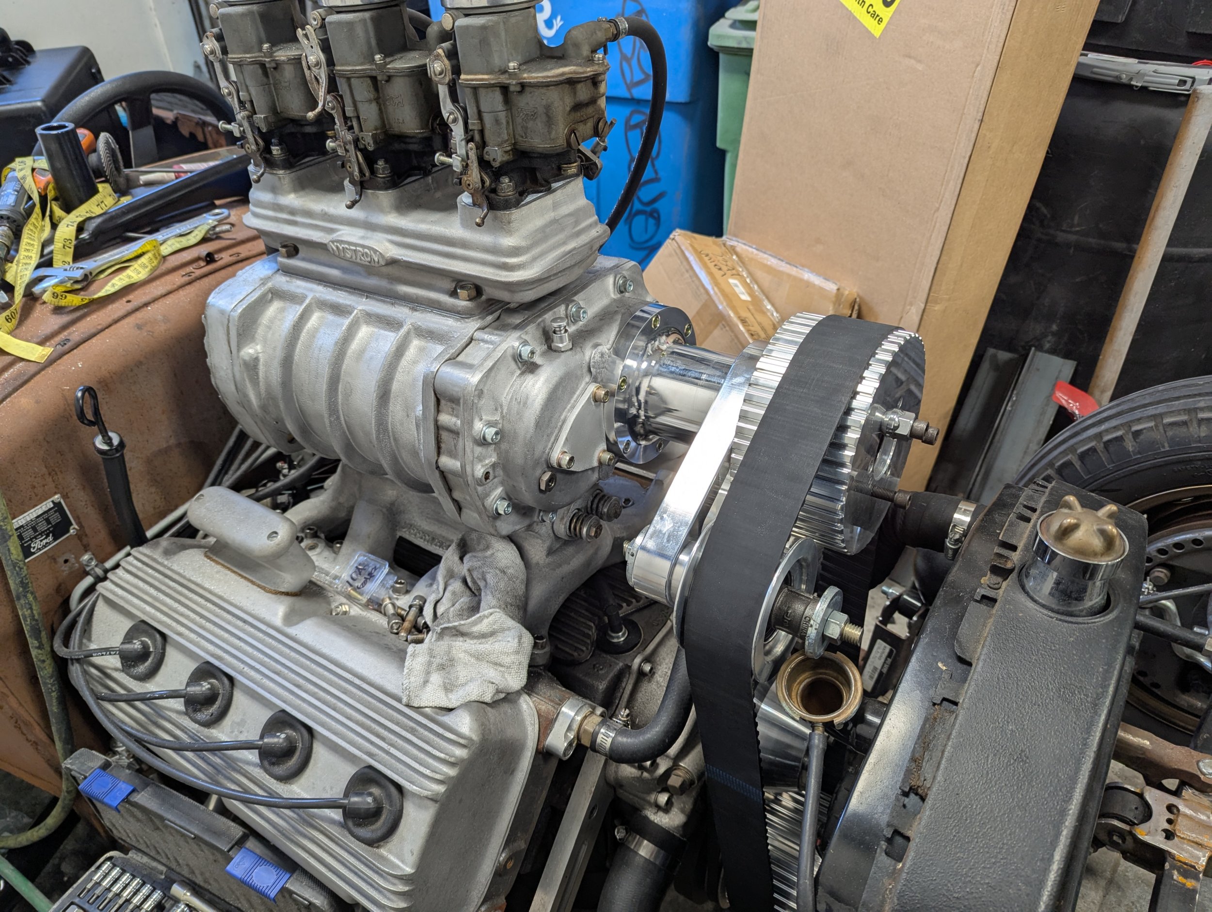

    An important thing to consider is that all blowers use some of the engine's power to run.
    Your setup, unless it is for the sound and show, would need to make enough power to offset what is required to run the blower. Not all combinations of parts will do this.
    The 4-71 that I built, shown above, is configured for net-zero power. It makes just enough boost to offset what it takes to run it, and little to no more.
    The customer wants the look, and the sound, but the car is already overpowered for what it is.
