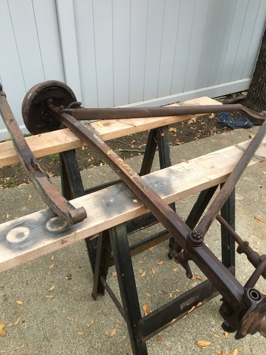

  5. Was a successful day at the swapmeet! Got a Fenton 3-speed shifter for the afore mentioned transmission, and a 31 Model A front end, all for the princely sum of $80.
    Won't be long I will either have to change the name of this thread or start a new one.
    Spindles on the front end are trash, but new ones can be had. Does anyone know if the spring perches for Model A are the same as for hydraulic Ford front ends? Like 32-later? I'm trying to decide if I want to cut up a good wishbone to make radius rods, which would be correct, or build wishbones, also correct.
    The axle is good, the spring is good, which is what I what I was really after anyway.
    The Fenton shifter, under all that gunk is pretty decent, and works great. A good cleaning, and we are golden!
    Still looking for steering and a rear end. I may hold off for an old Ford banjo just for the period look.

  8. I'm afraid my spindles are beyond repair. I'm soaking everything in PB Blaster before I get out the impact, but from what I see so far, the spindles and king pins have taken the hit, and the axle itself looks OK. I need one hub, not hard to find.
    I'm still trying to decide on a banjo rear end, or a 9". Since I'm not going to flog this thing, a banjo would have the "cool" factor. If I run across a quickchange housing, there will be no more debate.....
