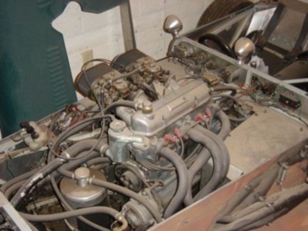

  11. Here's my 2000cc Pinto with twin 40's. I had them dialed in, then did some engine work, now I need to fatten them up some.

    Yes it does. More flow through one carb means more fuel vaporisation concentrated in one carb body. With two DCOEs they rarely get cold enough to ice up, but when you use one they do have a habit of icing up because of the increased flow through the single carb.

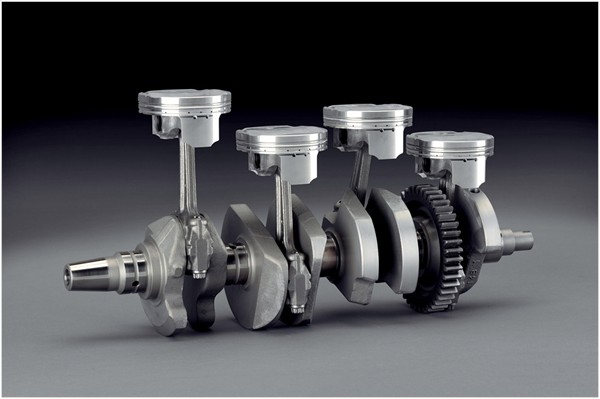

    The uneven firing order mimicks the power delivery of the 90° V4 with a 180° crank. "The idea of this technology is to reduce internal crankshaft torque, thus giving the new R1 a more linear power delivery." The idea was for the best of both worlds motorcycle wise "the low end torque of a twin and the pace of an inline four"

    Thanks Zman and Hotroddon.
    Those guys will try anything....:D :D
