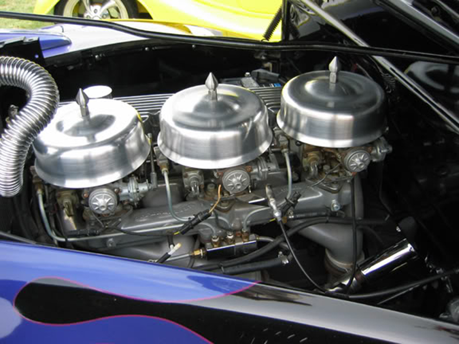

    Chevy Motor 2.jpg I have a warmed over 292 in my '40 Coupe. It's all I need for long distance driving and cruising. It's also a non "V" for the car show circuit. Very reliable if you don't abuse it! Ask me how I know.
    volvobrynk likes this.
