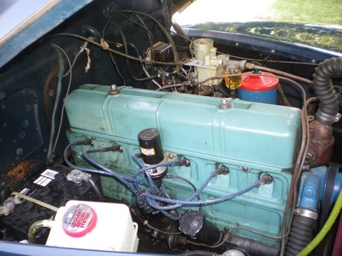

    Here is my '53 splasher (non-power-glide) and it has a cam, roller rockers and a dual point ignition system and it keeps up with the other cars. But it is hooked up to a T-5. I've been happy for the past 6 years.
    Normbc9

  28. Truckedup
    Joined: Jul 25, 2006
    Posts: 4,660
    Truckedup
    If you have the 3.55 PG gears the engine is about 2500 rpm at 60 mph with normal sized rear tires.
    The valve noise on a good solid lifter 235 is a vintage mechanical sound,not the clatter wheels of destruction :D
    Stock old cars are slow,be it a 53 Chevy,Ford or Mopar.But your set up should cruise along at 60mph with no problem even on moderate grades.
    Your description sounds like you have one sick engine.........
  29. 6-bangertim
    Joined: Oct 3, 2011
    Posts: 411
    6-bangertim
    Get a vacuum gauge to see how much vacuum you have at idle. It's an odd chance, but could be the cam is retarded - the punch marks on the cam and crank gears wasn't lined up, or the marks were off from the factory. Use the gauge to check fuel pump pressure also - NEW doesn't always mean its good!
    Zero in the Octane Selector with the pointer on the flywheel ball with #1 at TDC. Then set the O.S. to 8 degrees. Play with the timing - it should pick up some. Go back to points and condenser and stock coil, play with the timing some more.
    What specs did you use for valve lash? You could go maybe 3-4 thousands TIGHTER just for a test run - try the intakes first. How was the cam broke in and what oil and any additives (for extra ZDDP) used? Might want to pull a couple of lifters for a look-see at the faces and the cam - could be its gone flat.:mad: Cam timing on a stock cam is LAME at best, IMO. I could not recommend a rebuild without upgrading to a mild 3/4 grind, no bigger than 264 deg. advertised duration. IT REALLY WAKES THEM UP!!!:D
    How about vacuum leaks - carb to intake, intake to head, vacuum hose to wipers and wiper motor. Use a UNLIT propane torch to check - idle will pick up when found.
    Also try a cylinder balance test. Set the idle to 800 RPM, then pull one plug wire at a time - note the drop in rpm's. You shouldn't see more than a 50 rpm difference between cylinders on a fresh build.
    Are the brakes dragging or the clutch slipping? Do you have FULL THROTTLE with the foot-feed matted? Is the choke opening as it warms up?:eek:
    A couple of things I have to remind myself when troubleshooting:
    1) CHECK THE EASYIST, CHEAPEST THINGS FIRST.
    2) Make only ONE tuning change at a time.
    Don't give up on the 235 - HANG IN THERE!!!
    Good Luck, Tim
  30. The_Monster
    Joined: Sep 8, 2003
    Posts: 1,805
    The_Monster
    Shawn, thanks for the tips. I may put in some points to see if theres any difference.
    But the car runs and drives fine. Maybe I made it sound as if there was a performance problem I was having. But the only performance problem I have is the lack of it, haha!
    Theres no weird mystery stuff going on, I just would like a bit more Uumph from the motor. Sounds like guys that are getting that are installing a 2 carb set up and going with a 5 speeds and newer rear end.
    Im going to check out some sights on the conversion and look around the net for parting out cars.
    Dimebag, Sounds like your set up is just like mine minus the 2 carb set up. Yet youre pullin 60-65 at just over 2300 rpm. I dont get that :confused: If our set ups are the same, but you have 1 extra carb, how are your freeway runs less effort than mine? I mean, the extra carbs are for extra snap and the extra gears in a trany would be for better freeway drivin, but we both have the 3 speed. hummm:confused:
    truckedup, I hear what your sayin, and I have to admit the sounds are pretty cool. I just didnt image them being so obvious. I mean, if the car new sounded like this, I would probably take it back. Thing is, Ive never driven one of these older solid lifter motors with a moaning 3 speed. What I need to do is have someone that has been around them a bunch to drive my car and let me know if its normal or not.
    6bangertim, vacuum gauge sounds like a cool idea, Ill look into that. Dont remember the valve lash numbers right now. Motor and cam was broke in for 30 minutes ranging between 2000-2500rpm. Brad Penn break in oil (green oil) was used. Brad Penn has excessive amounts of zinc in their oil. Ive used Brad Penn 30 weight since then. Changed it right after break in, then at 50 mi, 100 mi, 500 mi and next will be 1000 mi. Thought about a hairier grind cam, but went with a stock grind so I cound experience what it was like in the day.
    carb to intake good, intake to head good, no vacuum wipers.
    Ill try the cylinder balance test for fun to see what I get.
    I installed new brakes and new clutch pack and both are cool. Yes on the full throttle at the petal, and yes on the opening choke on warm up.
    Great list of checks!! Im going to drive it on the freeway in the next couple days and write down the performance and stats. This way I can compair my finding to what everyone has said on here so far. And Ill be able to refer to them when I make changes or upgrades.
    Thanks to everyone so far for your input and advice, its really appreciated!
