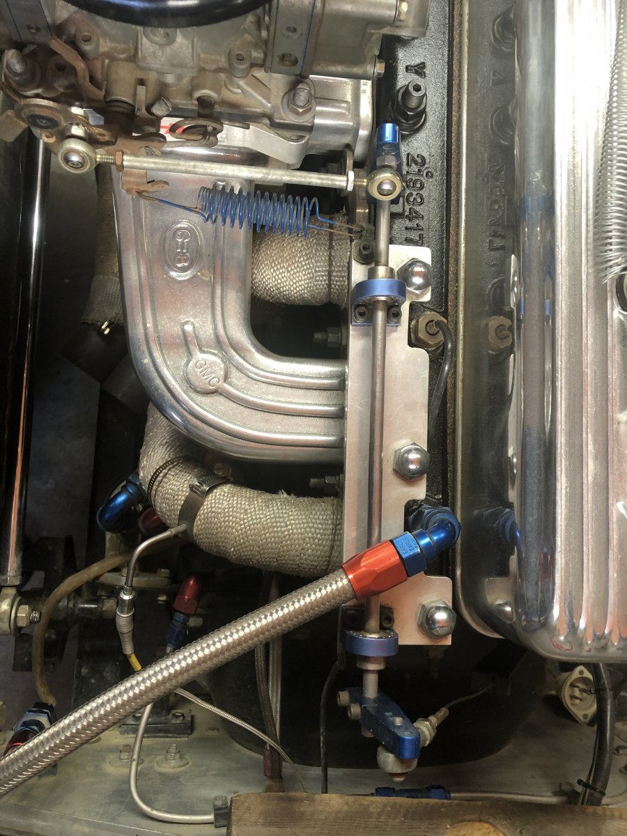

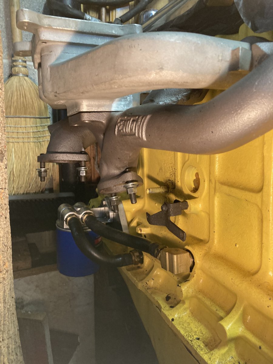

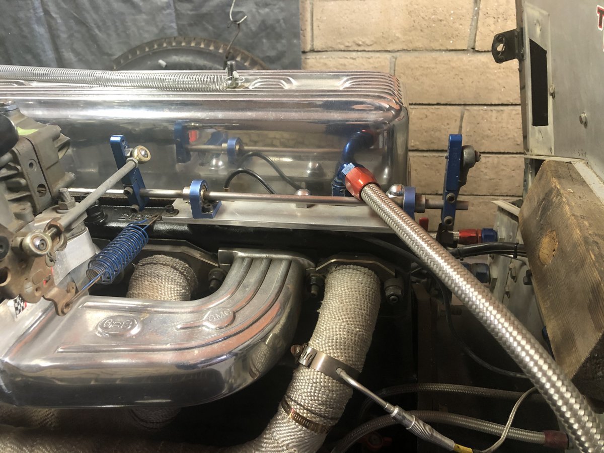

    Mine carb is mounted sideways. It’s a race car so a cable was used. Stock linkage style could be mad me to work from the bell crank mounted on the block but it going to take some thought and an another adjustable bell crank mounted vertically. Mr. Gasket sell one #1523 but your going to make brackets that mount either to the head studs or intake/exhaust studs. You may want to slip insulation sleeves over your oil lines. I use the red ones that don’t hold water and use heat shrink over the ends.
    Other than the aluminum mounting plate and the longer head studs from ARP my shaft and arms are from Kinsler Fuel Injection which sell lots of parts. My cable is at the rear of the engine. 27F5852C-46F8-4450-B419-0B14EDA4A62C.jpeg 4D3ACB86-0D40-4038-A75D-222F0A637567.jpeg

    Jimmy 6, I’ve seen your set-up before, looks solid. If you could, a picture or description of pedal to flexible line if you can.
