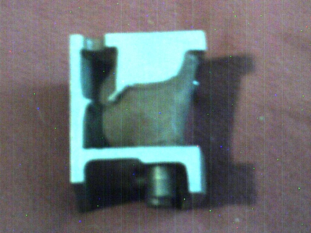

    Have him machine two round ports were the original one is.
    Q: Which new port goes through the water jacket?
    A: Both of them
    Q: What happens to the original port?
    A: ...................................what?
    Save time & trouble: lay the block on the floor, and drive a fork lift at it very fast. Same result, less work.

    oh- and a destroked 230 is a 218!! A destroked and sleeved down 230 is a 201!!
    and, here's a (bad) pic of intake ports cutaway. You can clearly see that making that one port into two would require much more than just grinding the hole out bigger.
