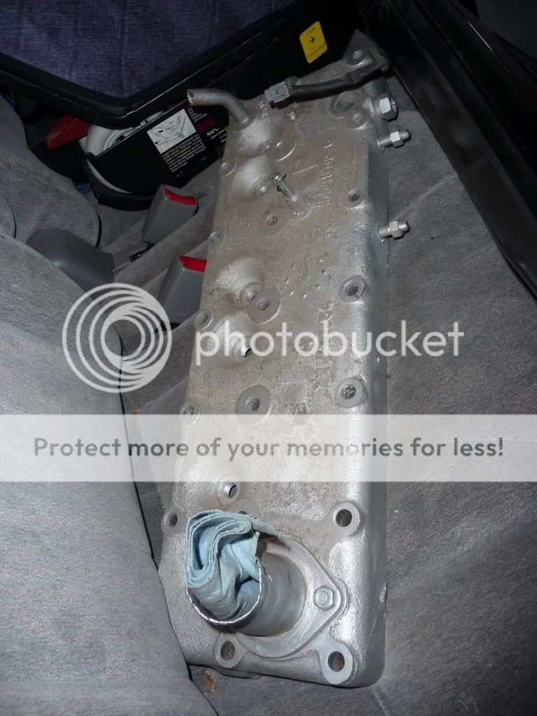

    The head, and pay no attention to the 01' toyota MR2 spyder trunklid:rolleyes:
    Basically cleaned it inside and out, and painted it with high temp paint "hindsight is 20/20 so get offa my back" the coolant neck was eaten through in some places so I fixed it with some JB weld, lets see that get eaten through. I also ran a tap through all of the plug holes slowly to make sure there was no crud and the holes would accept the plugs, when I put them in. I think that I did this about a year ago when I first got the car, and in my humble opinion, I did a pretty bang up job for a novice.:cool:
    I straight edged the head to make sure the mating surface was true, and that there was no warping etc. and also cleaned all of the old carbon/lead deposits from the combustion area.

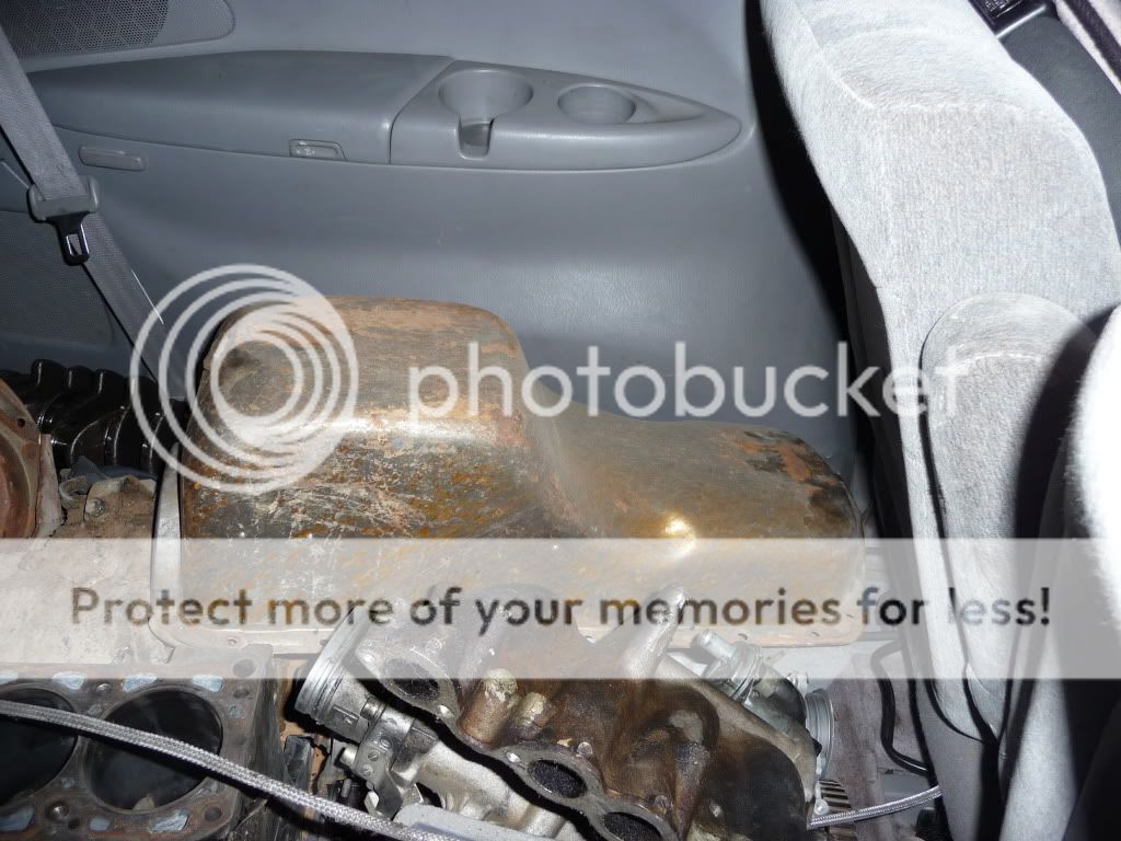

    oil pan and various other things
