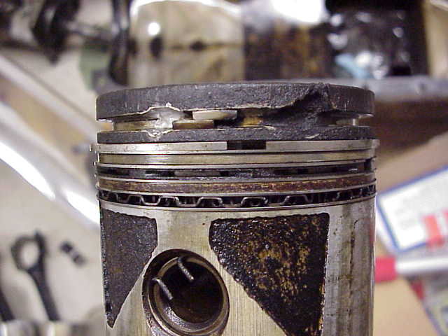

    One of the problems with the 230 engines is that the pistons - notably the ring lands - are weak. The top ring land starts to widen from the pounding of the top ring, and the gap gets larger and larger. Eventually the land and/or ring breaks, and voila!, another cooked stock motor.
    Picture I shamelessly downloaded from blue skies:
    I have tried to find out if modern replacement pistons are made out of a better alloy. The stock aluminum pistons from back in the day were during the early days of alloy slugs (some manufacturers were still using cast iron pistons), so it is not surprising that there were problems. Does anyone know if modern 230 replacement pistons have solved this problem?
    In any event, if not, then a blower - even a low boost blower - could exacerbate the problem. And you still have chicken bone connecting rods, a four bearing crank, and iffy lower end lubrication. Unfortunatly, from a hop-up perspective, these motors do present some challenges.

    LOL, now that nintendokid has vanished, no doubt to research the likely hood of using Hemi heads on 4 cyl. Willys engines (it worked with plastic model car kits, why not?) or is still trying to bury that Plymouth in the desert, a real question!:D
    My old '41 Chrysler with it's Spitfire 6 ate a couple of pistons in this exact way! Being a semi employed college student at the time, with a wife and new baby, I sourced my favorite parts place, "JC Whitney", and ordered a set of pistons and rings for the closest thing they listed, which was later Dodge truck engines. Happily, the local vocational school machine shop was able to bore the Chrysler block out 1/8", the new slugs could be used, and my old Chrysler felt like a Roadrunner! (OK, not really, that Fluid Drive was sorta mushy)
    We drove the car a lot after that, and had no problems.
    See, we keep learning from this thread after all!:rolleyes:

    Were the truck pistons for the 250 inch engine?
    More importantly, were they stronger?
  25. flynbrian48
    Joined: Mar 10, 2008
    Posts: 8,757
    flynbrian48
    Yes, standard bore 250 Dodge truck. Plenty of meat in the Chrysler block, as they're the same. As far as strength goes, you're guess is a good as mine, but they didn't break out the ring lands while we had it! It pulled like a freight train on steroids, Fluid Drive or not.
