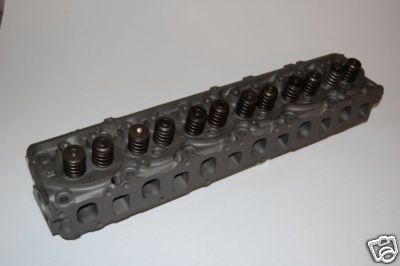

  25. Anderson makes a billet head for the 300 six. I cant believe some of the stuff i read here. All the guy wanted to do was built a hot 223. Then we come up with some cocomani idea that an inline has some special characterstic that gives it extra torque . A motor is a collection of single cylinders who dont know or care what the one next door is doing. The record for HP per cubic inch normally aspirated was set in the 1930s and has never been beat. It wasnt made with a small block Chevy, I am sorry to say it wasnt even a Chrylser hemi. The argument went to the black art of torque but not HP. Then in come the French (chevrolet ) guys with their little russian engine(Duntov), mouths wide open with that song we have all heard too long "The Small Block Chev is the cheapest bla bla" Excuse me a minute. I gotta puke. Obviously the V8 guys have never built a 6 or they wouldn,t talk so foolish. Sixes are fun. They work far better than one would think. They require thought and carefiul tuning. Sometimes you even get to make stuff with your hands. That is what hotrodding used to be about. And then we get into the brand argument. Here is a news flash. Mopar guys do Mopar sixes. Ford guys do Ford sixes. Chevy guys do Chevy sixes. That shouldnt surprise anyone. Why cant help on his choosen build be offered instead a fight breaking out???????????
