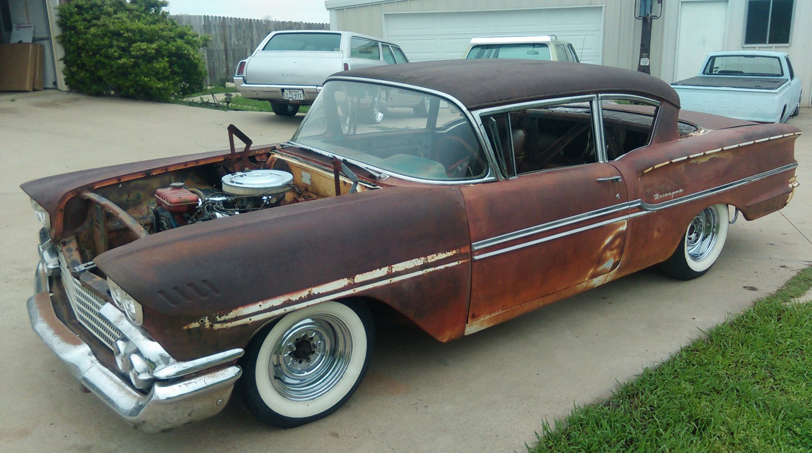

    THIS was worth the wait! Tell us more.
    When I was a kid (mid-'60s) there was a Biscayne coupe in my neighborhood that looked like your typical street racer - gold, no front bumper, radiused rear wheelwells, big 'n' littles (but jacked up a bit in front so it sat evenly). The thing I remember most was it had a set of '59 Pontiac Catalina taillights - IIRC they were pretty much a drill-and-bolt-'em fit and looked real good.
  12. mcnally351
    Joined: Apr 12, 2011
    Posts: 448
    mcnally351
    from boston

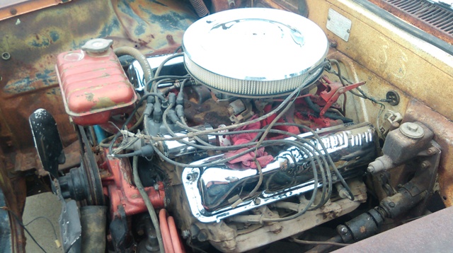

    Awesome. Great work. I love that it's ford powered. I don't like mixing up drivetrains but you never see a ford in a chevy.

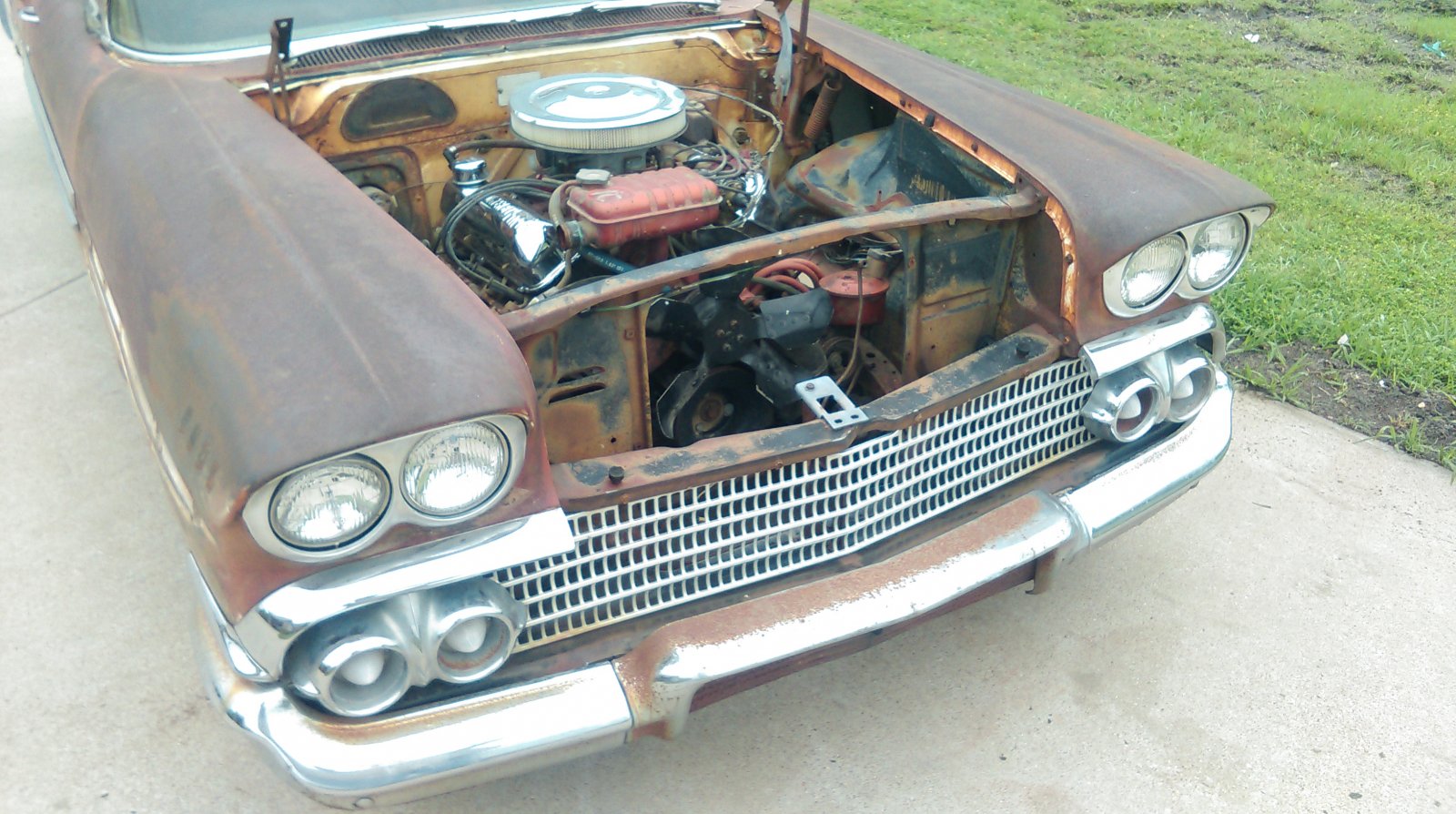

    Love the technical how to, did this for years when I worked in the trade full time and understand everything and why it was done. Love the concept of the FE in the Chevie :p. I can imagine all the comments when you pull up and pop the hood and see a rear sump Ford there.
  16. I was on the last page, watching the dates, thinking it'd be a dead thread with nothing for the last few years, so was nicely surprised to see the car on wheels, with the FE in it.
    This is great! I love the Ford in a Chevy thing, I'm sure this will be a fun car.
    I'll need to keep an eye on this, keen to see it finished.

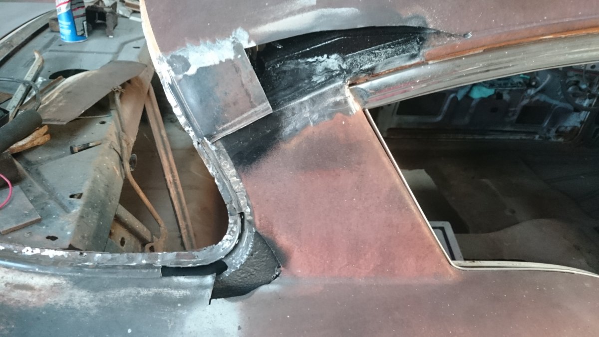

    Just have a million thing going, but trying to get back on this a little bit at least for a while...
    This area is way more involved than it looks as it's about 4/5 separate pieces needed to be formed, as it was completely ate through, and still not finished yet... DSC05328.JPG DSC_1805.JPG DSC_1825.JPG

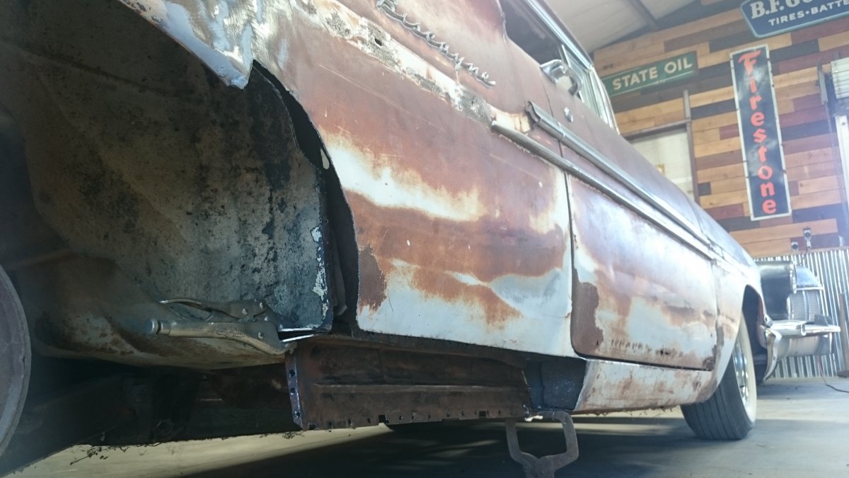

    The floors were 50/50 patch or replace all of them so by now you know which way I'm leaning....
    From my understanding no one produces full floors for a 58?? I know they are available for every other year Chevy, some one correct me if I'm wrong on that.
    Did get the right rear corner welded in and the full rocker.
    As it sits now.

    how did you do the rocker? was the inner rocker still good? also, maybe a 59/60 pan would fit with some cutting but not sure
  29. Insane 1
    Joined: Feb 13, 2005
    Posts: 974
    Insane 1
    from Ennis TX
    Pics don't show it but yes, I removed the complete p***. outer rocker all the way down including the rocker area of the 4 door piece, as the inner was still good. Welded all the way across the top and spot welded the bottom as factory.
    I have read about a few guys asking the question if a 59 pan could be used, but the only thing I have read is that the seat area is a little different?? With as many 58's guys are building, especially Impalas, you would think someone would make a complete pan.
