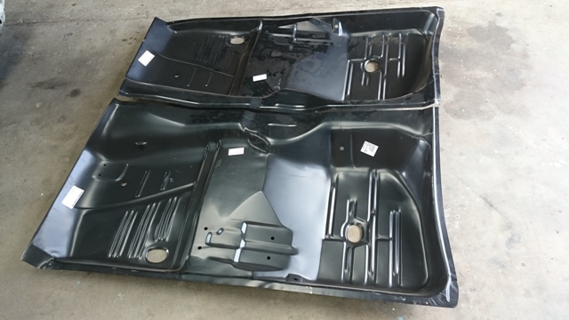

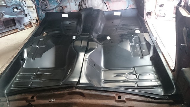

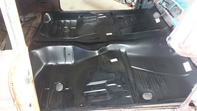

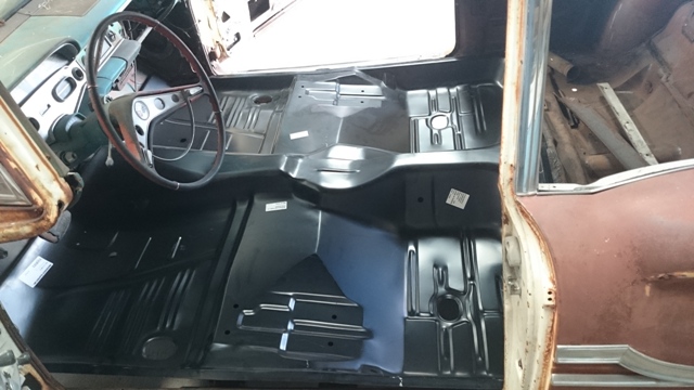

    Ok decided that no one knows how 64 floors are going to fit into a 58, so there is only one way to find out..... so here I go!
    Bought the 2 piece since I figured I would have to make some mods, or build a new trans tunnel for the Ford trans anyway, but to my surprise the trans looks to clear for the most part. Just laying the floors in it's not too far off other that the toe board, but I knew that going in. so with a bit of t******* got that out of the way. Still going to have to nip and tuck, here and there but they will work.
    Will have to use the 64 bracing which I figured would be the case, but it actually will work better than the 58 as it gives more clearance over the tail of the ******. So for now the floors are laying in place till I get the bracing. Will follow up soon......

    Wow that actually fits a lot better than i thought it would. I guess i always figured that the 58 was a lot narrower inside than the 59-64.

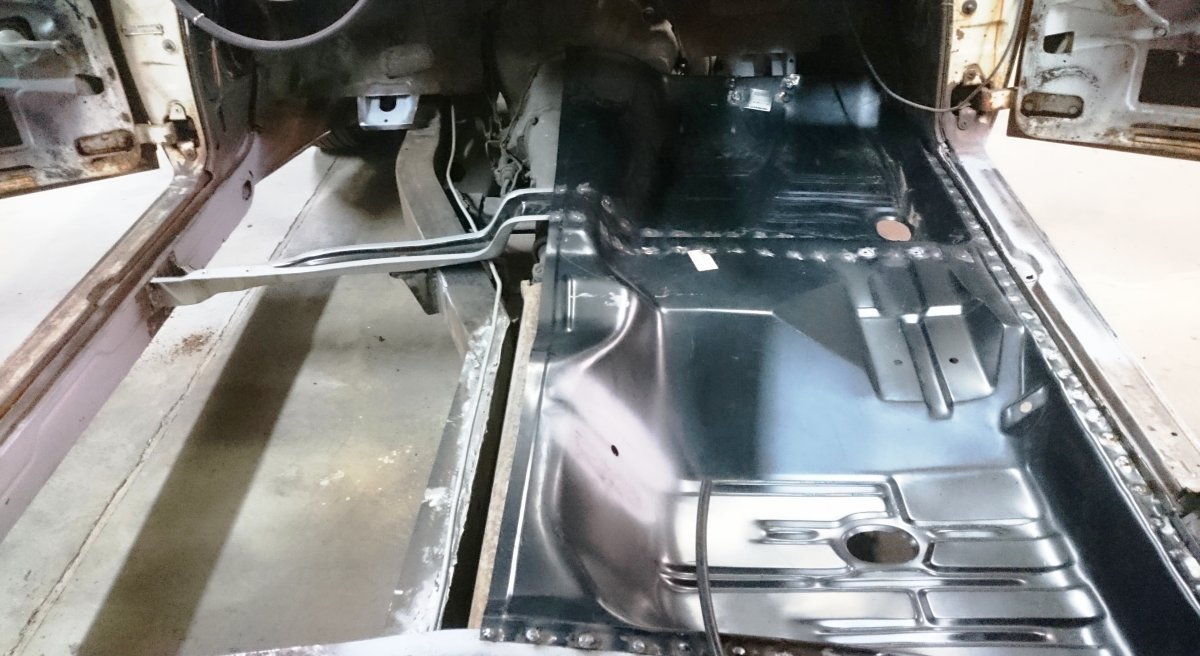

  13. Insane 1
    Joined: Feb 13, 2005
    Posts: 974
    Insane 1
    from Ennis TX
    The 64 front x-member came in so got it installed, had the move the two mounts, but not a bad fit otherwise. Got both floors welded in today, still have a little to do at the toe boards. DSC_6067.JPG

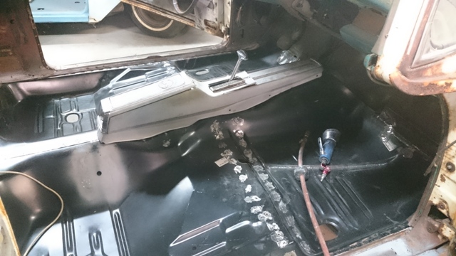

  17. Insane 1
    Posts: 974
    Insane 1
    from Ennis TX
    Thanks.
    Got the 64 shifter mounted today and built a new linkage rod to connect to the Ford trans. The console is just sitting in place.
