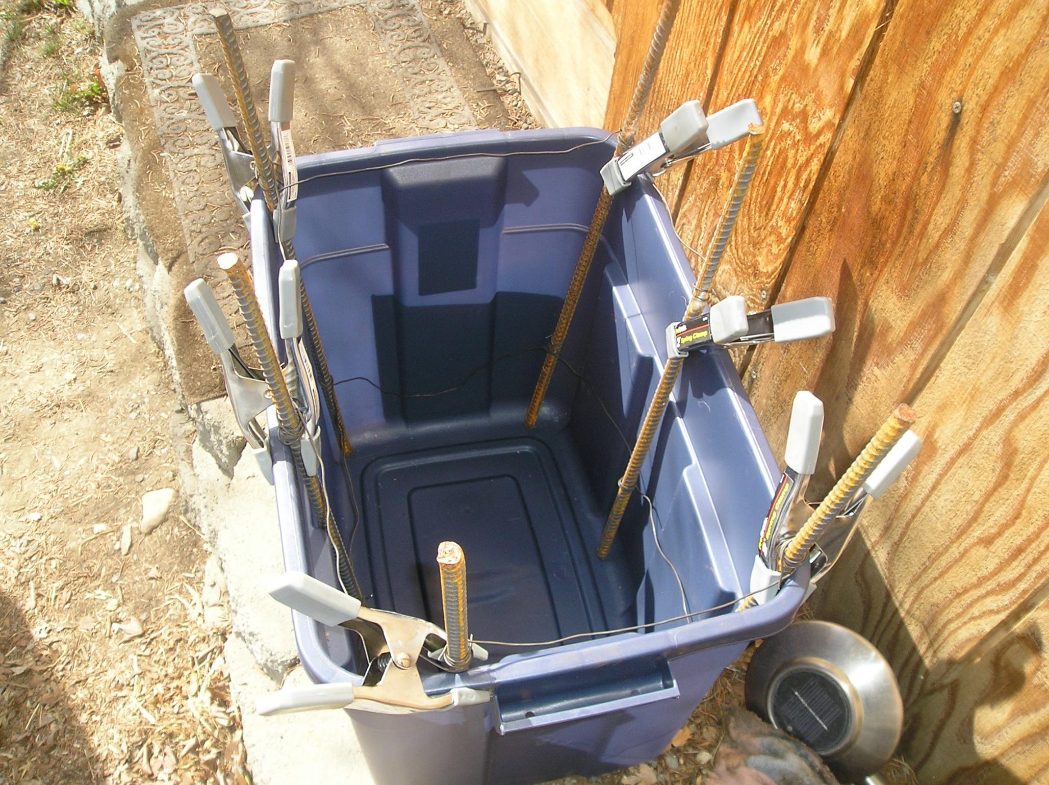

    That "industrial vinegar" is Acetic Acid and you can buy it at a camera supply store since they use it in film developing, BUT it is like 5 times strength of store bought vinegar so it absolutely needs mixed down with water. Good luck.

    Ha ha! Thanks for the lead! I just got back in from looking to see who has the best price on regular vinegar locally, and if you have a Smart and Final store near you it will set you back just 2.04 gallon. We don't have a pickling season down here so I doubt that price will ever fluctuate 'round these parts.
    I have a large camera store right down the street, so I'll darken their door on Monday and see what I can out about the industrial stuff.
    The other process I have seen involves mol***es, which I'm told can be bought in five gallon quan***ies at animal feed stores, but being a downtown boy in huge town I have to drive at least 25 miles to find a feed store...

    need louvers I live in a small town that has a feed mill they sell mol***es by the pound, i got about 2 1/2 gals. for less than 3bucks then you dilute that 5/1 may be cheaper and dose the same. Sorry for the jump in op4 just trying to be helpful. And i'm liking your build keep up the good work, the third light makes good sense, they drive like ***holes around here also, you'll at least be able to get up to speed with the 283 i'm still running a banger and they scare the hell out of me jack

    Do you dilute your vinigar mixture?

    Just ran across this thread, great work Joe. I enjoy seeing good metal work done without the high dollar equipment. I think hand tools, some time, and a little ingenuity is where its at for most of the builders on this board.
    Just throwing this out there on the rust removal.. I've been using electrolysis and have had some really good results. In fact, as soon as my shop is finished I plan to build another large enough for panels. Its quick and clean.
    keep the updates coming!

    I used the vinegar at full strength .
